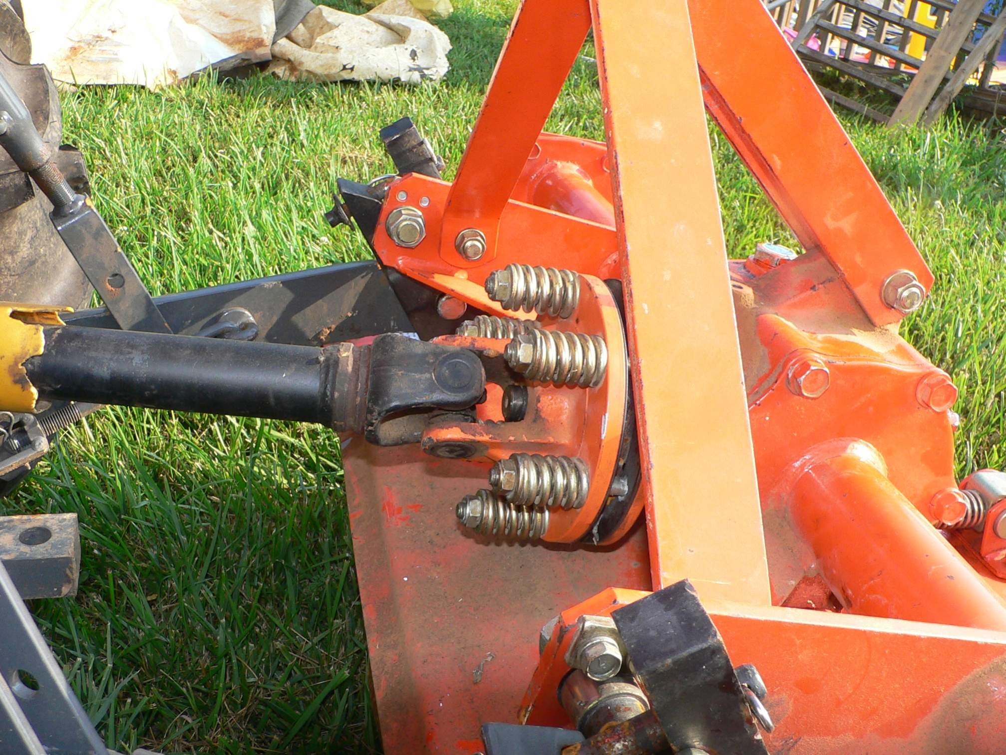

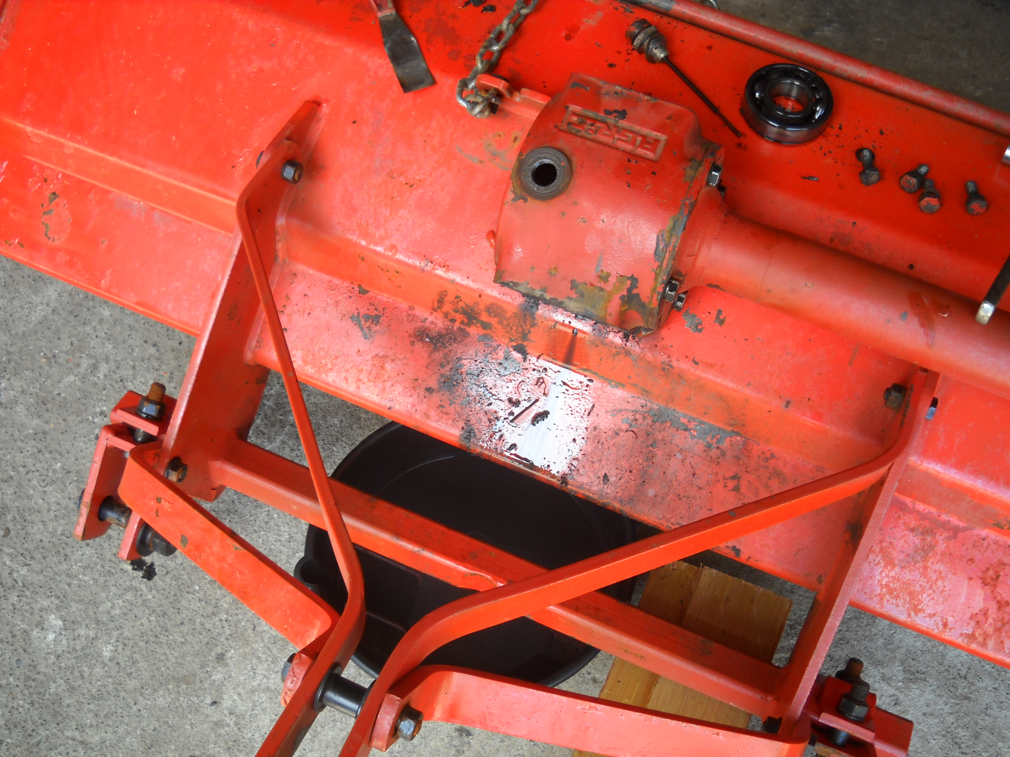

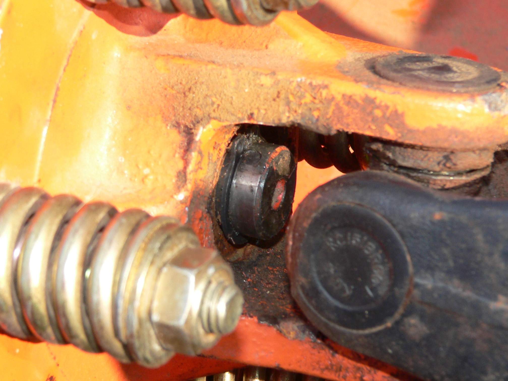

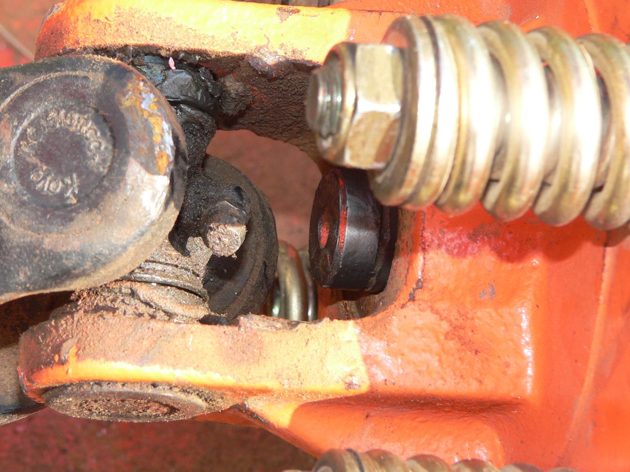

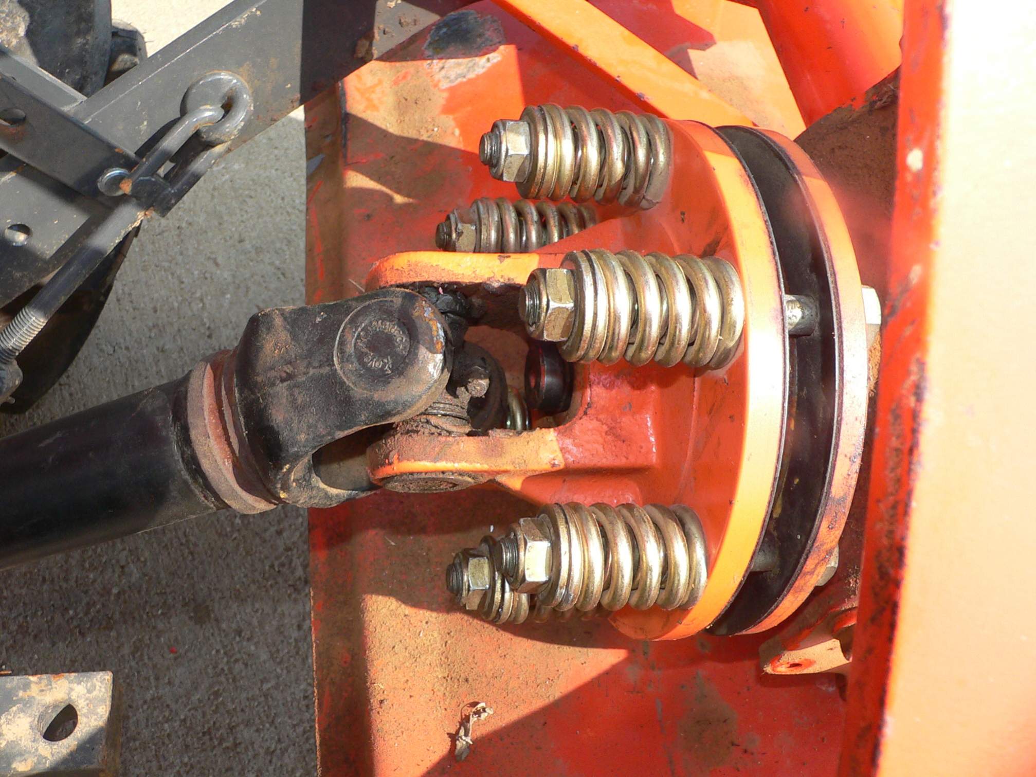

Said I would report back when I fixed tiller. Reporting back, tiller fixed. I did take chain guard cover off and nothing wrong there. Was removing 4 bolts on the back of the top gear box when I decided to remove the cover over the area behind clutch, The shaft was not back into gear box. Tryed pushing the shaft back with no success. Then tried my persuader (light sledge hammer) and it slid back easy on the spline and then I saw there was a slot for a retaining clip to hold the shaft in place but no clip.
Stopped at Barlows and got a clip which happened to be in stock and Steve Barlow told Gary no charge.
Got clip on this afternoon.
I'm going to be ready to till this fall now or spring.

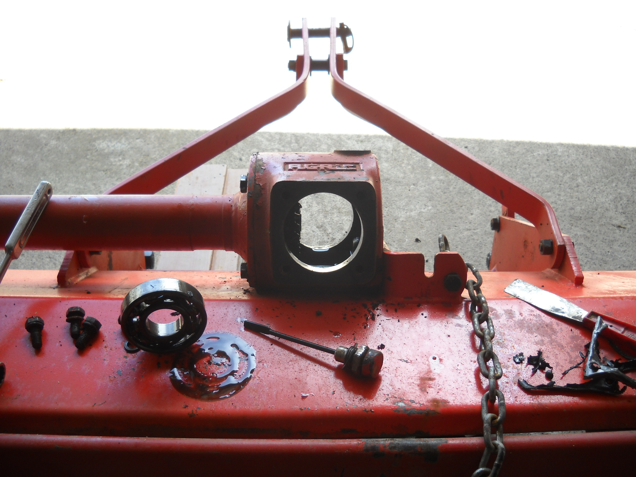

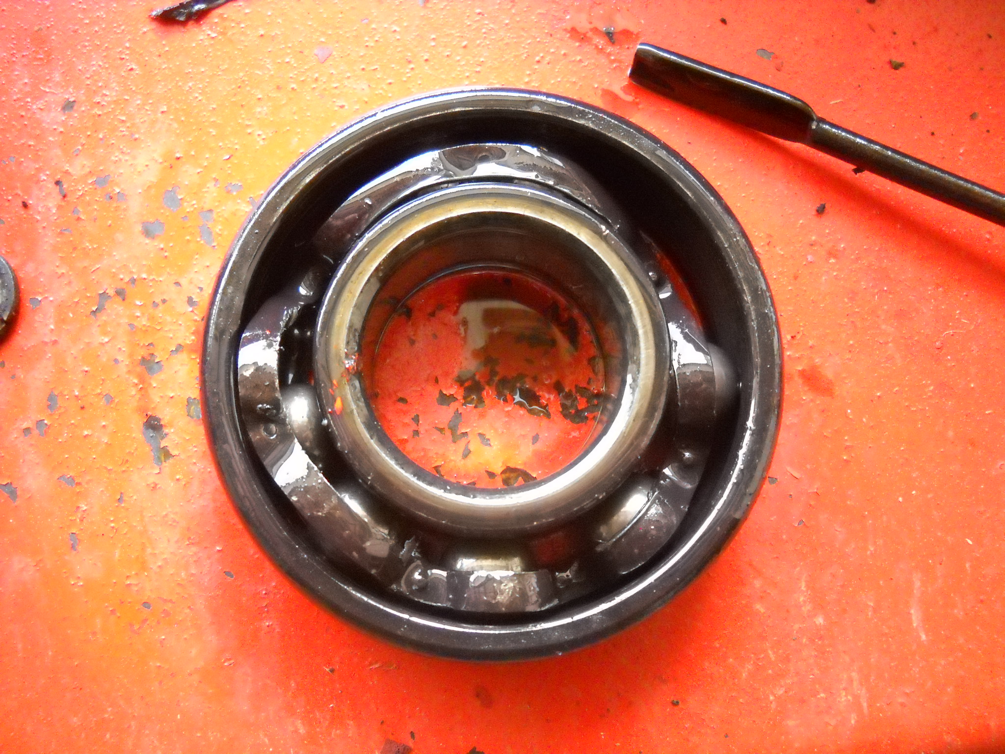

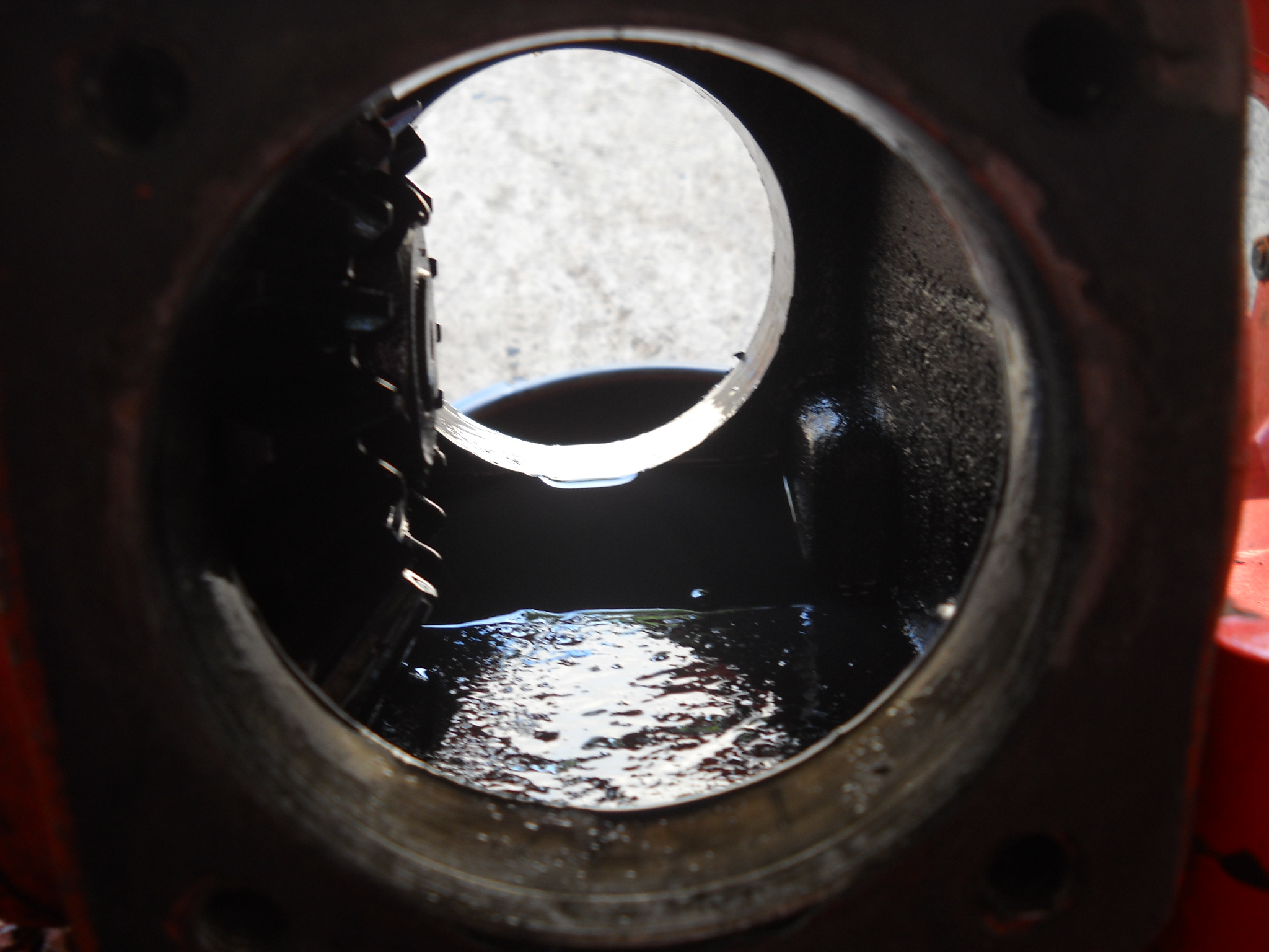

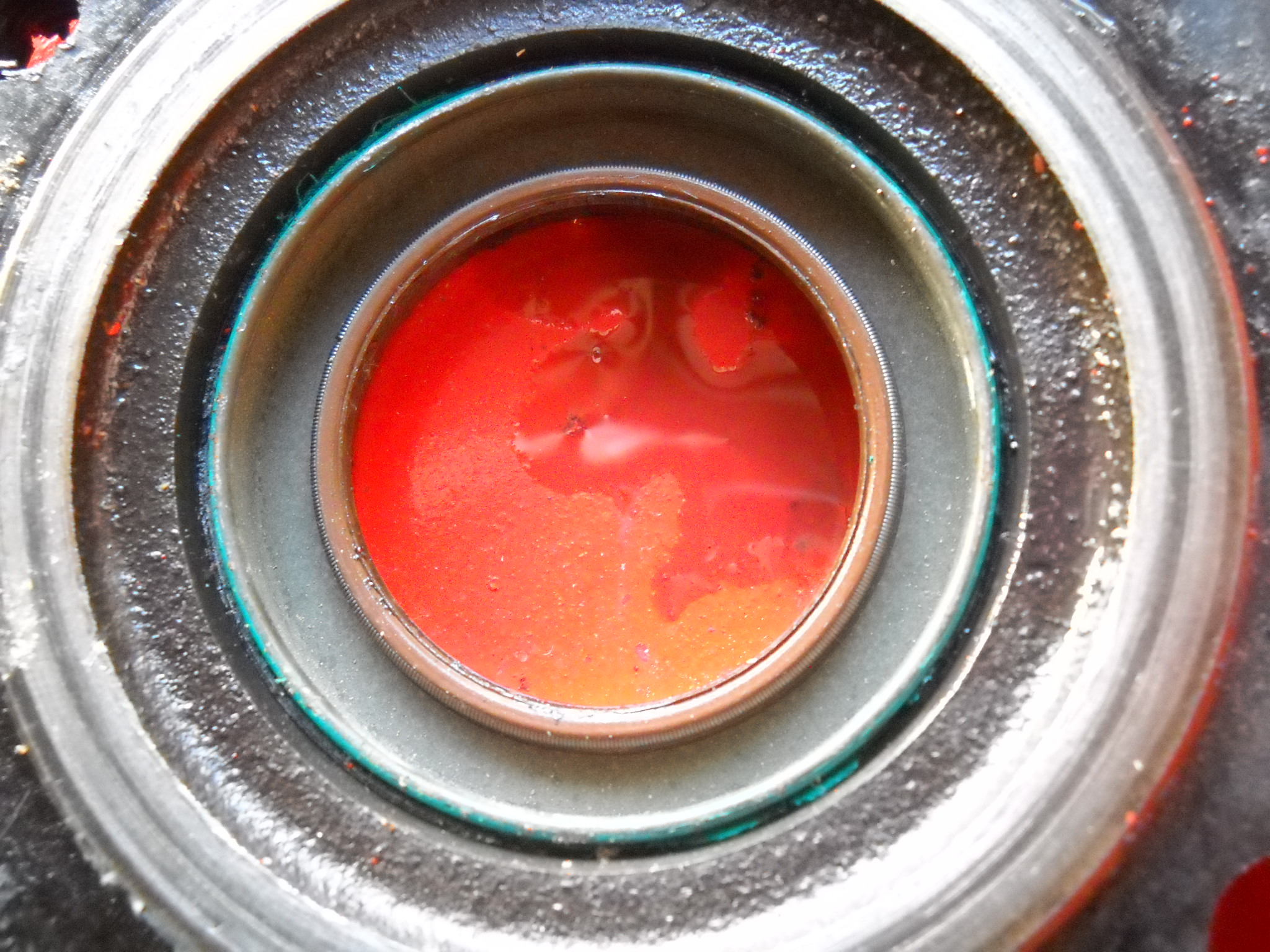

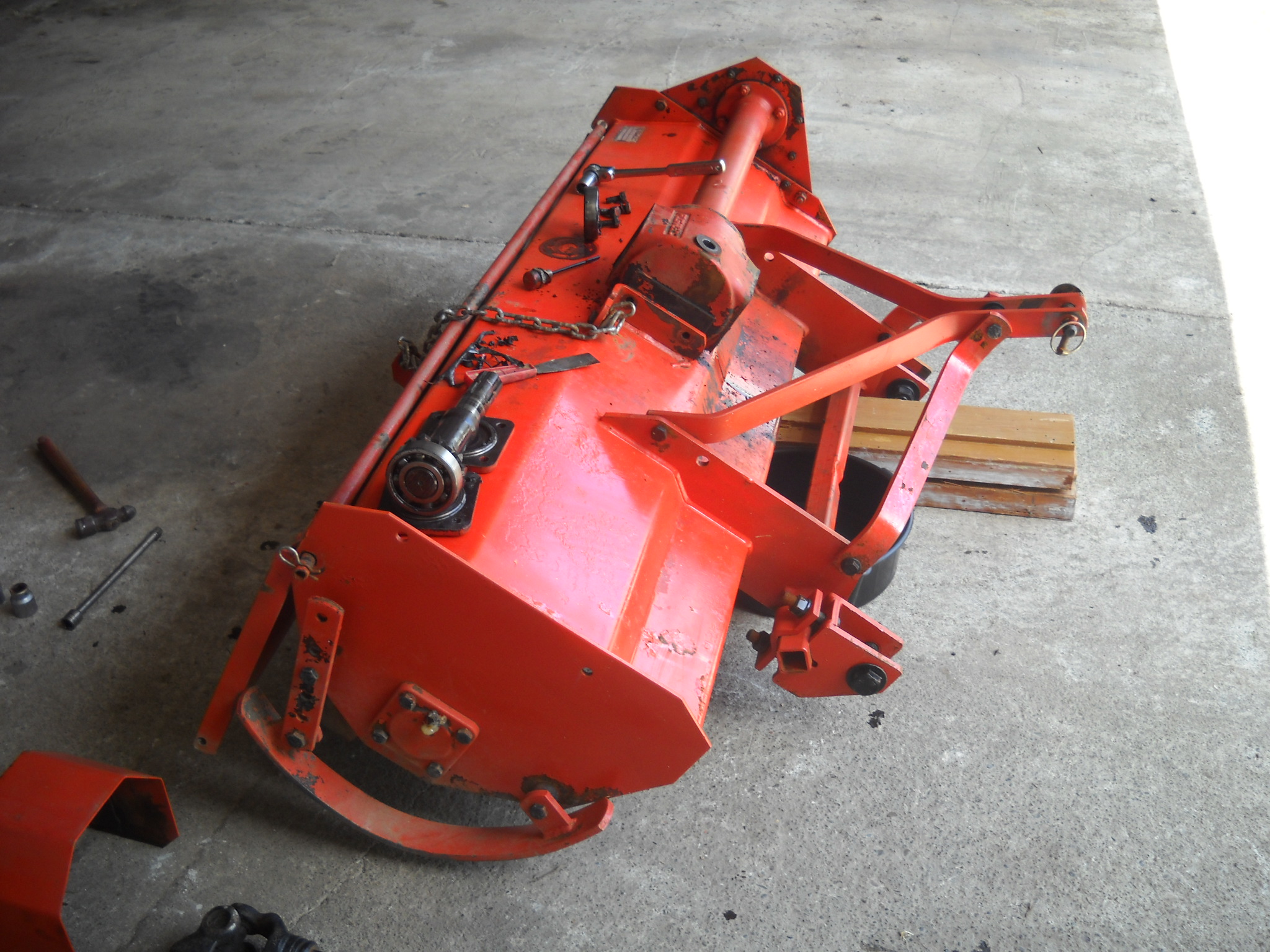

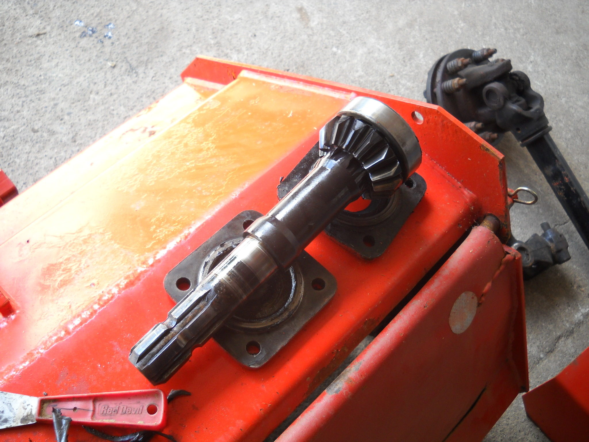

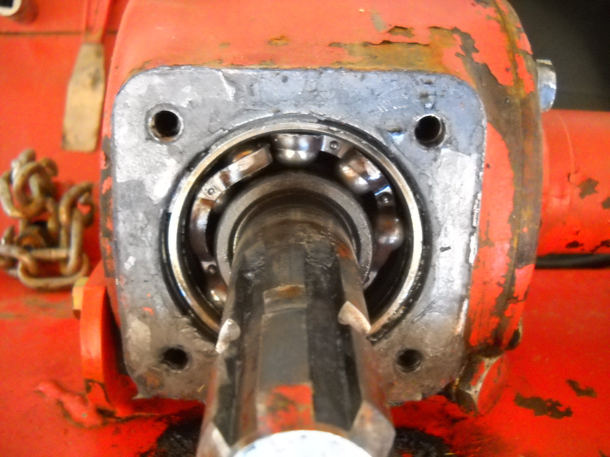

Glad it was an easy fix for you. I also repaired my tiller back on Saturday. I had a seal go out when i was tilling my uncles yard and soon to follow I heard metal grinding. :(:ashamed: So I finished it all up and finally cracked open the gear box. Found out the seal was bad, not a surprise, it held up well since it went through a bran fire, it did pretty good holding up for 2 more years after that. :) The bearing on the PTO stub was bad, probably because I had the top link on the tractor too short and the stress from the shaft eventually destroyed the bearing. So I pulled the back gear box cover off, pulled out the PTO stub and back bearing, and tapped out the old bearing. That is how i got the hollow gear box in my profile picture. :thumbsup::cool: After waiting 5 hours, my new bearing and seal was in and $75 and 45 minutes later it was all back together and fully operational. :thumbsup: I have now used my tiller twice since then without breaking it. :thumbsup::):cool: That is a new record since the old record was i broke it if I used it. :ashamed::laughing: Whenever I work on my tiller, there are two things that will always happen. I will have black hands from the gear oil and grease and I will take lots of pictures. :thumbsup:

After putting plate/cover back over chain I squirted in a bunch of grease and will top off with gear oil as it settles. Gary at Barlows told me a wise mechanic told him that he always did this with his.
Looks like you and I have provided pictures of all the top and side parts for a tiller in an exploded view.:)
   / Kubota tiller quit tilling #16
John, The splined shaft is a long way from the chain:eek: but now you will be familiar with how to access the chain!:D:D
   / Kubota tiller quit tilling #17
Good Job JT, thanks for the photos, now your ready to till again.
