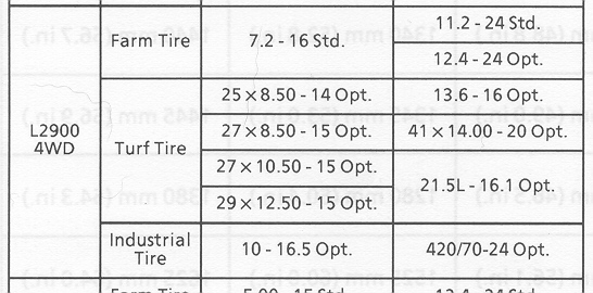

Recently bought an L2900 4WD. It has well used 27x8.50-15 R-1 tires on the front and 41x14.00-20 turf tires on the back. I wanted to put new R-1's on the tractor but unable to find 41x14.00-20's in an R-1. Other than a dealer, where can I find either this tire size in R-1 or rims for the rear that would be compatable? Best guess would be an 11.2-24 or 12.4-24. so the front and rear gear ratio in 4wd work together. Suggestions, ideas, thoughts?

See the attached chart for your tire sizes.
You will need different rims. Check savage yards or Kubota owners in your area. By the way WHERE are you located?? KennyV.

Thanks for the replies. I am in Central Texas and had masseys in the past so the Kubota 4wd was a little different. After talking with Kubota I was able to find new R-1 tires in metric out of Tenessee. They fit the rims on the tractor and would not damage the front axle. Thanks again for providing me with information.
