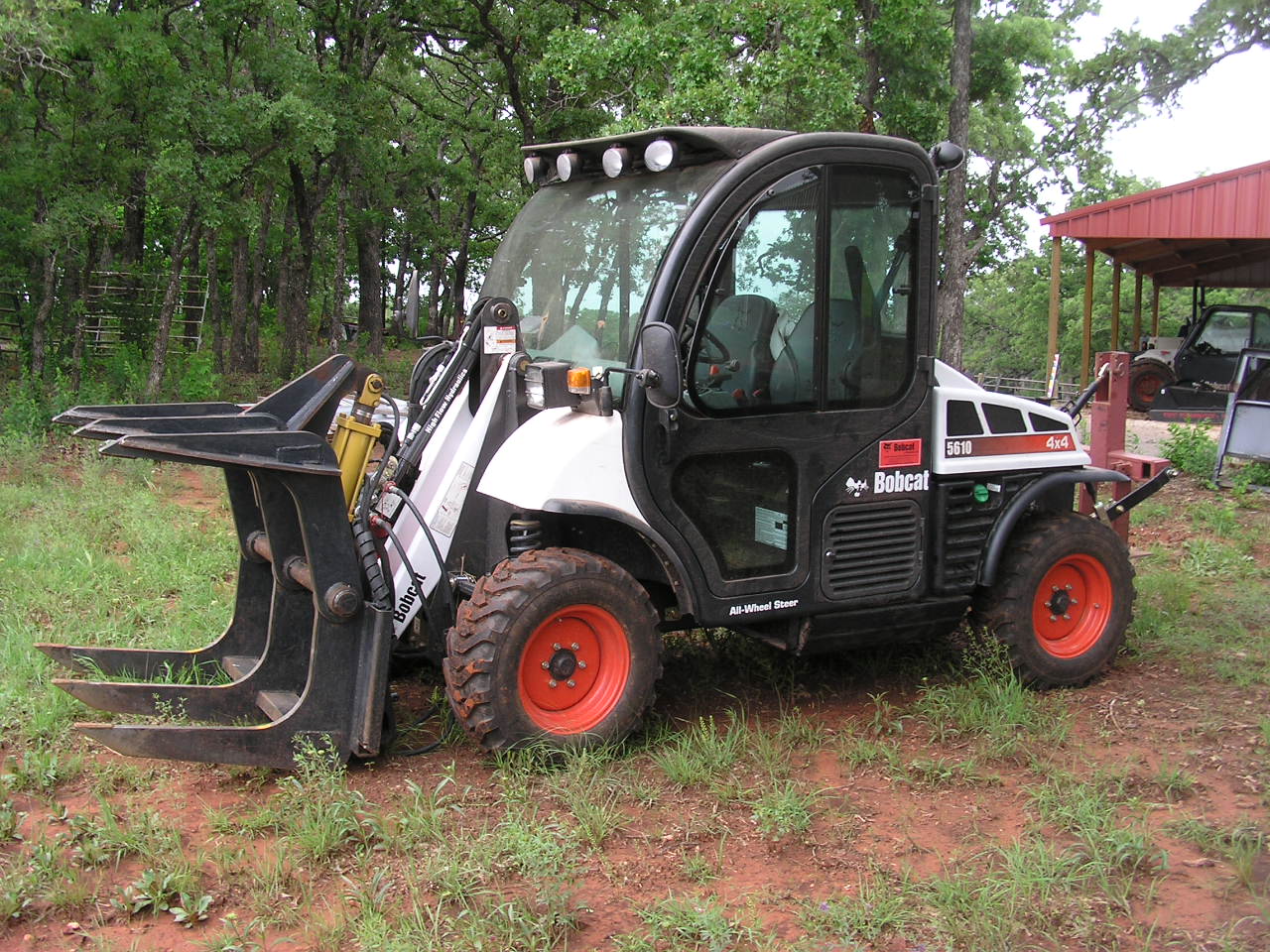

I store my grapple with the cylinder retracted like this.
Before disconnecting the hoses, I push a 2x4, cut to the right length, in between the top and bottom tines to hold it open. If I don't prop it open, the weight of the top tines tries to extend the cylinder, putting pressure on the connector.

Factory 3rd Function?
My V417 has a valve you turn to relieve the pressure, on the Toolcat the pressure release is built into the connector block.
I don't know how it is done on skid steers.
