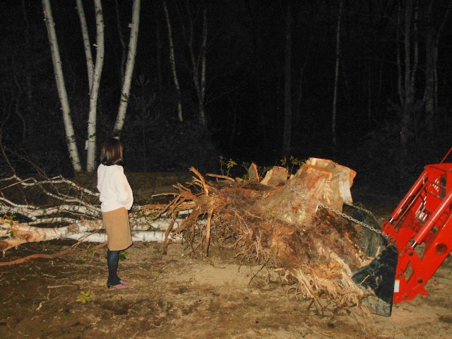

Actually that's something which quickly became apparent.
With loader bucket and backhoe attached you have a considerable
footprint to maneuver in confined areas. There is also the issue
of weight. An L48TLB weighs in at just under 4 tons. Then again
it wasn't intended for planting flowers.
Besides the obvious, one of the positive surprises was the available
torque in low gear. I've been able to bulldoze-over some mid-size
trees simply by using the loader bucket.
</font><font color="blue" class="small">( On these models the loader is not removable so you sacrifice some maneuverability compared to the Grand L's in tight spots. )</font>
Opting for the quick-attach bucket will help some here. Yet the lack of
a detachable loader is a design tradeoff -- the performance is impressive.
I've transported [est.] 3000LB water saturated root balls which if not
centered in the loader bucket would cause the tractor to tip as the
payload elevated (see attachment).
