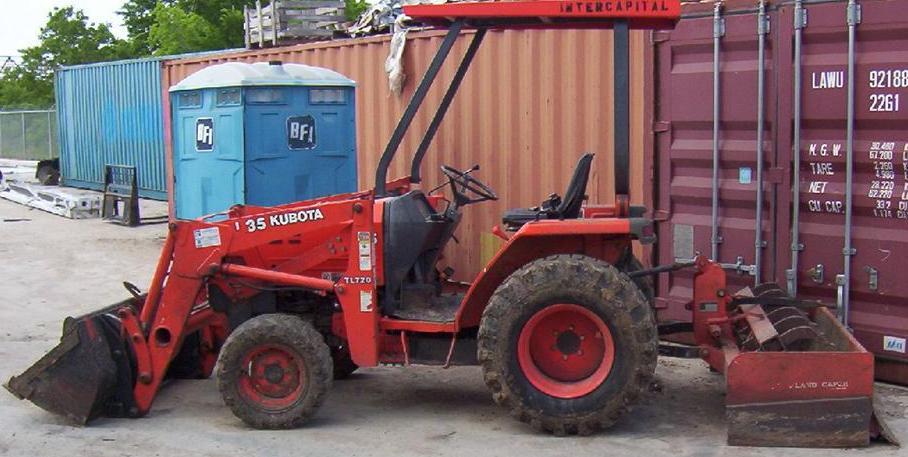

The two Kubota L35's i have at work are absolutly incredable. They do everything i put forth and never whimp out. I love GST, i have a number for each job and i leave the 4x4 in gear ever since we got both L35's in 1998 and nothing bad has happened. Since we got the, ive only had to replace the clutch recently and a rear lift arm. No big deal. Heres the boxblade L35 with a gannon 6 foot boxblade.

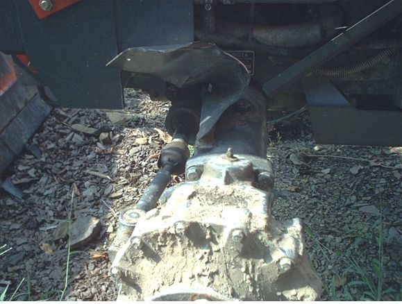

I too have had problems with the steering cylinders shields. Was working with it last weekend and it caught on a stump. It bent up and out and the corner punched a hole in side of my tire. /forums/images/graemlins/frown.gif
Anyone know if Kubota has a fix for this problem?

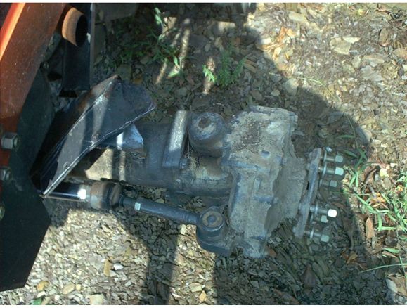

Another picture

JohnJC,
I know of no Kubota-sanctioned fix for this, but I'd like to suggest one of my own. What about putting 2 or 3 large hose clamps on shield once the new one is in place. The hose clamps, and maybe you'll need 4 of them, should pull the bottom of the shield up as close the axle as possible, to hopefully keep it from snagging anything, and will offer support to keep the shield from moving if it does get snagged.
Another thought would be a big truck muffler clamp, but I'm not sure if one is available that would be the right size for the axle and still have a snug fit. The hose clamps are pliable and will conform to the shape of the axle/shield as they are tightened.
Chris

I had to straighten my steering covers out many times and finally got a new one and found that the axel has holes tapped for bolts under it iand the cover lines up with them so I put bolts in and have had no trouble ever sense. Knock on wood. I do not know why Kubota did not but the bolts in right away????????
One more point- if they placed a bit of a frame or stamped rib in the gaurd they would have even a stronger cover. After all these are TLB's and are used like that. They do get more demanded of them than a tractor by it's self?
Good luck.
