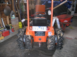

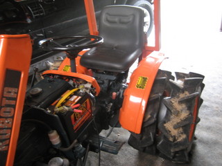

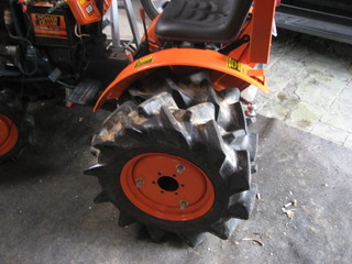

Scrapped the last idea, added spacers to the rear wheels and bolted on a second wheel on each side,thus keeping the same ratio between front and back. cost a bit but solved the problem.Steve

Can you post pictures? I'd like to see this...

Here are the photos....I hope
   / Kubota tyres #9
Thanks for the pics. I love to see the different versions of Kubotas in other parts of the world. Looks great-Good Day Mate!:p
   / Kubota tyres #10
That looks seriously cool! I'm used to seeing the large ag tractors with dual rears, but not smaller ones. I'll bet that make it real stable on slopes. I also bet you'll never loose traction :D

I saw those tires on another Bota posted here to the forum, I believe those
tires are Rice Patty Tires !!! :D No Rice fields there in Australia?
