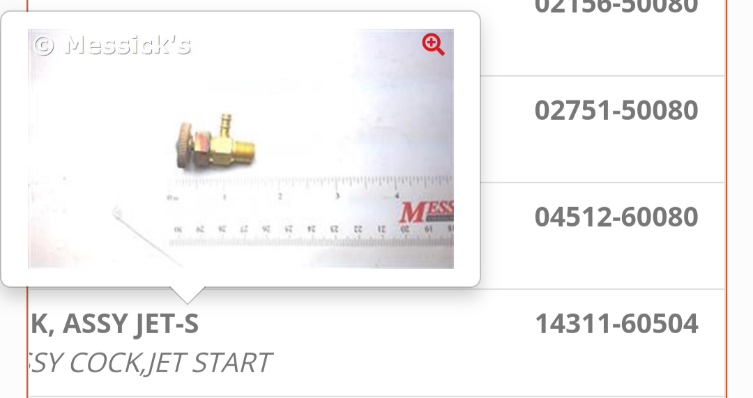

The L4630 uses a version of the V2203 engine, but there are other versions, so no guarantee.
Here's the part from Messick's, but no price listed.

Shown on Amazon and eBay. Probably not OEM.
Edit: used on the L2501 still in production. The new part number is 14311-60605.
