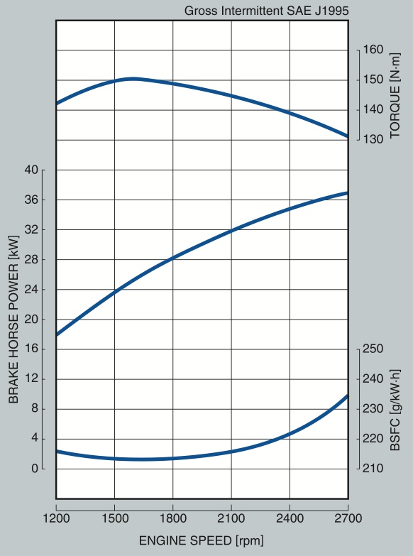

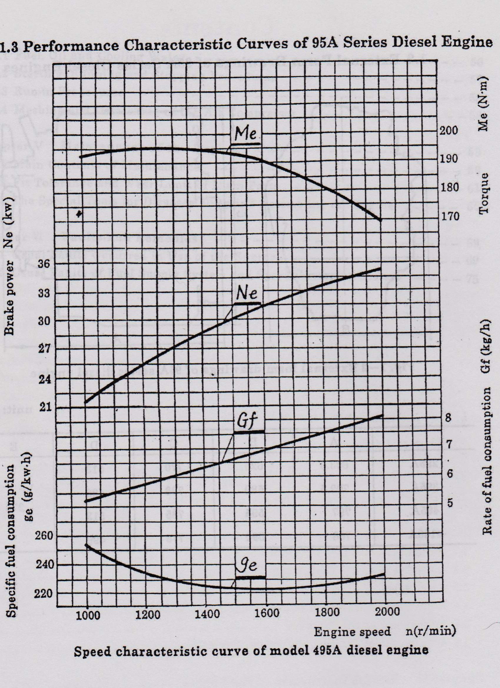

I love engine performance charts -- there is so much more information in them than just the maximum horsepower and maximum torque that you get in tractor brochures. I was looking at the charts of the two engines previously discussed and noticed something interesting. The specific fuel consumption of the two engines is almost exactly the same at maximum RPM, but the "high torque" engine loses efficiency when operated in the region of maximum torque.
Here are the numbers:
1) What is the specific fuel consumption of the 95A engine when operated near maximum torque (about 1250 RPM)?
=> From the chart, the engine burns about 232 g/kW-h (grams per kilowatt-hour). Surprisingly, this is about the same as the specific fuel consumption ( 233 g/kW-h) at maximum RPM.
2) What is the specific fuel consumption of the Kubota engine when operating at an RPM to match the horsepower of the 95A engine?
=> At 1250 RPM the 95A engine produces about 35 HP (26 kW). The Kubota will produce the same power at about 1650 RPM, and it will have a specific fuel consumption of 213 g/kW-h. This is about 90% of the specific fuel consumption (235 g/kW-h) of the engine at maximum RPM.
So, the two engines have the same efficiency when running at full power, but the Kubota engine is about 10% more efficient when running at 70% power capacity.
===> Before anyone starts screaming, I not trying to make an argument that "high torque" engines are, in general, less efficient than other engines. I'm only comparing these two engines.
