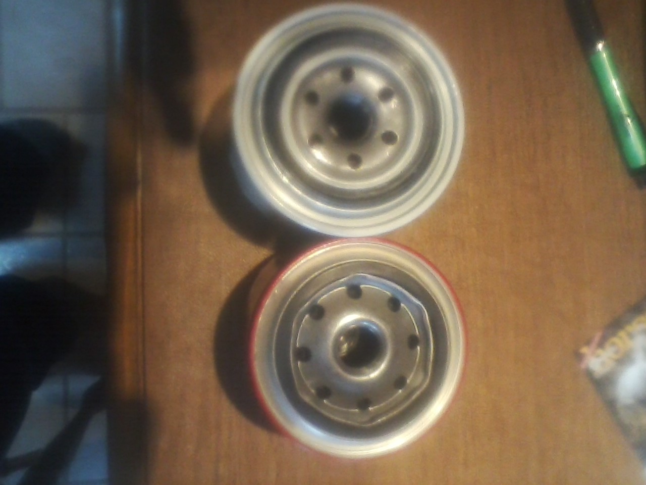

I put a baldwin b7152 on my l3800 and every time you started it you could hear the bypass valve till it warmed up a bit big difference on filter weight and mounting plate HH164-32430 KUBOTA filter number 0205181157-00.jpg
