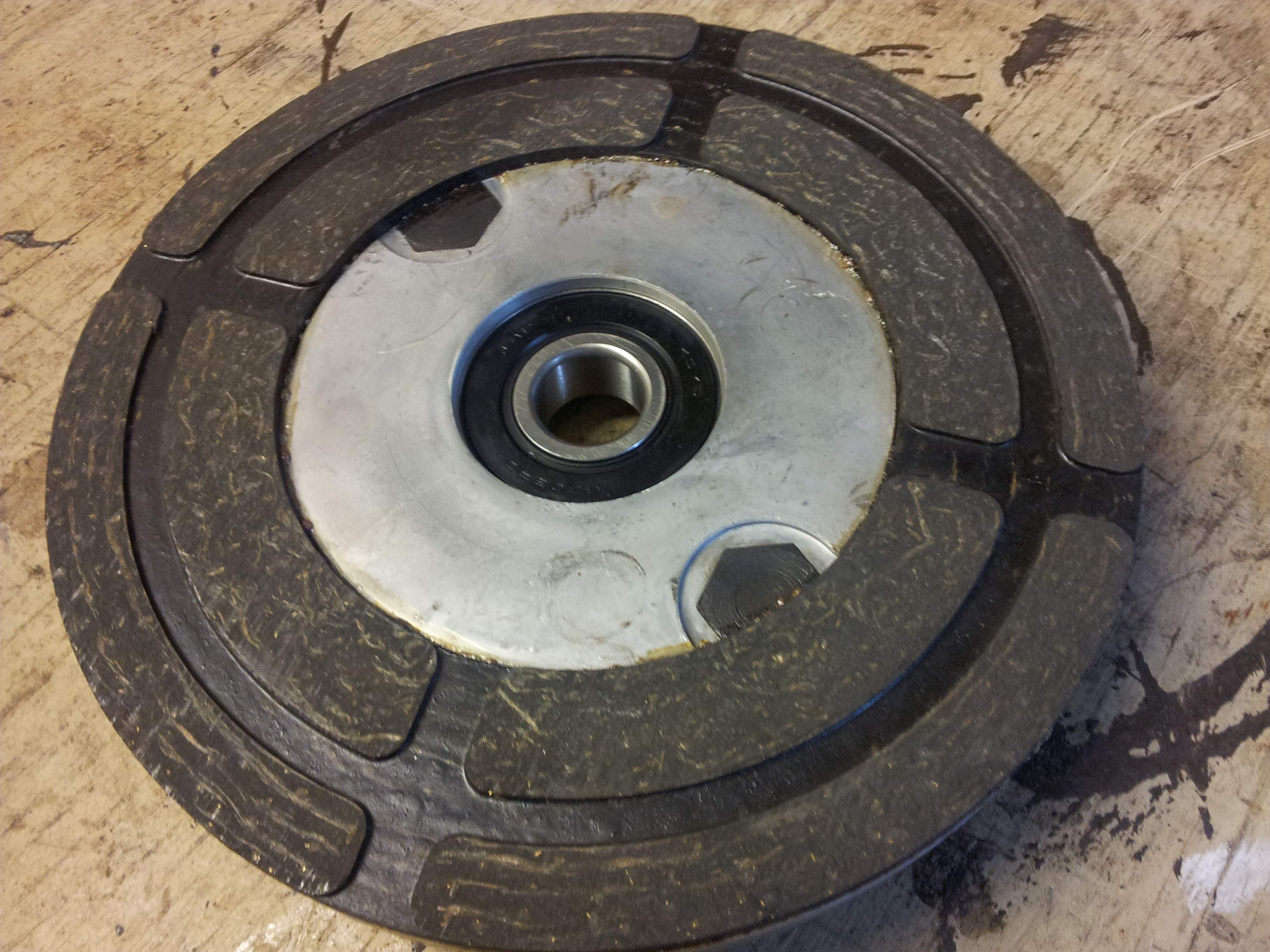

I didnt know Kubota made a push mower. I ran across one of these on Craigslist and started researching. I read how well they were built, so I snatched it up for $40.00. It almost looks new, the guy said it has been in storage for about 3 years. I drove it home and pulled the air filter and it looks like they stored it upside down. The filter and carb was full of very black oil, I pulled the sparkplug and it looked the same. After cleaning and re-installing, and adding fresh gas w/Sea foam, it started on the first pull. It smoked a little at first but cleared out, the only issue was the blade wouldnt turn.
I researched for parts and the clutch plate itself is a discontinued item. The only option is to order the whole clutch assembly. Direct from Kubota there about $300.00, Sears has them for $167.00, so I bit the bullet and bought it from Sears.
After installing, I mowed the front yard and had 2 of my neighbors come over to look at it. The mower works flawlesly. I'm looking for a side discharge chute if anyone knows where I can get one.
