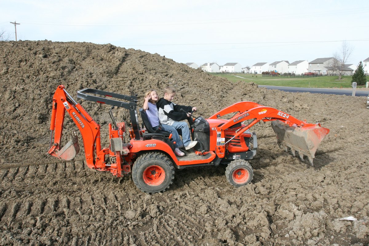

There are two things I would suggest with the Markham teeth. They are very tough (much tougher than the FEL bucket itself. I would well a small plate where the hole is drilled through the side of the bucket to avoid tearing the plate (sorry, I could not find a picture of mine)
Also, because they are so aggressive, don't turn your back on your kids for minute .... This yard was all finished and in the same time it too me to go to the bathroom, look what my kids and these teeth did to my front yard!
Wait, how come you took off the dozer pads? :D
BX-24
Your gonna give the safety police a heart attack!!:D ROPS DOWN,CHILDREN OPERATING THE TRACTOR,NO SEATBELTS,RIDING DOUBLE..........
Its a good thing we know ITS A JOKE.
ALAN
   / KUBOTA WENT TO THE DENTIST #19
I thought about the safety police and hesitated to post the pic. Needless to say the distance that I took the picture from was the farthest away from them that I got. In a perfect world, letting them drive/ride it is not the best of ideas, but having the throttle just over idle in turtle mode I felt pretty safe (especially after they both just got off 90cc kid 4-wheelers ... and yes they were wearing helmets)
