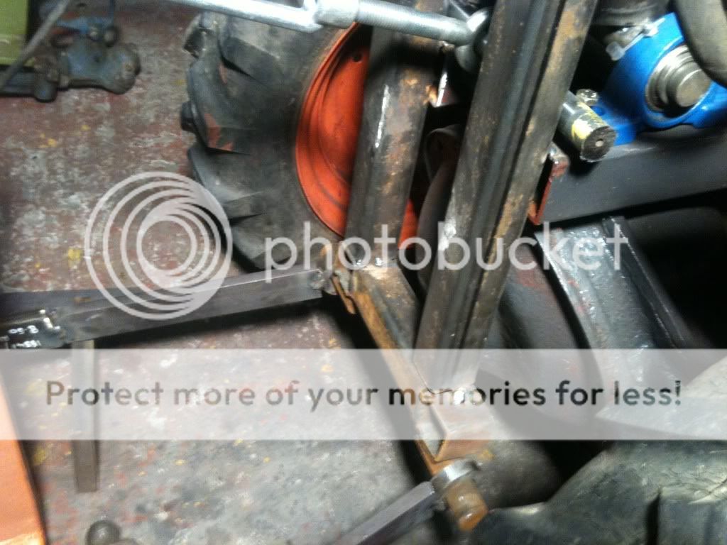

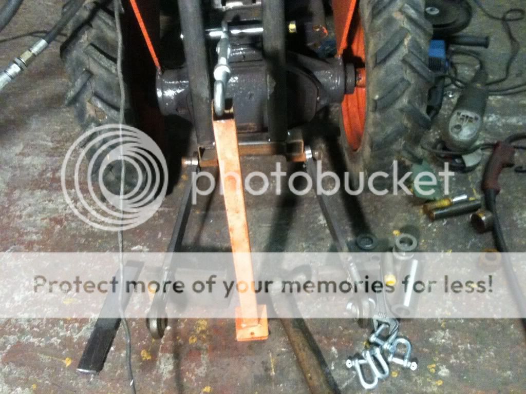

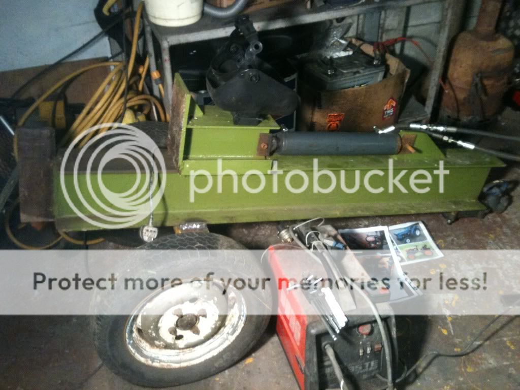

Been a while since an update, but the project is back on track! A filterhas been added to the tractor and the three point linkage is well under way. Not designed to lift a great deal for fear of lifting the front and/or bending something the linkage will be powered with a small cylinder. Anyways, here is a few pics of whats been happening, ive also made a log splitter and been using it with great results.
