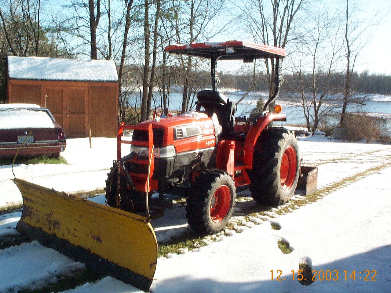

Kubota does not offer a hydro turn snow plow for the L series like they do for the B series. Is there an after market company that does? I don't want a blade on the loader. Been there done that with other tractors.
Steve
/ L 3200 plow
Interesting.
/ L 3200 plow #4

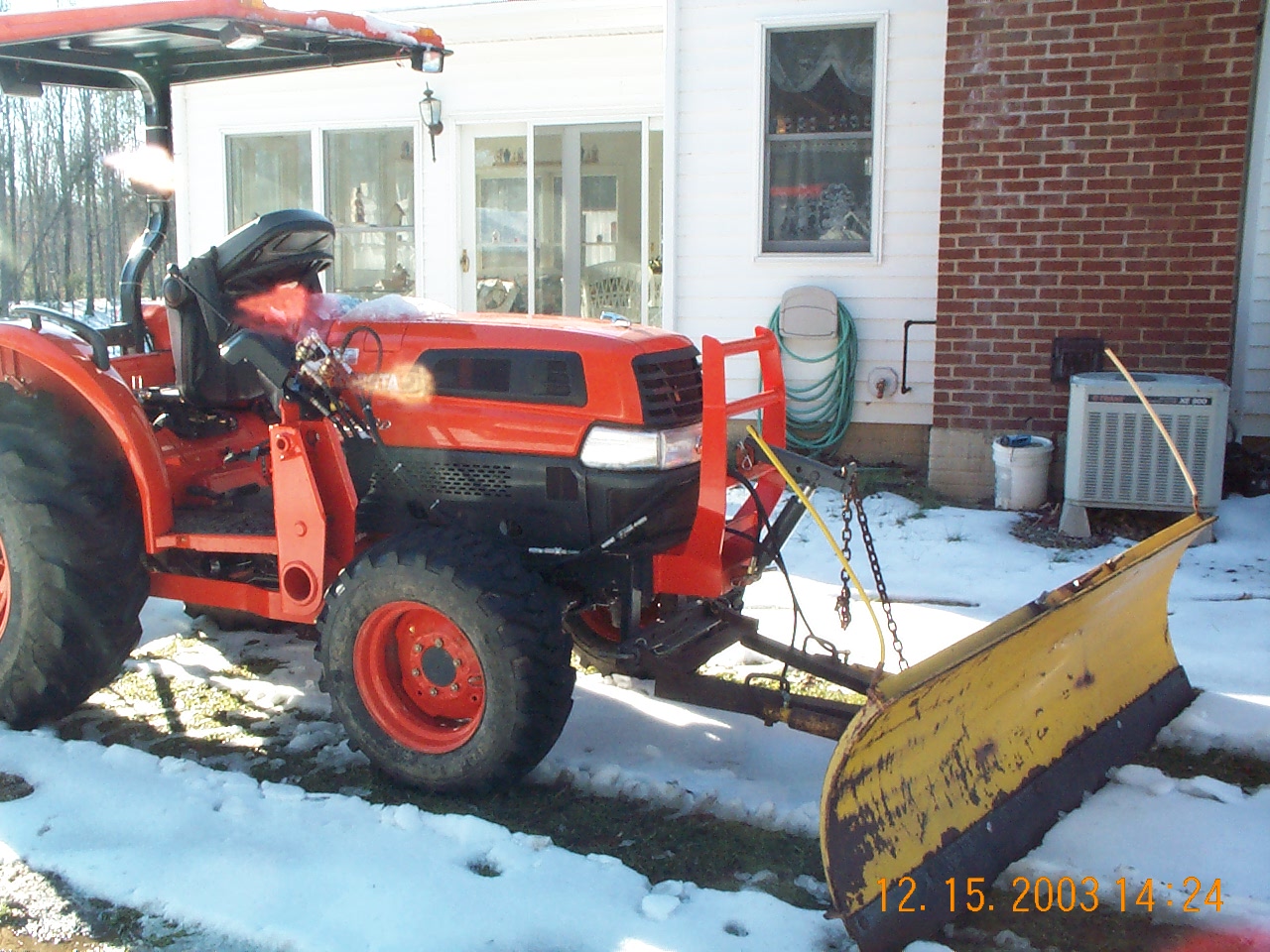

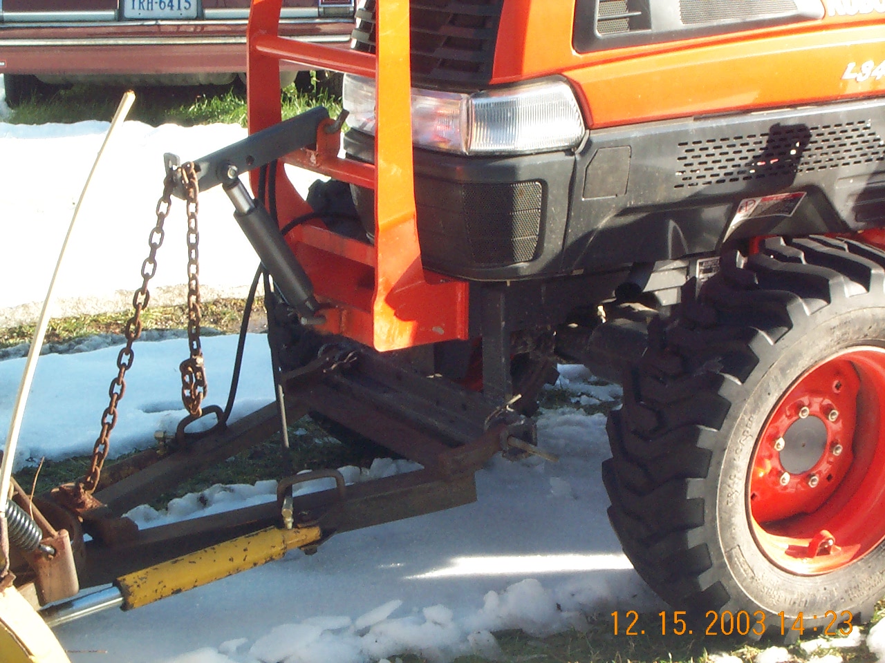

It's easy to put one on. I bought an old Meyers plow and mount that I adapted to my L3430. I use the loader valve to raise/lower and angle the blade. Plowed with it this morning.
