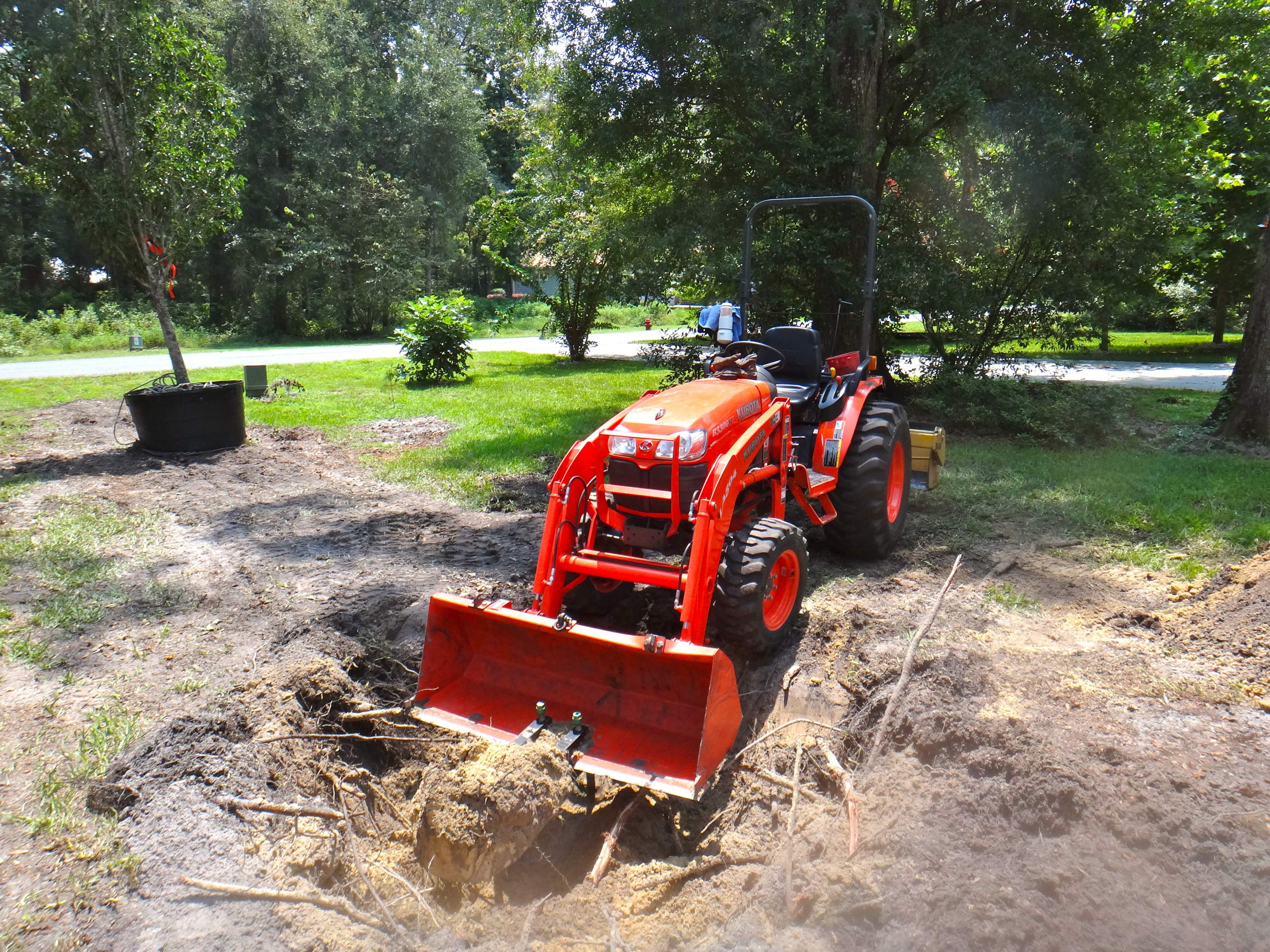

I recommend counterbalancing ballast mounted on the 3-Pt. Hitch. Generally speaking, the ballast should approximate the lift capacity of your FEL. Is the sand in your Ballast Box wet or dry? You could moisten sand with 200 pounds of water.
I use a 630 pound Rollover Box Blade (ROBB) as ballast. The lift capacity of my FEL is 730 - 1065 pound.
Ballast on the 3-Pt. Hitch relieves strain on the front axle. Wheel weights do not.
Some is just becoming acclimated to the feel of a tractor. On tractors you sit high and centered so you can watch your work in front, to sides and in back.
Much different feeling from a car.
Attached is a picture of my tractor excavating a 54" deep tree planting hole with a Bucket Spade, ROBB mounted on the 3-Pt. hitch. I have industrial tires (R4s). You would not want to try attempt this excavation with turf tires, tractor would slide into the hole.
