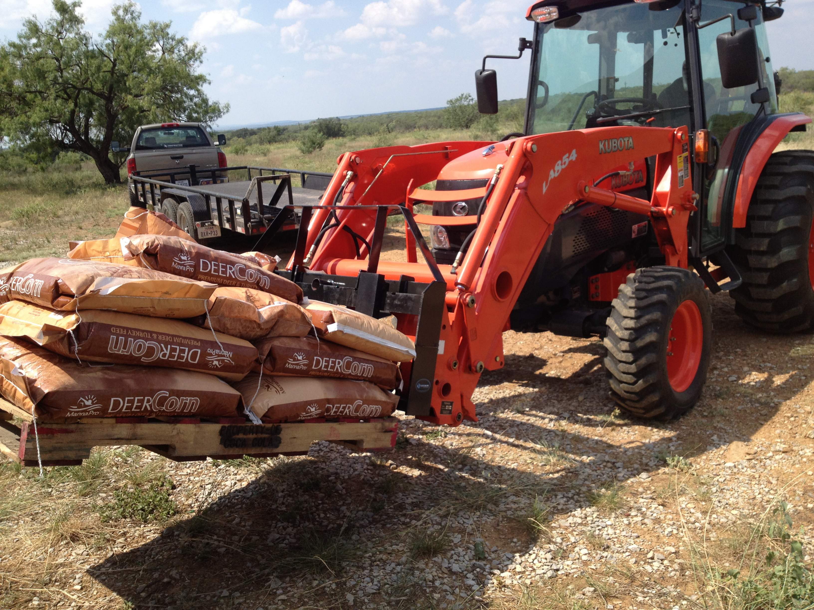

I found out real quick that 1.5k lbs of deer corn on forks with only a PHD on the 3pt and loaded tires wasn't enough ballast. Didn't tip but had zero traction on the rear tires and couldn't back up in 2wd. I could have put it in 4wd but that would be ignoring the warning signs of too much weight.

I'm not sure what to do here. I'm not a tractor veteran.
I have a 3540 cab 724 QA FEL HD bucket R4's and 1000lb ballast box filled w/ sand. Front/back tires 42psi/16psi
Driving this around with just the loader on and no bucket, it feels solid. Anything added onto 3point and it feels perfectly solid.
But with the bucket on it feels like too much weight is forward, even with no material. I hate the feeling of having it on 3 wheels.
I was hoping their own ballast box would work perfect here since I do use it in the woods, and the only heavy 3 point attch I've been considering is a finish mower that's 84" and 900lbs. But that's going to make this thing a bus, and it won't hold up well backing into something.
The only other tractor changes I had been thinking of were turf tires and (if they even make it), front wheel spacers. I know turf's are lower, but not sure how much that'll help here.
