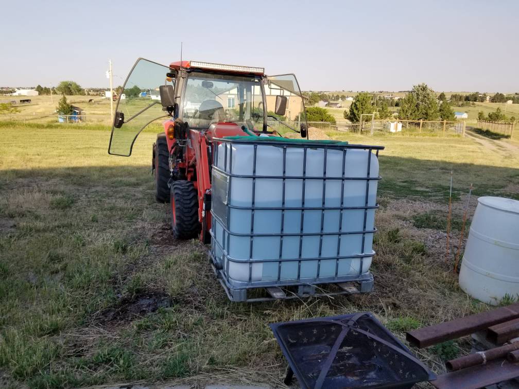

275 gal ibc tote x 3/4 full x 8.34lbs/gal = about 1,700lbs. I could have filled it up a bit more & still lifted it but didnt want to push it as I bounced across the yard. Add in the 200lbs of forks & who knows what for hanging out a bit in front of the pins.
Feel free to check or question my math (I suck at it). But it's in the same ballpark of that pallet listed at 1,900lbs I couldn't quite lift. 20180701_185900.jpeg
