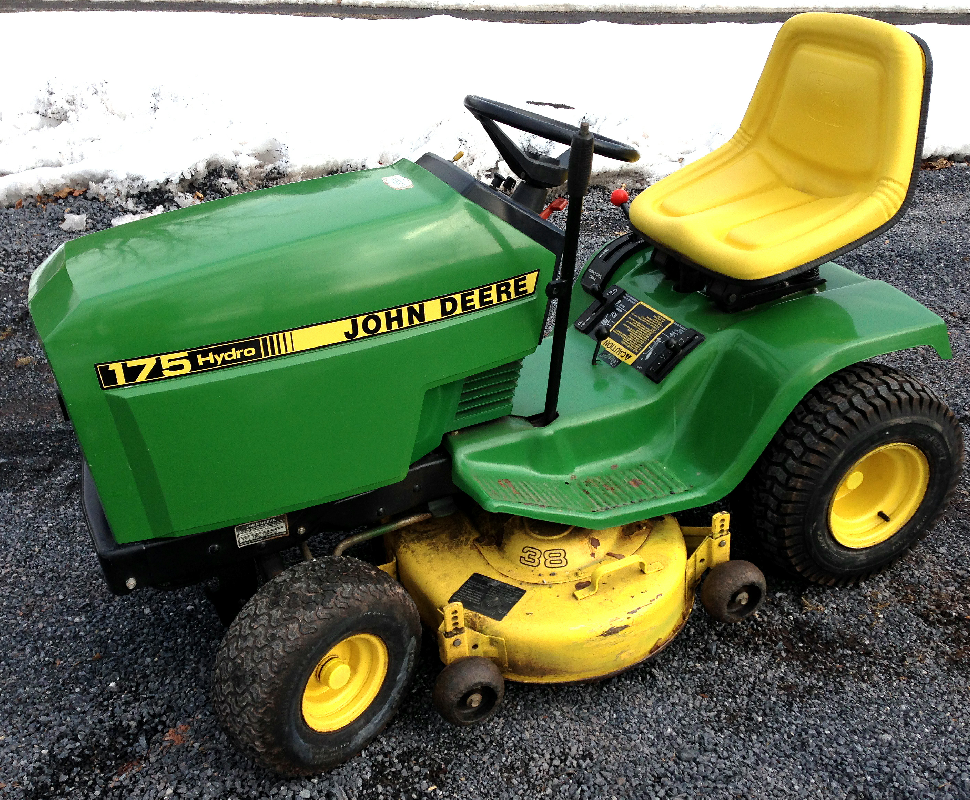

What did you do to cause the decks to look like that? It also looks like the engine is leaking oil everywhere. My old JD 175 Hydro was over 25 years old with a couple thousand hours and it looked nothing like that.

LA140 was sitting outside on the property when I moved here. It was very poorly maintained and never stored inside. As a result - I started heavily undercoating the machine and deck with Krown rust proofing (that was 2016). The engine does not leak a drop of oil - it's the undercoating you're seeing. The L120 was given to us in basically the same condition for free. It needed a drive belt and a battery. Everyone is pretty quick to judge LOL ... it`s okay, I have broad shoulders!
