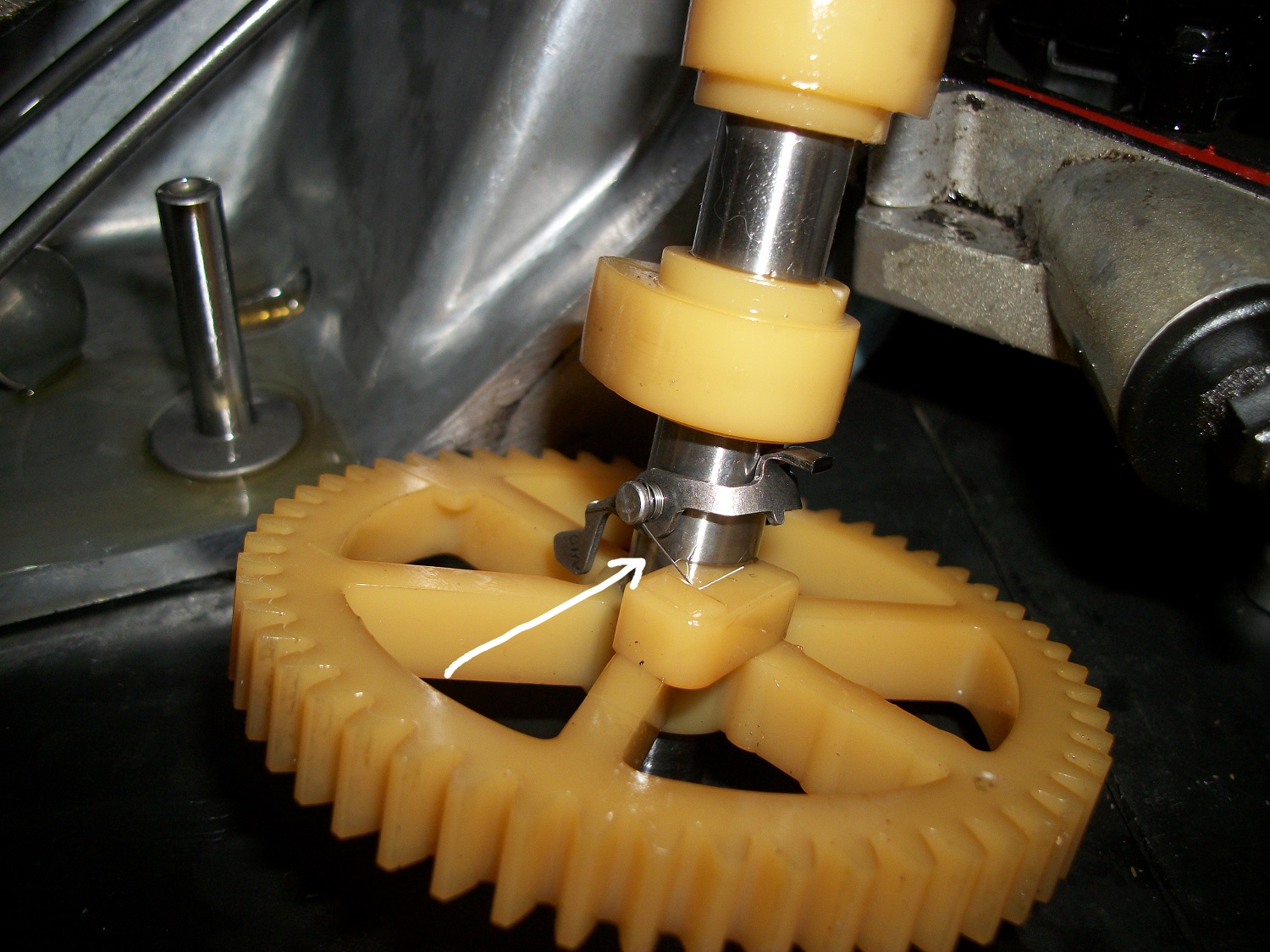

Helped a buddy find and fix a compression release problem on a one-cyl B&S engine given to him.. nearly new engine that had been over-filled with oil.
Starter cord ripped out of the owners hand and had to have stitches to close the wounds.. ?? don't know how but it is the story given.
Tore the engine down.. nothing to lose.
Found a sheared flywheel key so thought that was the only problem. Re-assembled, but same hard pull on the starter cord.
Tore it down again and found how the compression release worked.. There was a very tiny spring that held the mechanism in position to keep a valve open until some rpm's cause it to move (like a governor, somewhat).
Here is a pic of the mechanism and the tiny spring on the camshaft. Arrow pointing to it. Figure the overfill of oil bent that spring so it wouldn't function. Bent it back, and the engine cranked fine and ran fine.
Not at all sure that is anywhere close to the problem of the OP.. just thought it might help to know a bit about the compression release mechanism.

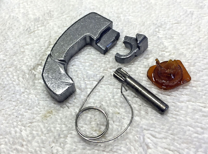

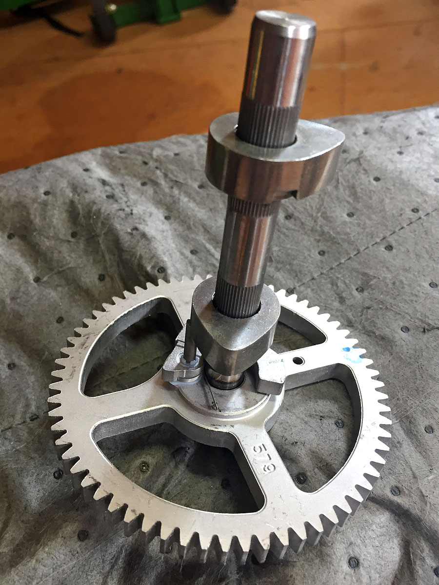

Wow! Are those PLASTIC cam lobes? Your compression release is a bit different than my 31-series 17.5HP B&S that I recently repaired. However, they both appear to use a spring more suited for a CooCoo clock. Below are some photos of my broken compression release pieces and the new cam.
