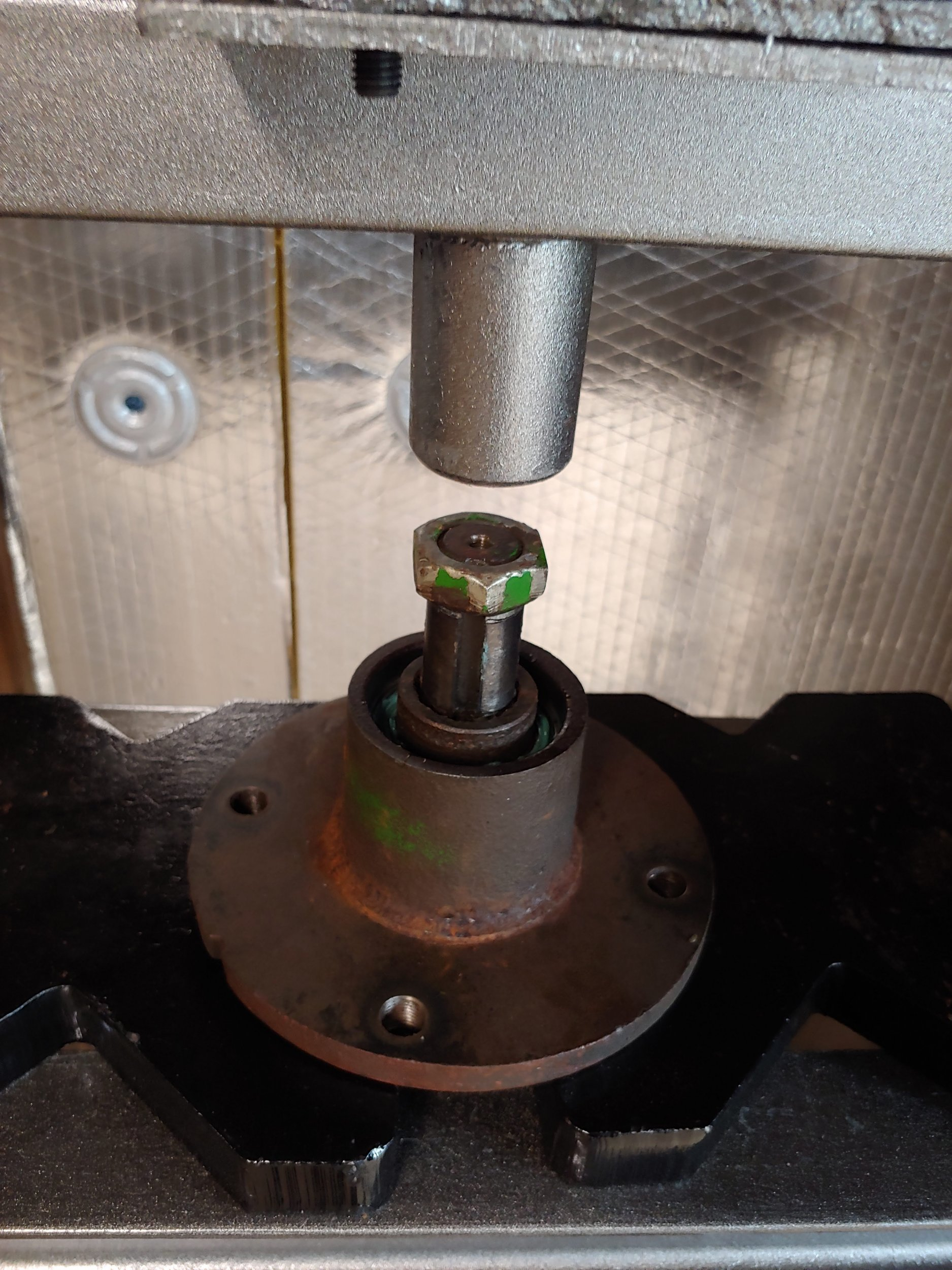

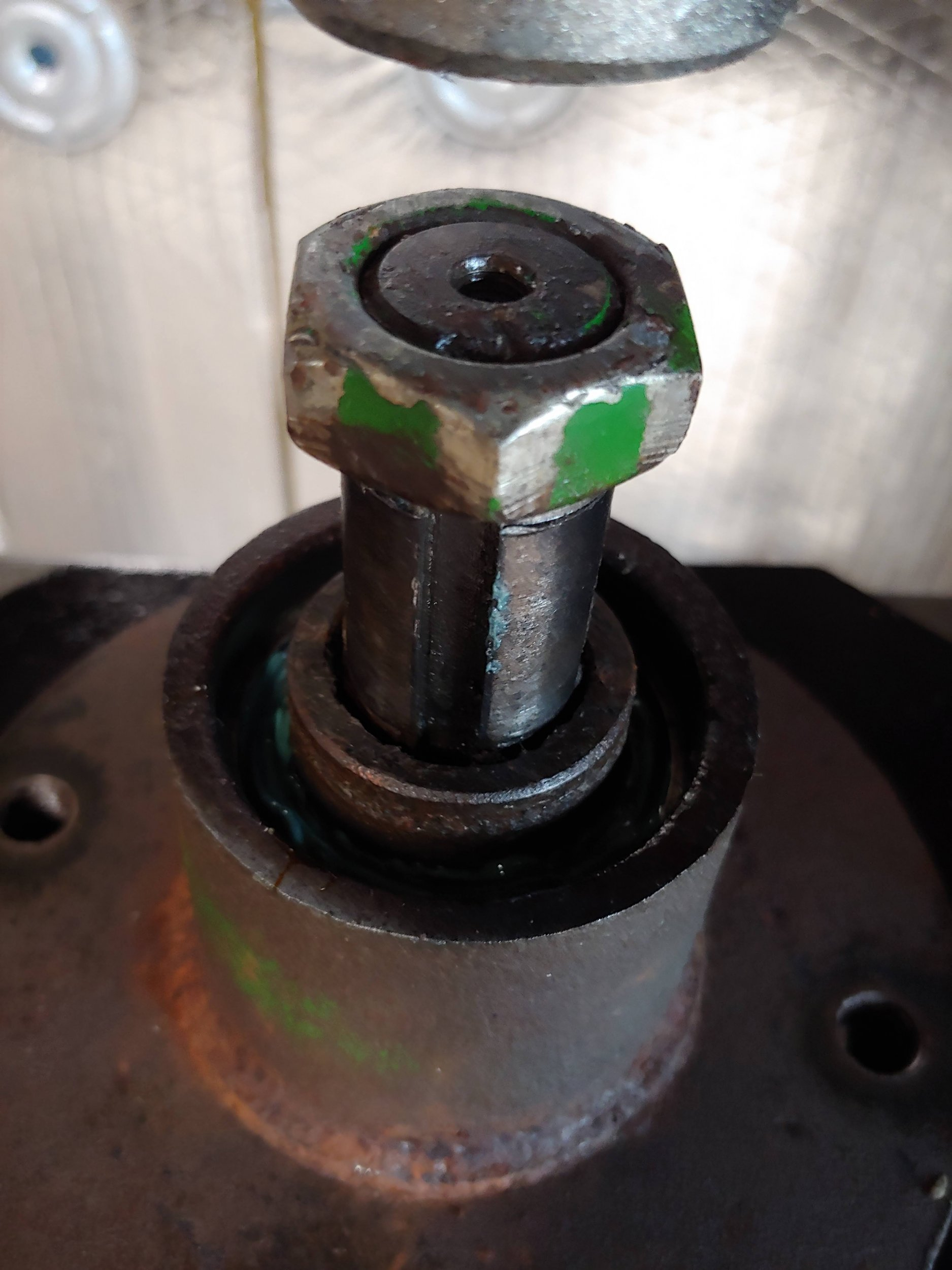

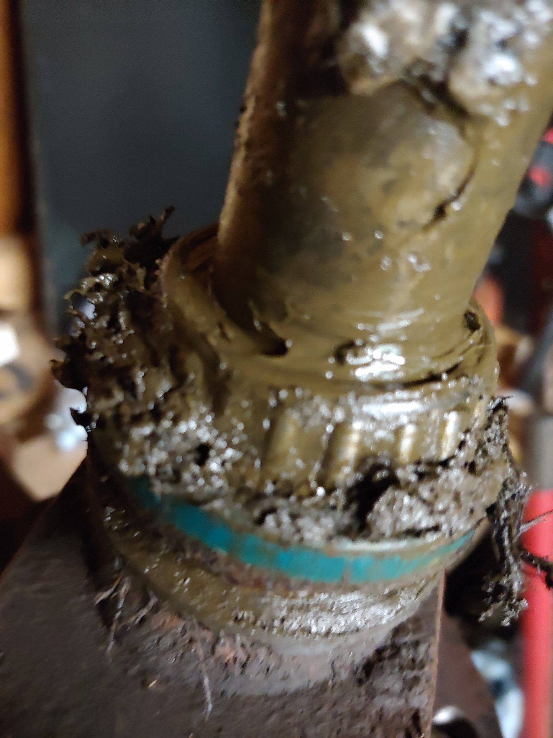

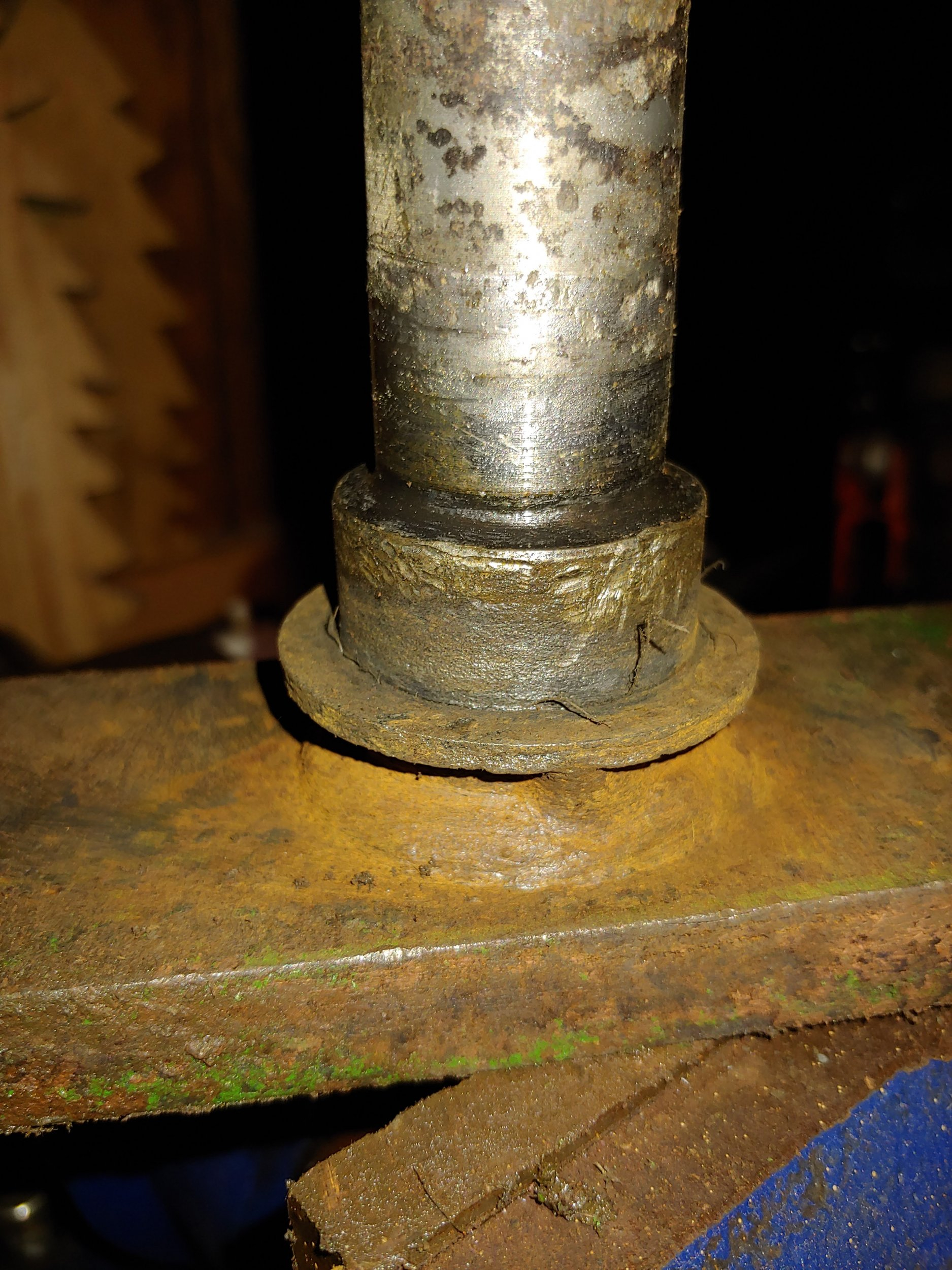

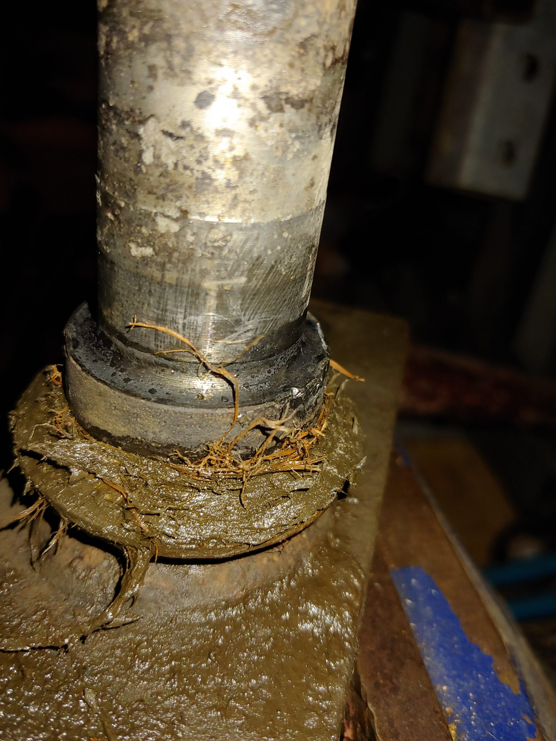

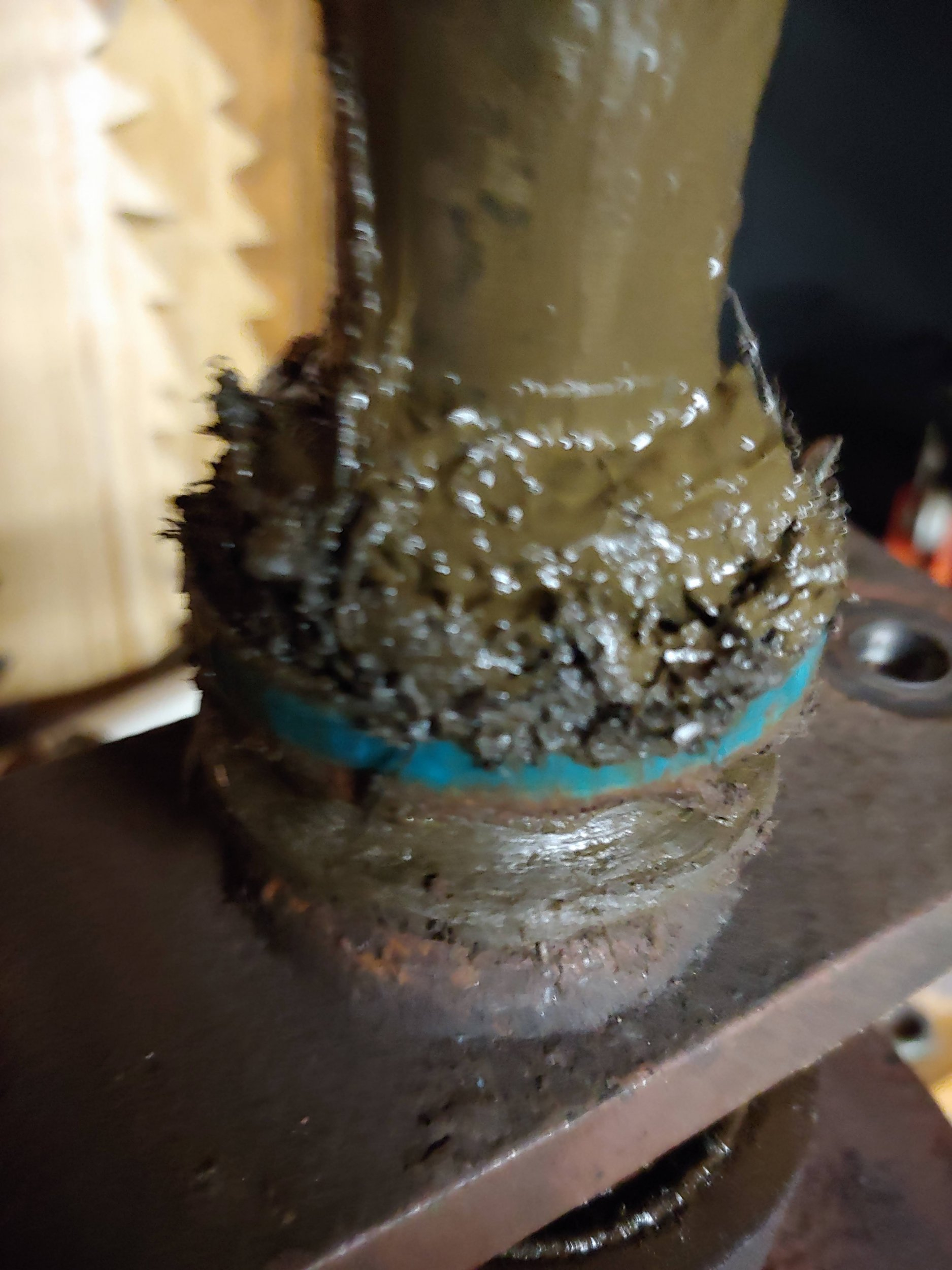

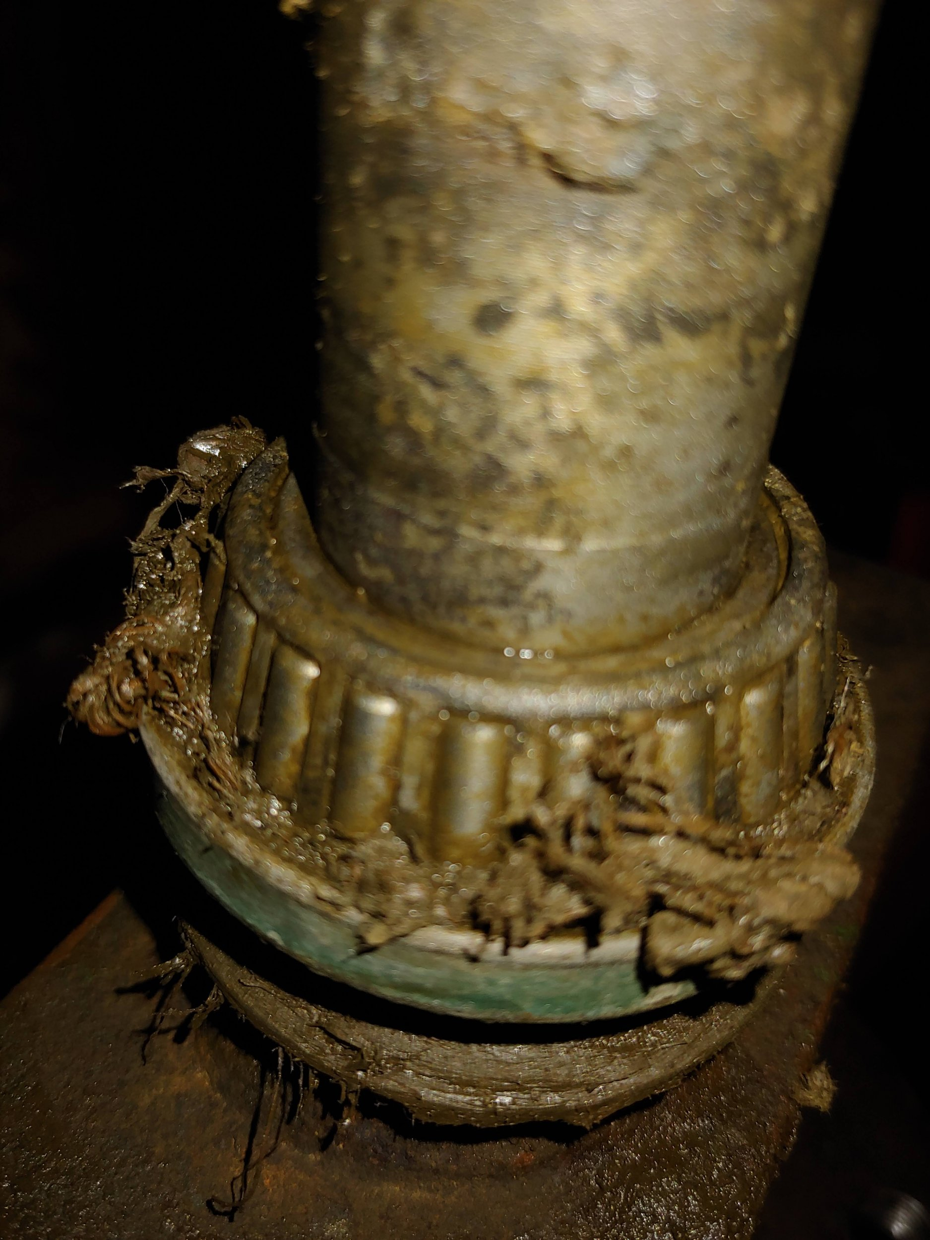

Been working on my mower for a few weeks it had a bad bearing due
to the previous owner running over poly twine continuously. And it
got into the bearings. Here is some photos of what I found.
Dave
   / L185 Kubota
#36
I got it back together and am waiting on the top seal
to come in because I damaged one.
Dave

Got everything back together over the weekend after breaking
another temporary bolt off in the pulley and having to remove
the pulley back off and get it out. Also drilled out the other
broken one before that. I think it's ready to go now so hopefully
tomorrow after work I can try it out. I'll report how it goes fingers
crossed.
Dave

Got the mower hooked up today and
it was quieter but still louder than I
think it should be so I think I will
change out the other two sets of
bearings and see if that helps.
Dave
