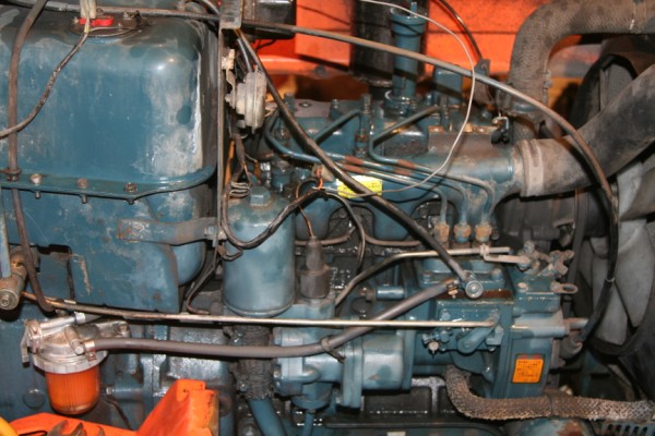

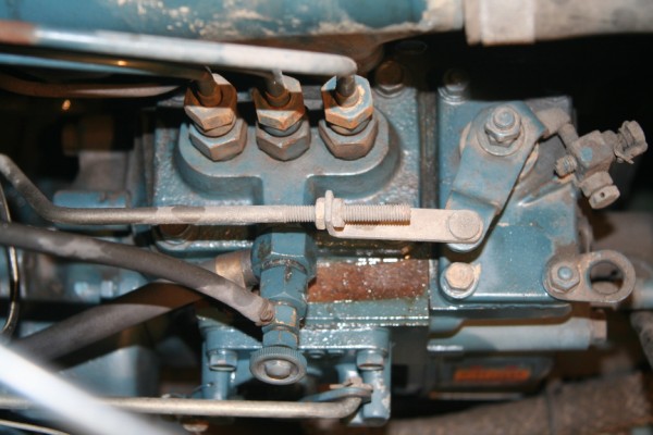

Hi Still struggling to get my tractor started. I thought I would post some pics of the fuel system.As you can see the fuel filter housing has only one spot that might be a bleed point. The fitting is a 10mm but has a hose connected to it that runs to the top of the tank. Do I remove this hose when bleeding or just leave it. Also in the pics you can see a small wheel at the inlet point on the pump. I assumed this was a fuel shutoff. If its for bleeding could anyone enlighten me as to the procedure. I cant see any other spots on the pump that might be for bleeding. I tried again today to bleed from the injectors but I was getting concerned about running the starter for too long. I did keep the decompression valve open when cranking but in some other posts I saw that people recommended cracking all the injector lines at once and closing them as bubbles disappear and that the engine should fire in which case I should leave the valve closed? Thanks.Gerry

It doesn't look like there is a bleeder on the filter. The wheel on the injector pump is the bleeder. Open it & the air should come out of the lines. Close it before trying to start it.

A couple of thoughts for free. Is that knurled knob on the injector pump a valve or is it a hand pump? I have a chinese tractor that has a little pump, that you unscrew, pull out, pump, then screw back in, to bleed the system. Second, have you tried using diesel 911 or other such similar diesel driers or gum cutter products? I have had success at unclogging gummed up pumps, by pouring the product at about 50/50 with the fuel, into the pump, allowing to sit for about a week, and letting it eat the gum out.:)

Hi Guys I have decided at this point to wait and see if the guy comes up with a motor for me. He should provide me one at no charge so I'm just out my time if it doesn't work. As for the bleeder it is a valve not a pump. De-gumming the pump is a good idea Dave I will give that a try. I'm am also wondering if I should pull the head off this motor to take a closer look. Maybe the problem is as simple as a headgasket. If its worse than that I can take the motor exchange route. Thanks for the tips. Will post updates and no doubt more questions as I go. Gerry

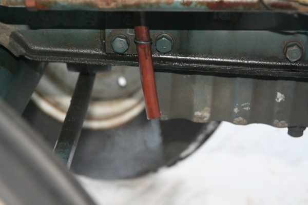

My mechanic came around today to see if the 2402 ran any better. This time he got it to start without too much trouble. He had worked on another little Kubota recently with the same problem and now believes the gummed up pump is a big part of the problem. Anyway I let it run for a good hour at which point it was running a lot better. Here's what its still doing- a fair bit of blue smoke is still coming from the exhaust ( running at half throttle in the photos ), quite a bit of blowby coming out of the breather tube. Also when I pull the dipstick oil spatters out of the hole.
Can blowby like this be caused by a bad headgasket or are there other problems causing this such as rings. If the 480 hrs showing on the meter is fairly accurate is it more likely that I could get away with just a ring job or is that wishful thinking on my part. Thanks.Gerry

   / L2402 won't start #19
"Can blowby like this be caused by a bad headgasket or are there other problems causing this such as rings."
Rings
