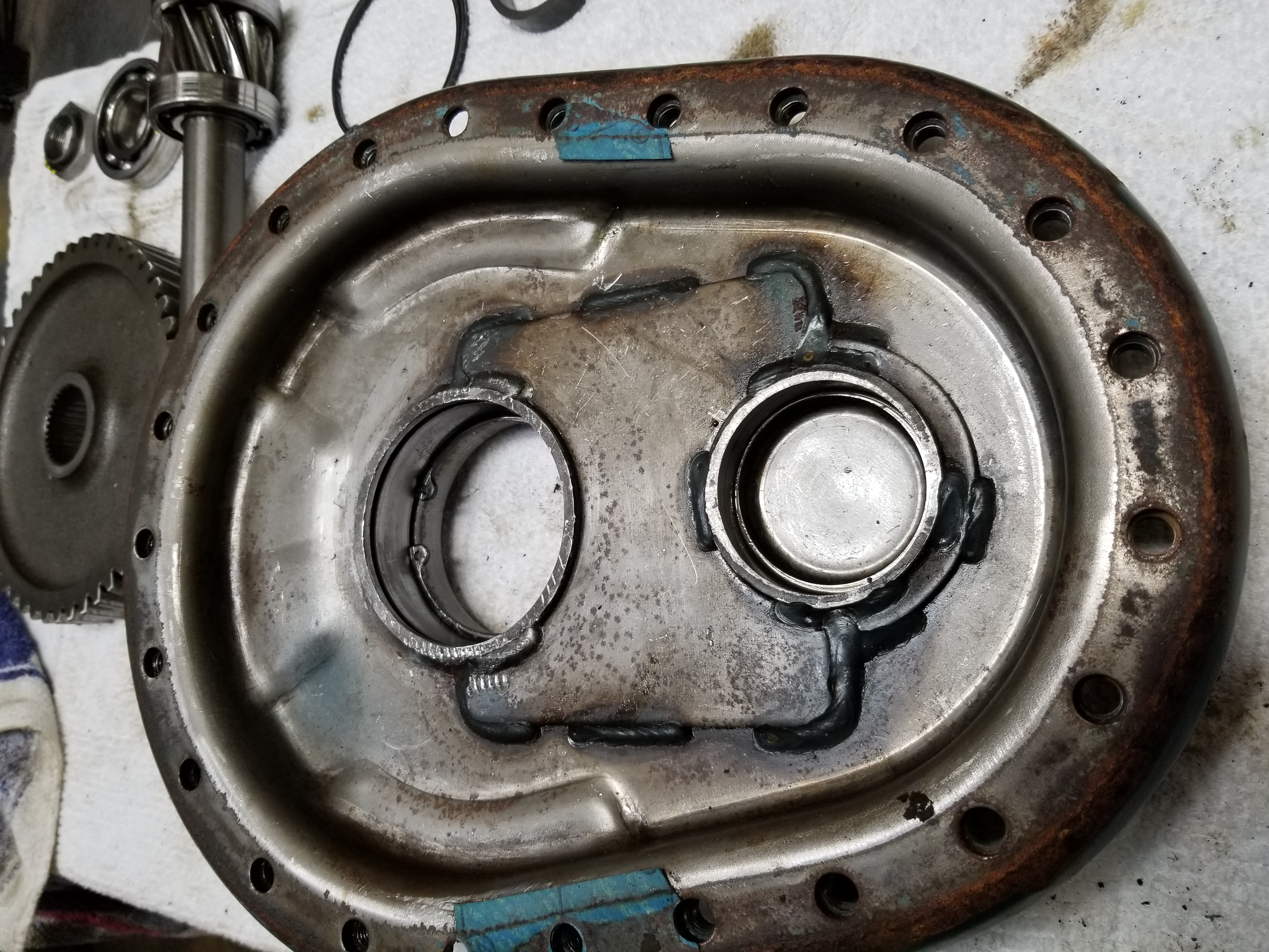

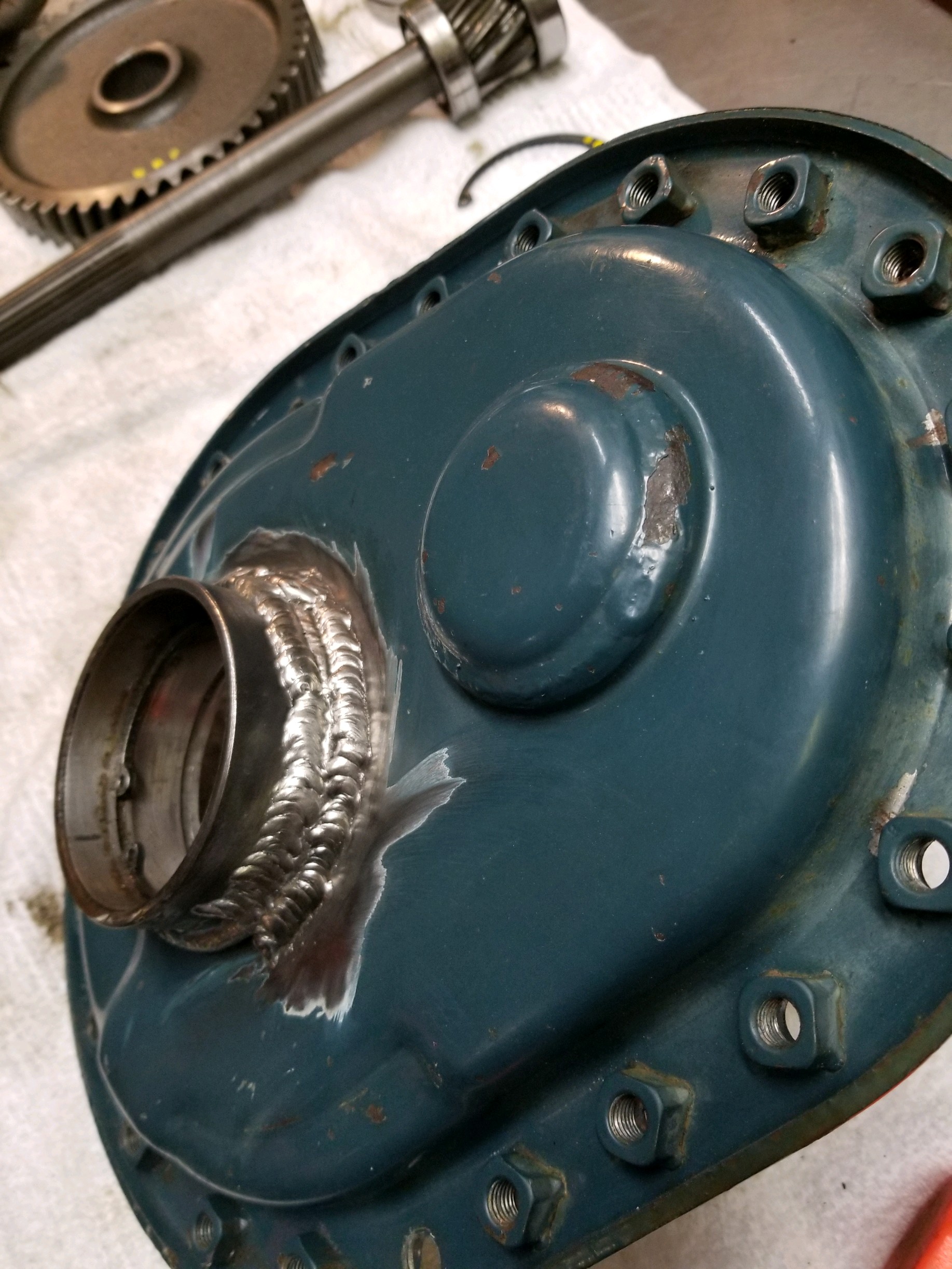

Tillers are really rough on this part of the tractor. I have seen one repaired with rebar at auction. Your fix looks great in comparison. Good tractor, so a couple problems should not be a reason to move on.
   / L245DT Rear Axle Cover #12
Is there a snapring holding the seal in place. This is dumb I know, but after putting all back together, I realized I had a snap ring that I took out and did not put back in. I was not replacing any bearings and don't know why I wouild have pulled that out? any answers where that would go?
   / L245DT Rear Axle Cover #13
The parts diagram shows internal cir-clips #9 on both sides of the bearing to keep the stack located. Depending on which one is not installed the "float" will allow either the gear or the end of the axle to rub on the inside of the case. The #10 nut will keep it assembled, but the axle moving in and out may cause the outer oil seal to leak. The only good news in taking it apart again is the learning curve is flatter on the second dive. Good luck, Dick B

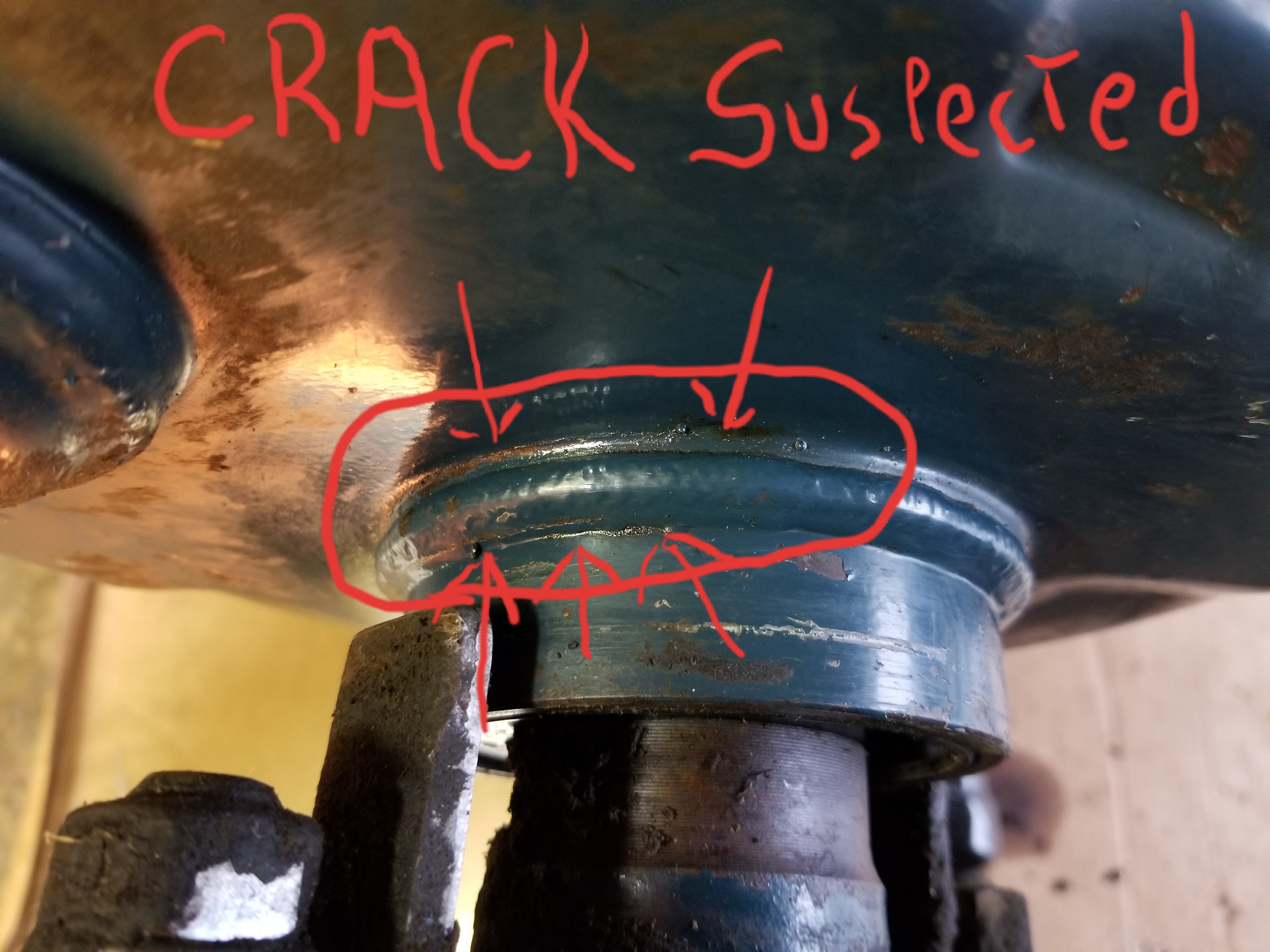

I've got the same crack issue on a 1980 L245DT......thinking about the external reinforcing option.
Got a suggestion on another forum to weld the whole circumference of the bearing/seal area.....which I'm going to do this coming week.
   / L245DT Rear Axle Cover #15

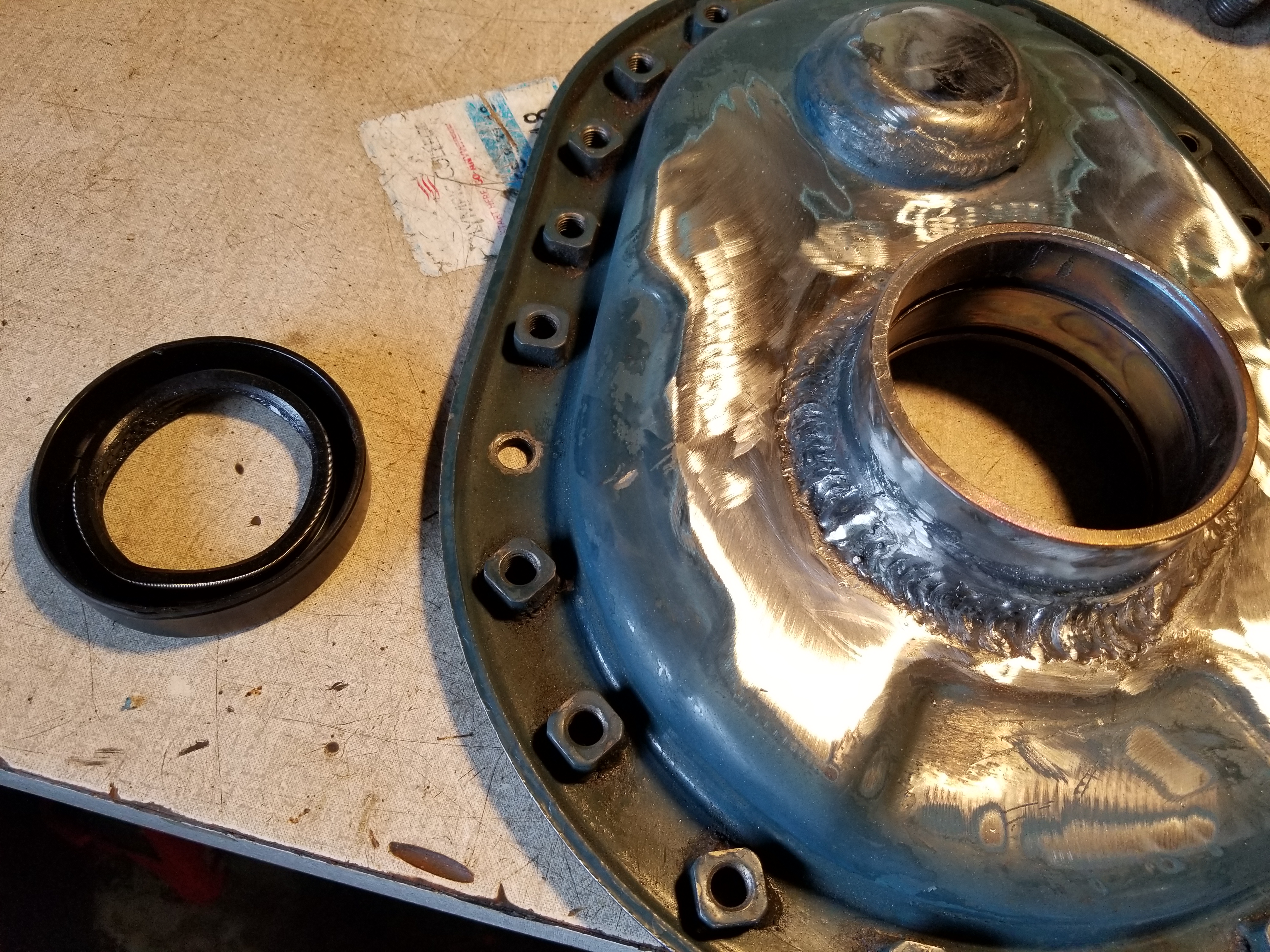

I think I'm just going to start welding these plates when I get a L245 in the shop!
Seems to be the left axle that leaks. Haven't had a right one yet (this is only my second one though)
Sure wish I could just go to the local dealer and pick up a new seal!
