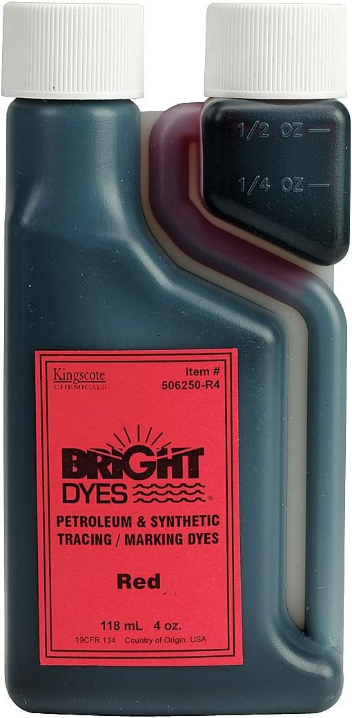

I just solved this issue with my Kubota M6111 (Dip stick). I purchased the Kingscote red dye. It is awesome. I also then immediately added it to my bush hog 3750 sight windows. my JD 6415, MY jd2030. my jd750, my bobcat udt and my oil compressor. In other words, anything with a sight window or a dipstick and it works great for both equally well. here is an amazon link (I think)

Ebay has it a bit cheaper. Have used the JD brand before will be trying this.

I have used the JD dye for years for the same reasons,just tell the dealer if they do any service.They had thought I had put automatic trans fluid in it!Helps to find any leaks also.
Agreed, prices go up and down all over, so shop it. keep in mind this stuff goes a long, long way. I purchased two bottles, not realizing that and it will be a lifetime supply for me, even with 5 tractors, 2 bush hogs, and a utv. (give or take a tractor or two). I am nowhere close to using half of my first bottle after using it on everything, including putting a drop on one of my two white twin barn cats' tails so I could tell them apart.

Yes a little goes a long way. Fortunately my tractor shed cats look nothing alike
