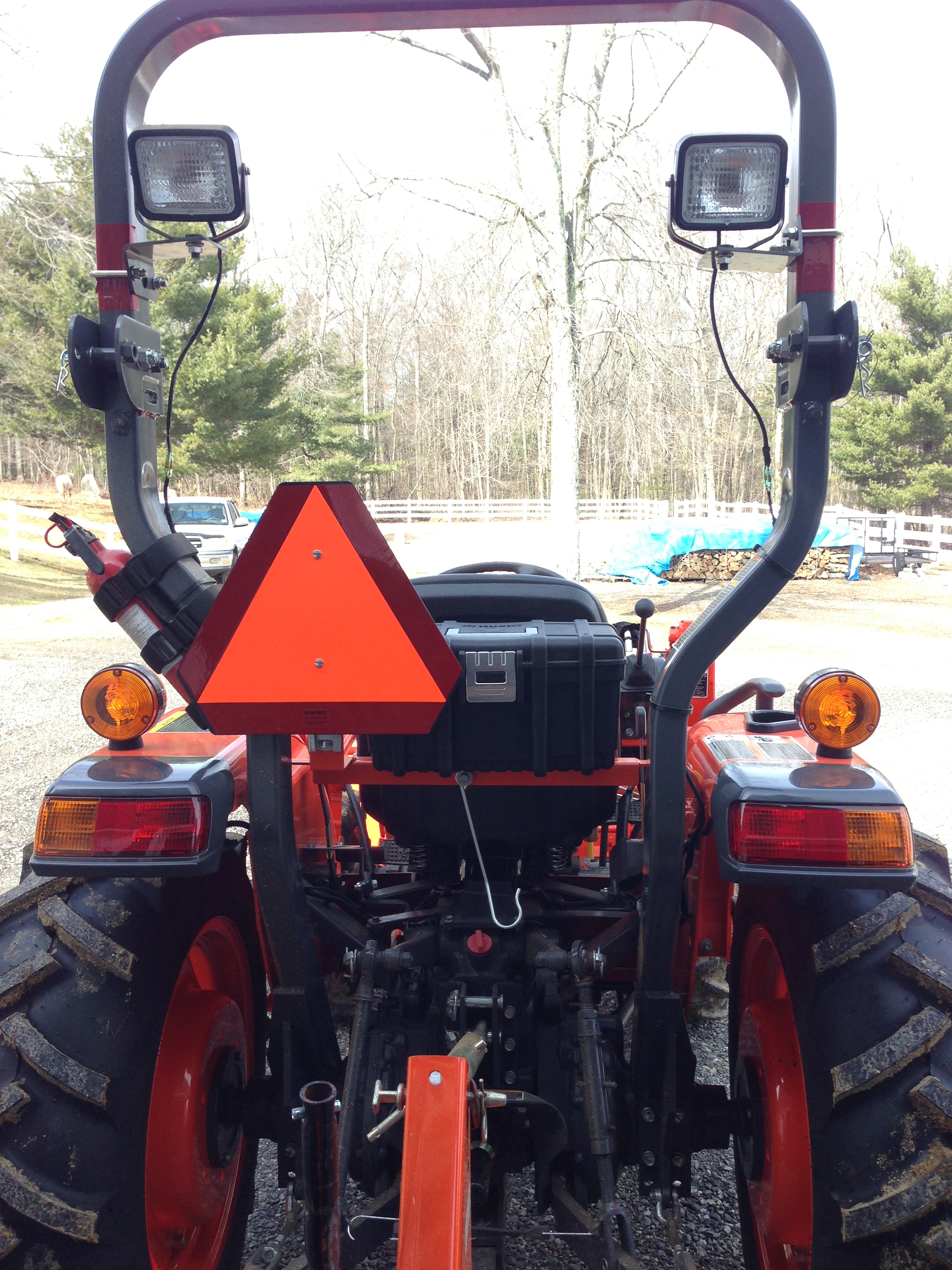

Thank you all so much. If/when I have the time I would like to add a couple of work lights under the roof I built.
   / L2501 extra light wires? #8
You definitely will not regret doing so. Mine come in handy when snow blowing and when backing into a dark barn after. toolbox.jpg
