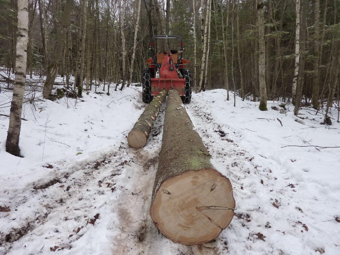

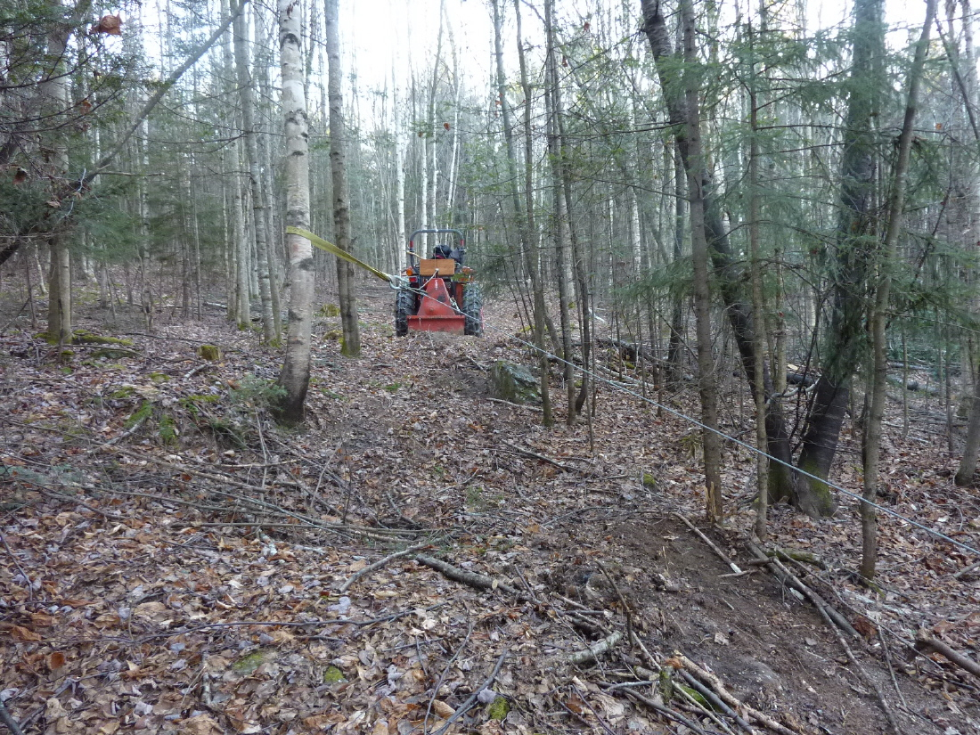

A winch is certainly the answer to getting hillside wood that is otherwise inaccessible. Here is my 6600 lb winch and 30 hp tractor. Look at the cable angle to get an idea of the steepness.
As others have said winches do not loose value. I paid $1700 for the Farmi JL290 new in 2001. Getting my money back would not be a problem and that is after it paid for itself already pulling wood out.

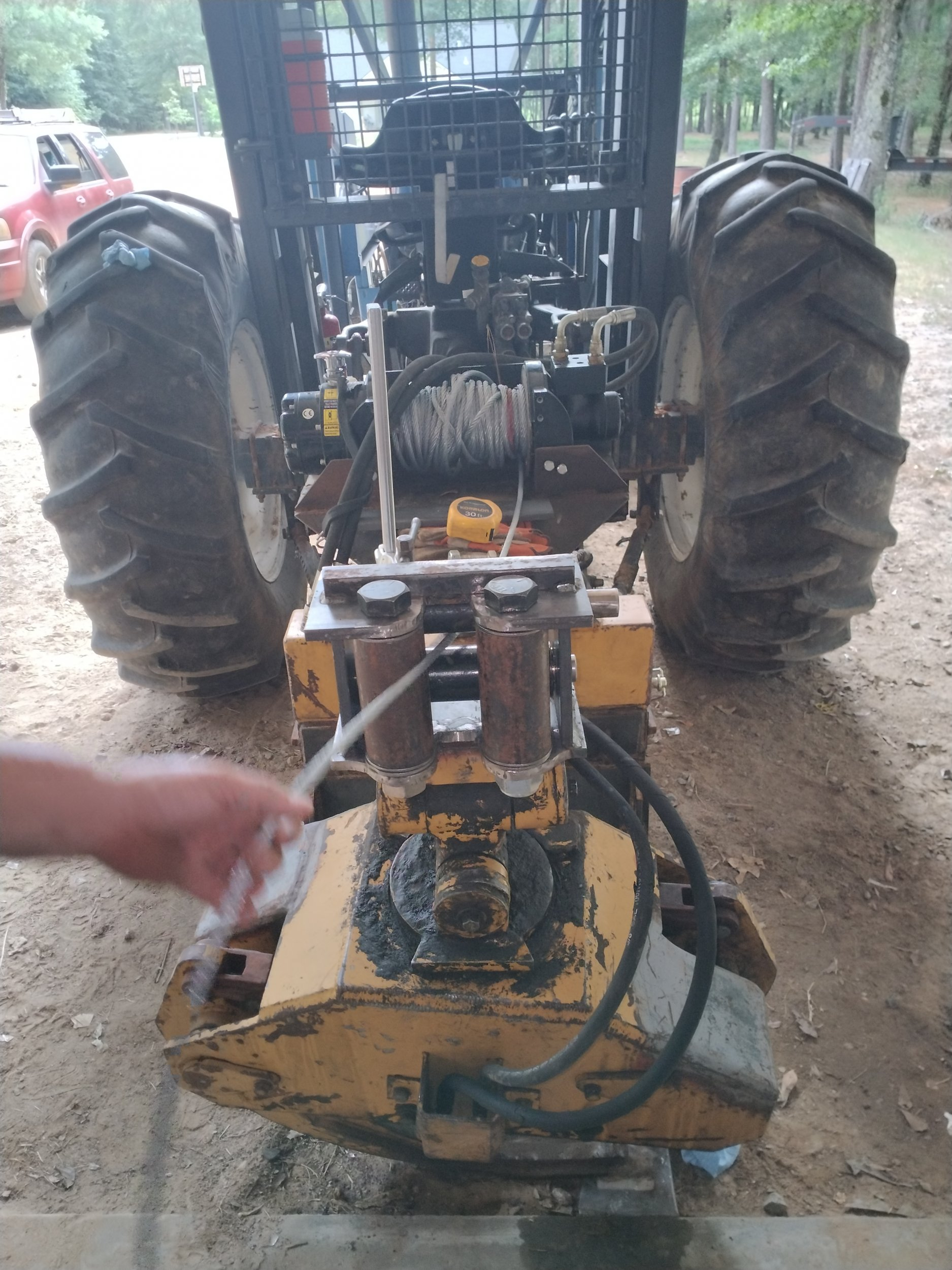

Keep in mind, a "recovery" winch, either electric or hydraulic is intended for intermittent use when vehicles ability to navigate on its own is compromised(?) ... A logging winch is meant for continuous duty as for work like extraction wood and maybe other uses.... Yes there is a difference in designed application/usage...
We bought winches for tow trucks and been using for years now. Hydraulic winch for a wrecker. I don't think it was any more expensive, if not cheaper, than electric. We made the fairlead, factory style did not hold up.

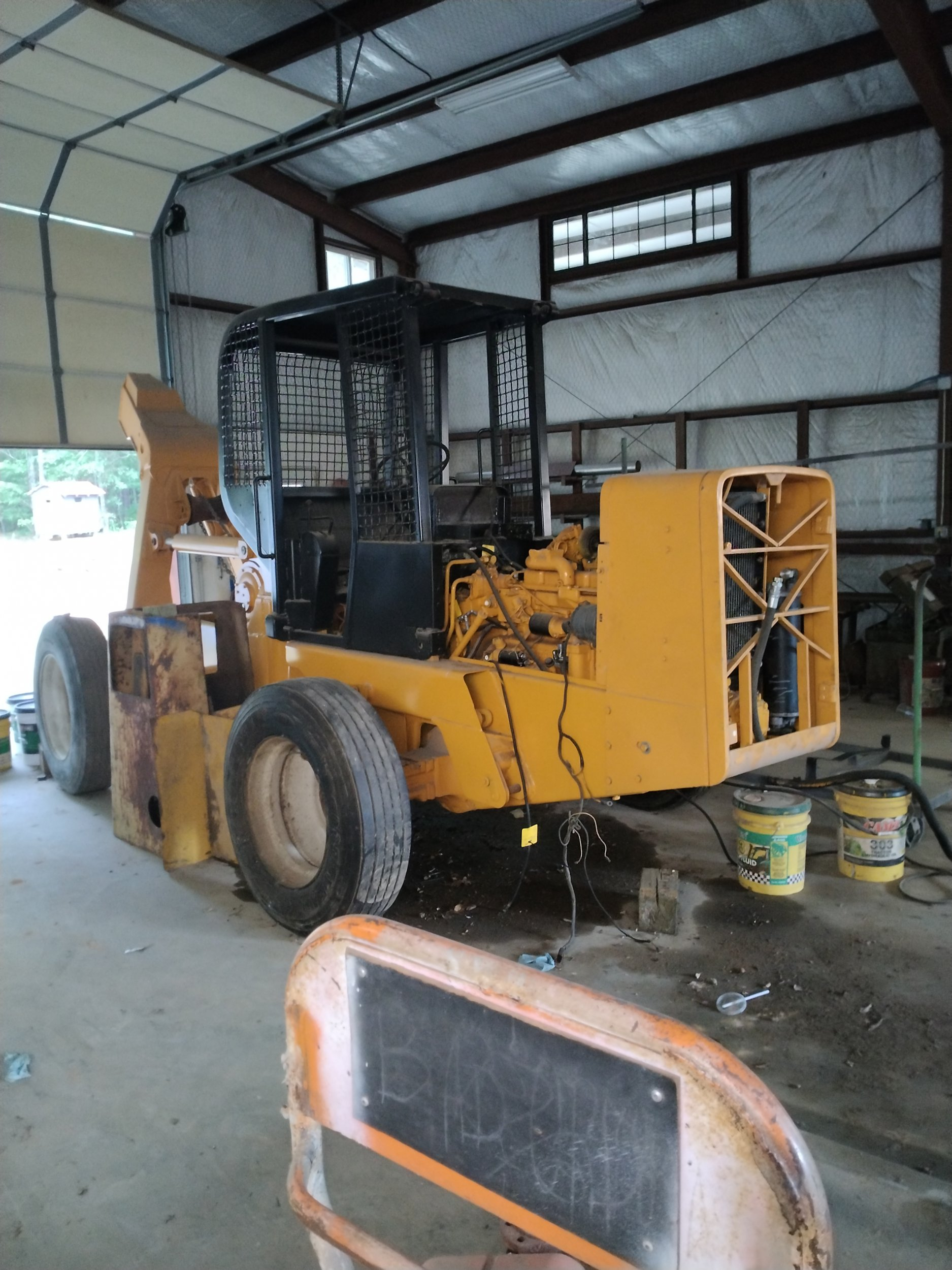

Well, since he never mentioned electric, and wanted hydraulic, he was probably going to end up with one anyway. My brother was wanting a winch to put on that grapple. I said nope, you want one for a wrecker. He found one I think in Texas. Also have a Farmi. I'd been on his case for a while about a winch. Now, he only uses a winch, no more grapple use. Chain chokers work best because the tractor doesn't have the height of a skidder. Which, we have a John Deere skidder also. But, we totally redid it and it's still in his shop. Took it down to the frame. Sandblasted painted whole thing. We have 18 wheeler wheels on it now. Bolt pattern is not the same. Number of holes not the same. But a few lug bolts lined up, and it's a lot easier to work around. I just cranked it for him last week. We went ahead and bought new shifter cables for it. Already had the old ones on, those were a pain to change. Rebuilt the transmission too. It's a little more together than in the pic.
