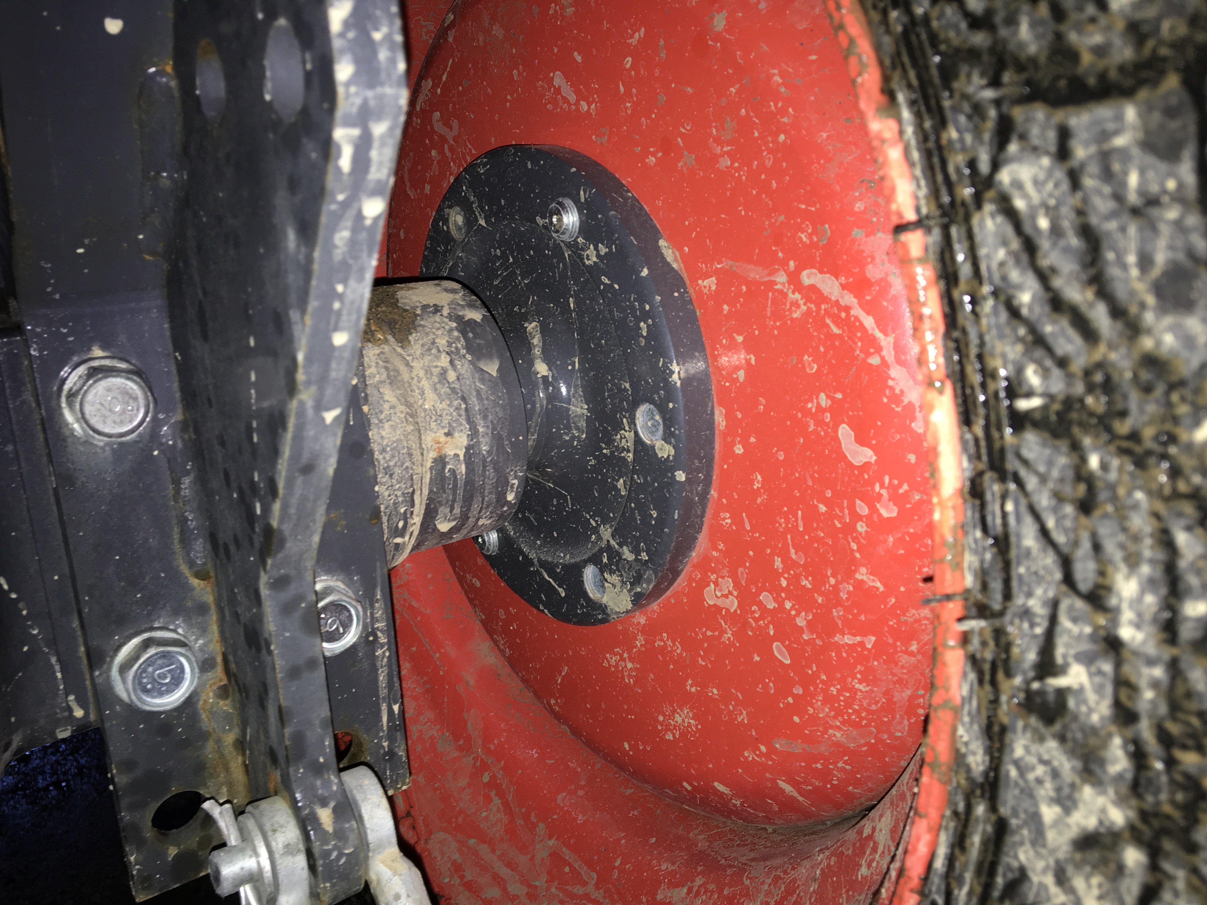

I have considered making my own wheel weights but as i said im new to tractors and unsure how this is usually done. My rims dont have any holes in them besides the ones for mounting the tire. So could i just acquire longer bolts and mount it with the tire. Also should i use all 6 bolts or maybe just 4?
Would mounting this way put extra stress on the axles?
Also wheel weights vs loaded tires, does either one have benefit over the other for less stress or wear on axles. Im going to be using the tractor on uneven ground acquiring firewood and logs so i know that loaded tires is lower to the ground so that would help with stability.
Any thoughts would be great! I will upload some pictures of the rims and mounting shortly.

#65
I could make easily fit a cylinder with 12" diameter and 12" depth.
So if i made them out of concrete i could get 118 pounds per tire, but i could pour them out of lead and get 555lbs per tire. I was thinking that i could leave 2 bolts in the tire and add threaded rod in place of the other 4 and just tighten them with a nut and then make lead plates that could slide on the threaded rod and be tighten down.
So if i load my tires with 220lbs per tire and then add wheel weights, how much could i add per tire without causing stress or damage to the tires or tractors?
