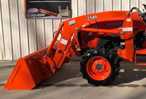

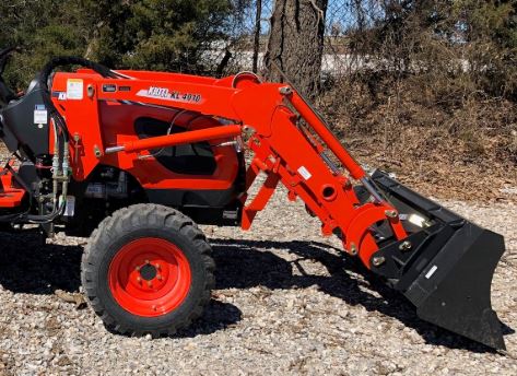

Here are side by side comparisons of the loaders. I think the Kioti loader would be a 4030, but that is close enough to the 4010 in the picture. Not sure how to make the pics bigger.

View attachment 575264View attachment 575265
I'd say that they seem very close in design. No clear winner and loser.
Overall I might have a slight preference for the 2545 as that loader seems to be tucked closer to the front of the tractor. Also, I find the 2545's particular triangular shape of bucket easier & intuitive to use compared to a round back. That triangular shape bucket also holds more for me when I'm hand-loading firewood or using the bucket for a workbench because it has a larger workspace flat workspace than a round back bucket. Both loaders seem to be well mounted to the tractor, but there again I'd give the nod to the 2545.
Is that the loader the Kubota dealer is selling on the L2501 you're looking at? I may have missed where it was mentioned, but why is the dealer putting an Ansung loader on the Kubota over the factory Kubota LA525 loader?

I thought that was the LA525 loader. I overlooked the number on the loader arm. Guess i though it was for a rental fleet number or something else.
