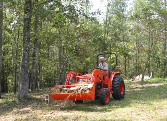

What do you mean by shudder, I just got my tractor 5 days ago, and I have notice it goes down real smooth but when raising it bounces a little, is that common? I haven't contacted my dealer yet, to ask, but let me know what I should look out for on a new tractor. Also... How much noise is common on the HST /forums/images/graemlins/confused.gif it is a pretty lound windding noise, I have notice a little louder with 4wd engaged.
Thanks,
Stephen
   / L2800/3400 lift shudder #13
The bounce going up is the issue. The new valve helps smooth that out. If your bounce is about an inch you have the old valve.
The whine will improve a bit with age but is normal for hydraulics. Running the engine at PTO speed reduces the whine on my L3400.
