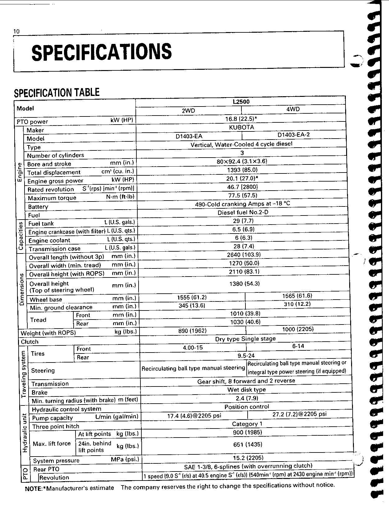

Beware of some L2900 owners manuals. I have a 1996 L2900 and the owners manual specifies the oil capacity w/filter is 3.5 Liter or about 3.8 quarts which is an error in the manual. It holds 5.8 quarts of oil. My kubota L2900 is now having a new engine installed at the tune of $6000.00 because of my reliance on the manual. The 3.8 quarts will show in the operating range on the dip stick but was not enough to get sufficent oil to the second and third piston when the engine was in a strane.
   / L2900 Owners #9
WOW that sucks. What does kubota say? Did they supplement the manual? My L2500 says 6.9qts. Here is the spec page from the manual.
   / L2900 Owners #10
I have the L3000 DT and the manual states 5.8 qts. of oil including oil filter and when I changed oil and filter I put in 6 qts of oil and ran the engine for about 5 minutes and checked the oil level after a few minutes, I had to drain about a 1/2 quart. I don't think the manuals are exactly right on the capacities of the fluids.
