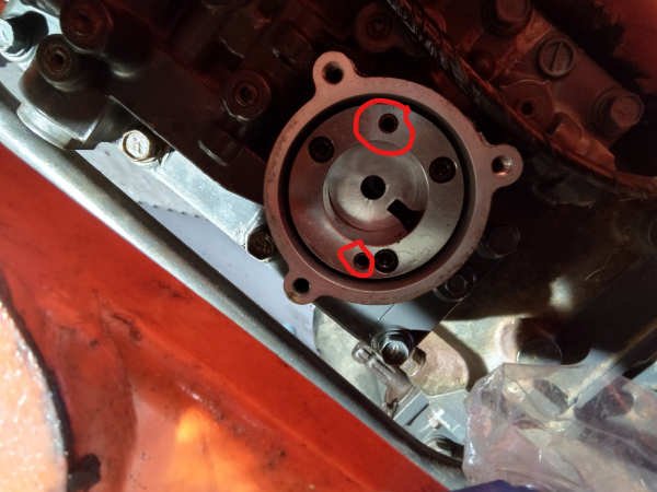

Does anybody know how to re-assemble the rotary valve without the two indent balls falling out? It is killing me. Here is a picture with the springs. The balls are supposed to stay on the springs somehow while you insert the indent plate. I have no idea how.
Try some assembly grease . It’s thick ,and sort of waxy . It’s designed to hold things like springs ,ball bearings ,etc in place while assembling an item . It resolves with a little heat .
