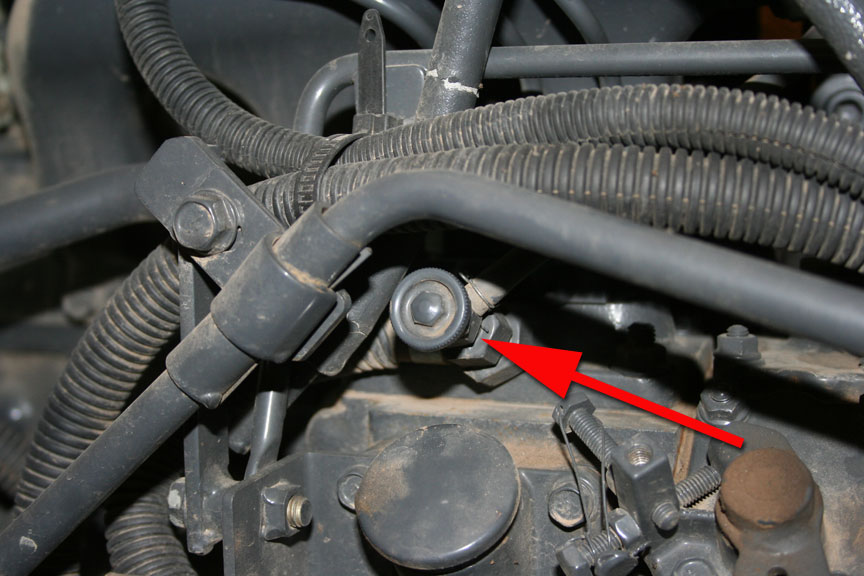

Today, I replaced my fuel filter and when I went to open the air vent screw to bleed the fuel system I think it was left open. Is the vent screw open or closed when the screw is completely turned counter clockwise? Thanks Steve.

Can't remember, it's just like on my tractor. Manual says it will run rough if it stays open. I'd think it open when counterclockwise, but am not at tractor or manual at this time to check...maybe somebody else is.

Workshop manual seems to indicate "clockwise" to close ...see attached picture

clockwise is closed. manual says to run motor for 30 sec with open, then turn off motor, and close valve(clockwise).

Yeah, and even after you close it the things runs rough for a few minutes. I don't bother messing with the bleeder screws most of the time any more - seems to work better just changing the filter out and firing it up again.
Just don't make the mistake of trying to run the motor with no filter installed. :eek: Running the lines completely dry is no picnic to remedy... :p

I am looking for some help on getting a part number for the fuel bleeder pictured in the first picture with the red arrow.
I have a Kubota engine Model # V2003T, it's out of a Thomas skid steer.
I changed my fuel filter and when I went to crack the vent it was tight so I took a pair of pliers and ended up twisting off the knob. I could still use it with just the brass stem sticking out but want it replaced.
Thanks for any help and sorry if this is the wrong way to go about it.
/ L3130 Bleeding Fuel System #11
The L3130 parts diagram that I have says .
14311-60504 ASSY COCK JET START
You can go to Messicks and have them email you parts diagrams for tractors.
