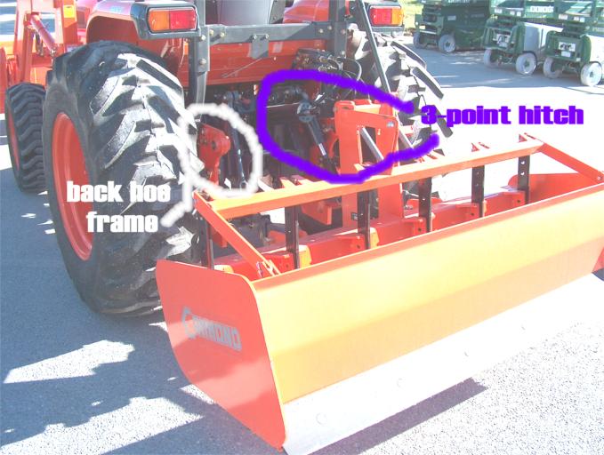

I can advise you only on the Kubota. If you go with the frame mount BH90 (the best) you can easily take the back hoe on and off and it uses the tractor's hydraulics not the tractor’s PTO to power the back hoe hydraulics. You can have the 3 point hitch on with the back hoe frame mounted. Therefore you can attach a landscape rake and rear mower without taking off the back hoe frame. When you put the back hoe on the only part of the 3 point hitch you have to take off is the top link and the sway bars I’m not 100% sure, but I think you cannot have a mid mount mower with the back hoe frame attached (I just have the rear mower). With the back hoe frame on all the time you do get that extra low weight for stabilization. You might want to operate each tractor’s back hoe before you decide. Also if the 3130’s total comes to less than the 30K you might consider a 3830 or even a 4330. A front fork on the bucket would really make moving those logs easy if they are wider than the bucket. HST – everyone in the family will love it, especially you.
TXDon
   / L3130 or TC35 ? #13
Attachment shows the 3 point hitch attached to the box blade and the BH90 back hoe frame on the Kubota. No problem!
TXDon

From what I can see in the pic the subframe looks like the same thing I have for the Woods 9000 BH.
I only have to unbolt the stabilizer arms and hold them out of the way with a rubber strap before using the hoe. The same thing could be done with the top link but I just take it off since its' just as easy.
