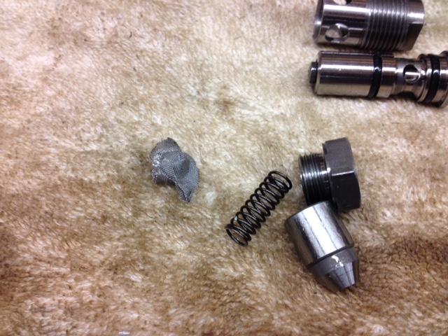

Haven't had a lot of time to work on it, so have been lax in spending "shop time". Did look at it yesterday and decided to take the cylinder relief valve apart as there seemed to have more noise than normal when trying to get the 3 point hitch to raise (like it was bypassing when it shouldn't). Counted the threads and unscrewed everything. Inside was spotless. Again while running the tractor, the hydraulic line from the front loader control block was warm to the rear 3 point hitch control block. Piped bypass from front control block to trans sump was cold, so it is not bypassing. Everything still points to the rear hydraulic control block is bypassing to the trans sump. So, I am at the point of pulling the 3 point hitch control block and trans cover and check that out. Thinking I might have a cut o-ring on the spool valve.... Or something like that. Kubota has special tooling to check hydraulic pressures with lines in place. Has to be a coincidence that this showed up after the servicing-I hope. Just been dragging my feet on tearing into the trans.

Great News! At least I think. Got up the courage to tear into the rear hydraulic control valve for my non-functional 3 point hitch on my L3130. Found a wadded up screen in one of the internal check valves in the rear hydraulic control valve. This screen was holding the check open and bypassing the control valve dumping fluid into the trans sump. Screen is not shown on the Kubota WSM exploded diagrams, but is shown on Messicks diagrams and not shown as a stock item. Since this is already in the hydraulic system after the filter, hydraulic pump, and front hydraulic control valve for loader, I would assume it is there just for safety? Have thoughts of just leaving it out.
Anyone care to comment?
Thanks,
David

Wow, it looks like you're on the right track now. I think you found the "smoking gun". I think that's pretty weird that it doesn't show up in the Kubota shop manual, but I've been disappointed with with the Thoroughness of the Kubota shop manual and parts manual, although they're better than nothing. I think this would be the time to get a ruling from a Kubota dealer, or maybe two, for a second opinion, on the screen. Knowing how close the tolerances are in the hydraulic system, and especially the HST, I wouldn't dare leave the screen out, from wherever it came from.
Good news!

Finally got it all back together (twice-once just for practice :). The rear hitch will work at an engine idle now. You probably can't see, but I am smiling ear to ear.... Was worried about what I might find once I got in there. Just kind of wondering if the screen should have been before the hydraulic filter instead of where it was. It is kind of coarse for hydraulic use. It was located in a recess on the incoming hydraulic line where the rear hydraulic block attaches to the bottom of the trans cover. The only thing holding it in was an o-ring! Glad I took the plunge and jumped into it. Kind of wonder how many kubota owners could have this issue in the future?

Man, what an ordeal, but all's well that ends well. I went back to your original post to see that you bought the tractor new, so it seems like that screen must have been in it all along. I'd still want to figure out where it's supposed to be. You deserve a lot of credit for tracking it down, and it was a good excuse to get the WSM, at least. Congratulations!
