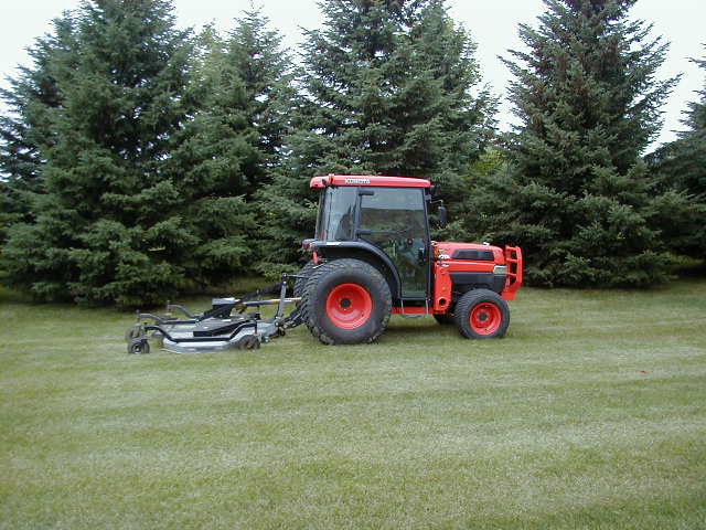

I can't say much for the NH tractor, except that I had a NH tractor (different model) before I purchased my Kubota Grand L3430 (bigger brother to the 3130). It was an OK tractor but not in the league of the Kubota. The Kubota runs quieter and smoother, takes less fuel, better hydraulics, a hydrostatic transmission second to none, great ergonomics, a 723 loader with the skidsteer quick attach that is worth its weight in gold, and a fantastic cab.
Don't worry about the 3130 being too heavy for finish mowing. My 3430 handles a 90" RFM and treads so lightly on the lawn that its almost impossible to see where it has gone. See the attached picture. As you can see, I have the large turf tires on my tractor. I love them. I have had absolutely no traction problems in snow, dirt, fields (2 bottom plow and 7 1/2 ft field cultivator) and wet grass on slopes.
Both are good tractors but the Grand L Series Kubota's are tough to beat. If you can get the 3130 for the same price, that's the one I would go for.
