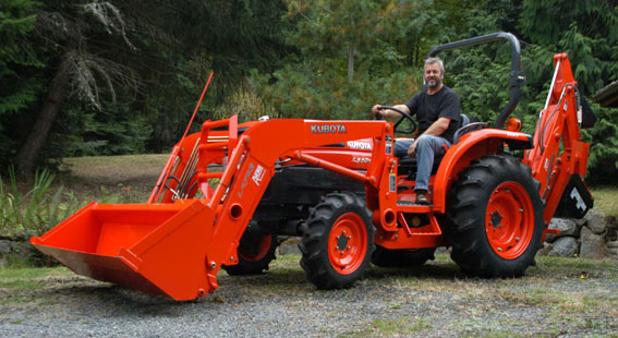

Here's a shot of my L3130 with Fel and BH.
