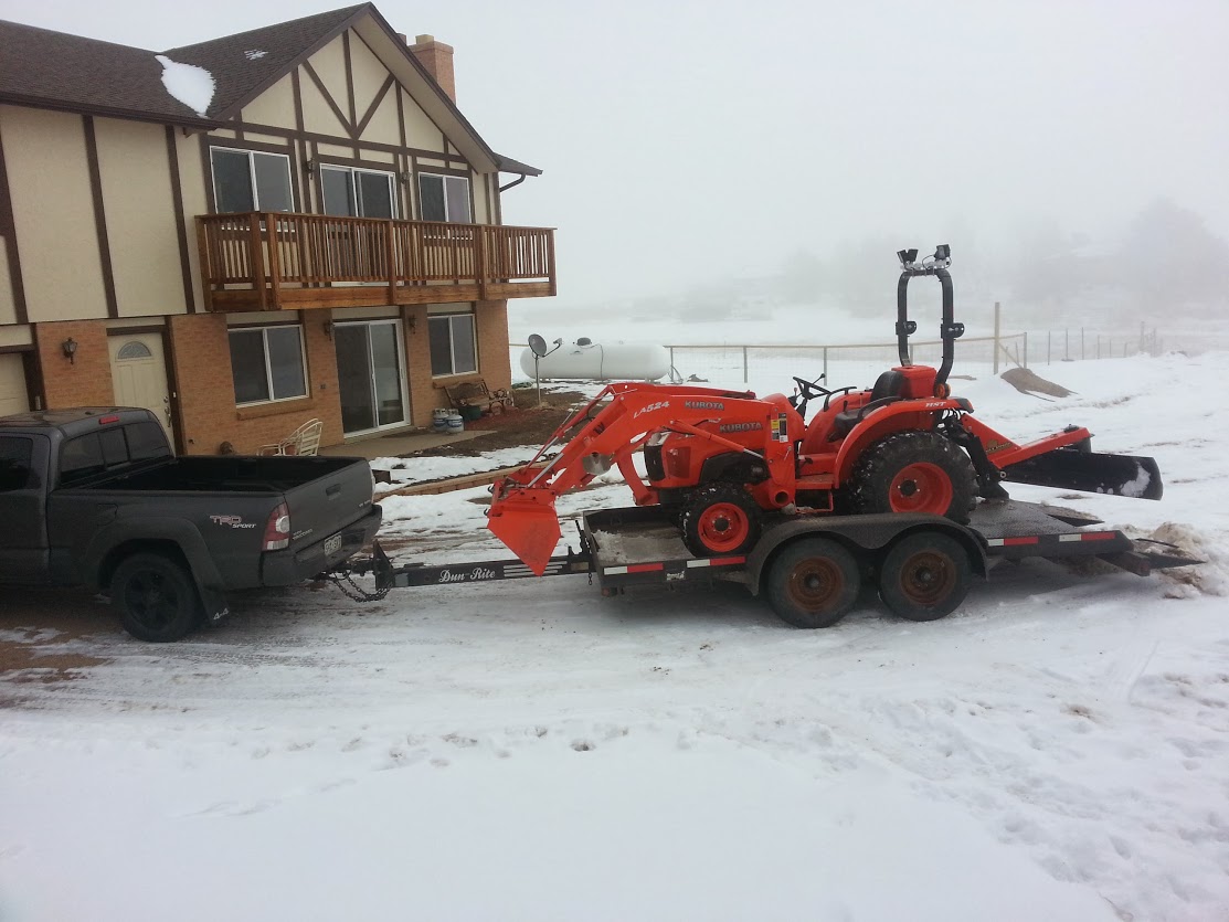

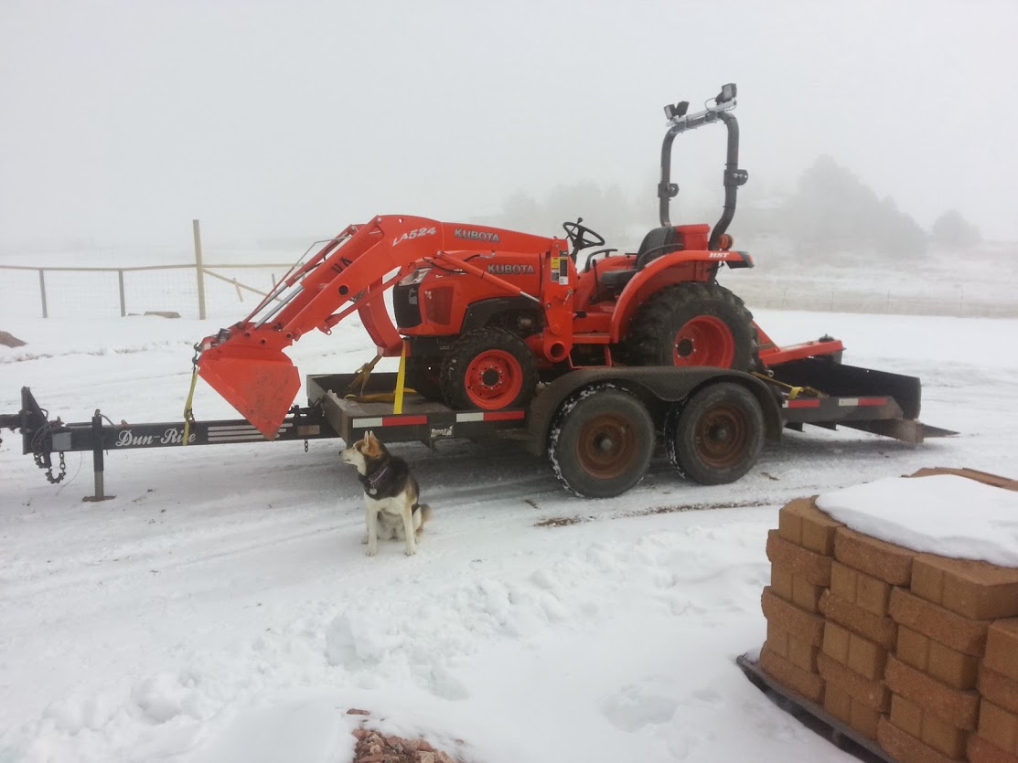

I have a 16' tilting deck trailer. Got it cheap at an auction. 15k lbs rated with a metal deck. I could stack 3 of my L3200s on there and still be good on weight. However 1 barely fits on there. I have to hang the loader off the deck onto the very long neck. Luckily things balance out, as I really don't have any room to move it to balance things. My rotary cutter ends up hanging a foot off the back. My Tacoma will pull this setup, barely. Its rated to haul 6,500lbs & I figure the trailer is a bit over 2k; tractor, loaded rears & loader are a little over 3,500 + 5-700lbs for an implement... HP, brakes & suspension are all hitting their limits, so I ended up finally picking up a F250 for a beater farm truck.
I keep thinking about upgrading to a 20 or 22 footer. No way you should get anything under a 18.
P.S. I use chain now, the front strap got really chewed up from the corners on the brush guard being "sharp". No way sharp by my definition in any shape or form, but enough to start cutting those straps. Photos are from test fitting things after I picked up the trailer, didn't actually haul it anywhere other than around the block.
