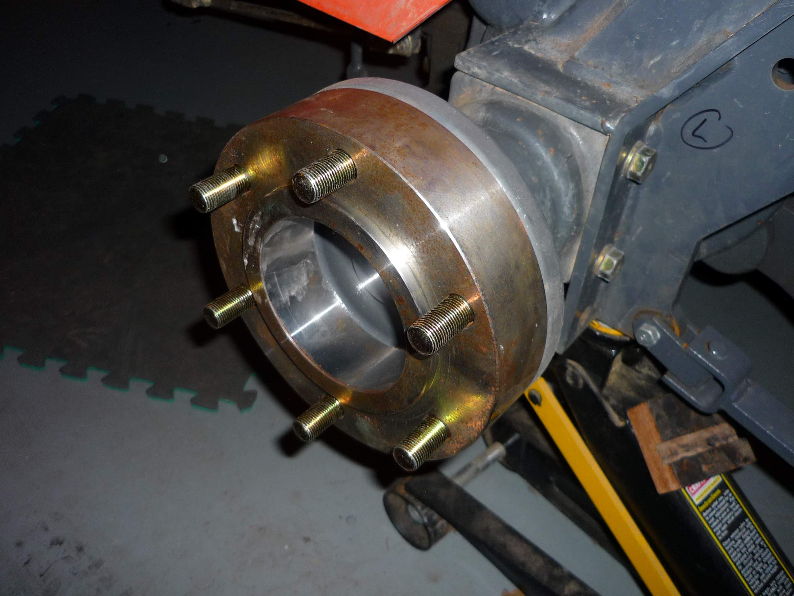

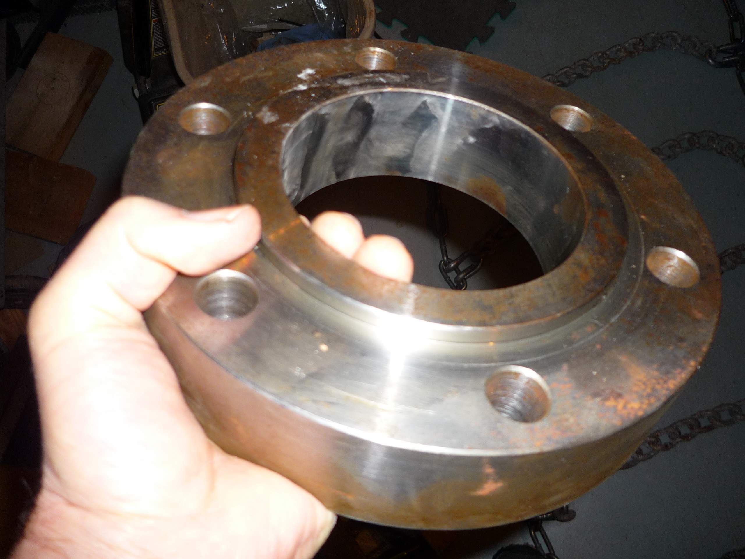

I can tell you that the Kubota spacers for the L3400 I got were 1.75", and I think they listed for $220 or so, with the studs, but not the required nuts (which I found I could order thru Home Depot (!) very cheaply. I found them, new, for $160 on Craig's List from an ex-Kubota dealer who was clearing out his odds and ends. I like the fact they add some weight, unlike the aluminum ones.

<img src="http://www.tractorbynet.com/forums/files/kubota-owning-operating/442499-l3200-spacers-p1010765-jpg"/>
Have you noticed any increase in stability?

Guys, the $220 list (I am guessing that what he said it was) was for the pair, with 12 studs- it may have originally included the needed nuts, too, but the bag was open, and the price was right. I installed them myself, but then, my rears are not loaded, so rolling and muscling them are not a big deal. Getting the 4 old studs out was a pain, using double nuts and a bit 'o heat on one or two. Nothing damaged, but that was the hardest part. That, and finding the M16 1.25 (or whatever they were?) nuts. Like I said, you can order them for cheap via Home Depot, grade 8.8 even, but I was in a hurry. Got a couple nuts just to have as spares.
