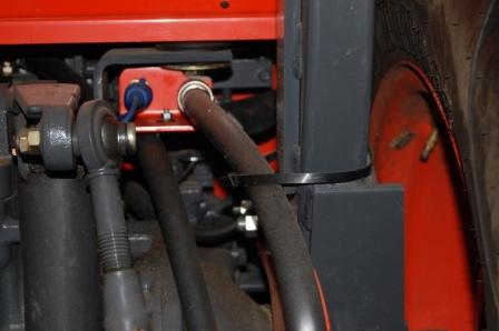

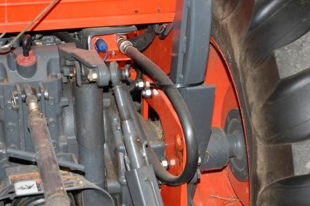

I have a large zip tie permanently attached (loosely) to the back that I loop the hydro hose through before it connects back to the tractor. It keeps it tight to the right side so the 3 point doesn't bite it.

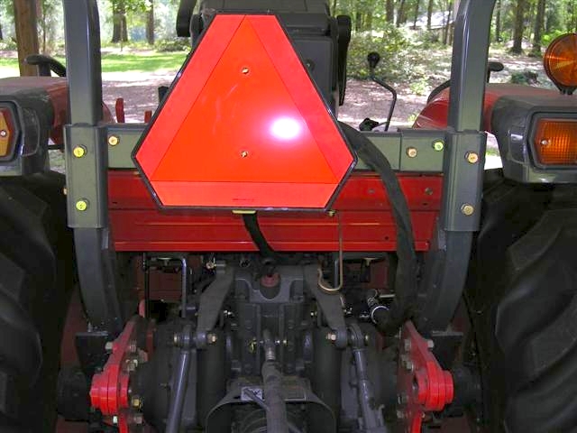

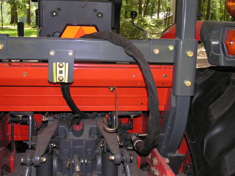

I simply loop the longer hose over the lower ROPS brace...

WOW :eek: thats one long hose. Mine is much shorter. I actually have a zip tie on the right side rops support and loop it through that....picture tomorrow.

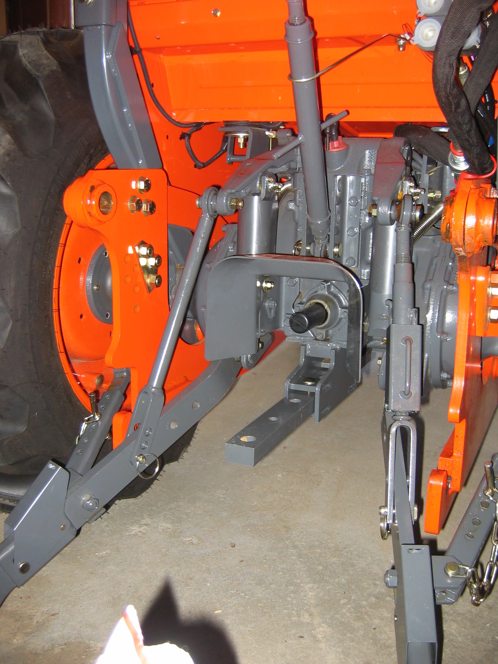

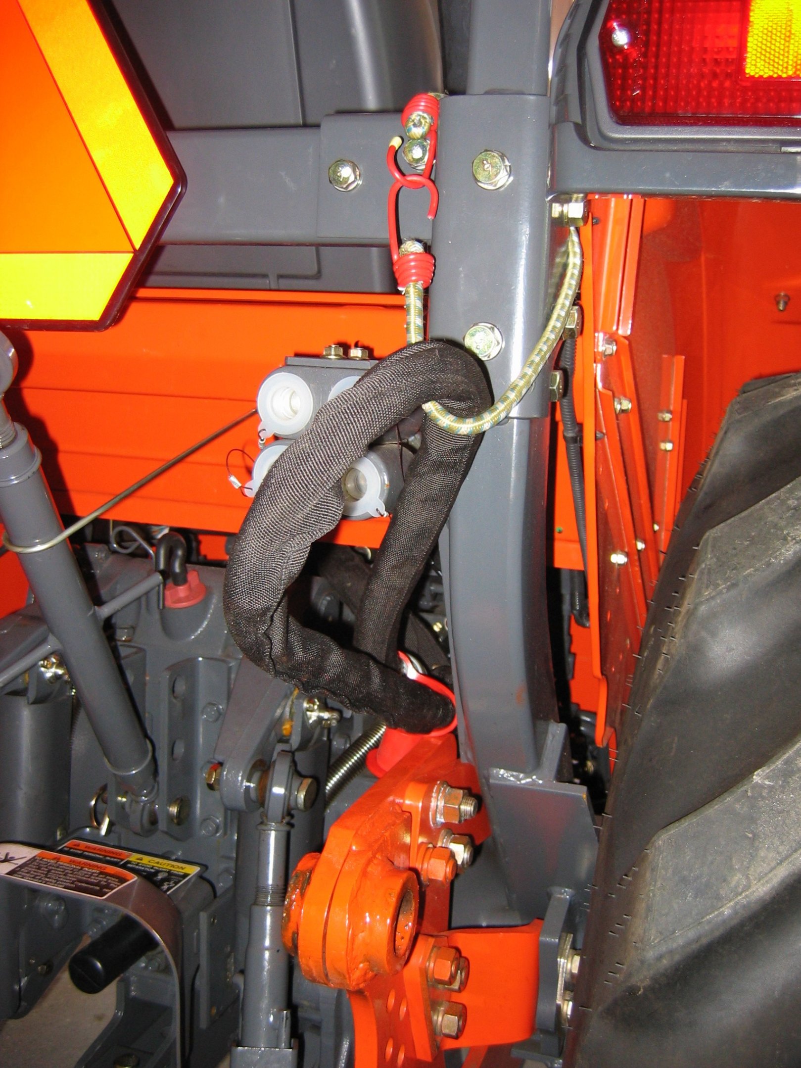

My rear hydraulic hose isn't that long either, heres a picture. Currently using a
bungie to hold it away from danger :D

Phil, After looking at your pictures some more I now know why your rear hyraulic hose is longer. My hose is routed under that gold flang hook that is to the right top side of the hydraulic coupler. Your hose is routed straight out above the hydraulic fill plug.
