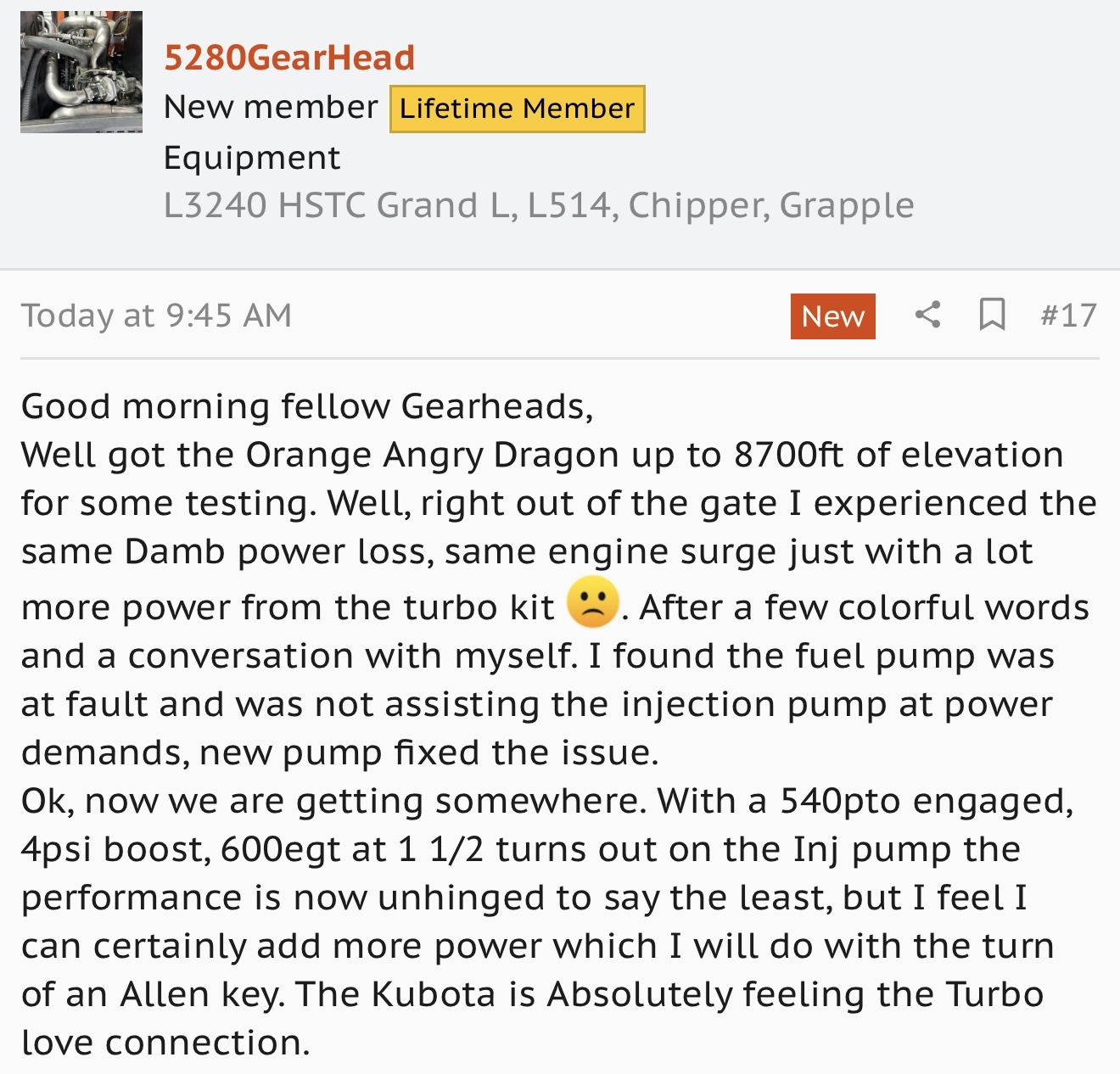

The folks that go with the Turbo Kit are incredibly happy (especially those operating in high elevations).
The Turbo Kit isn’t for everyone but, for those that want a significant boost in power and an easy bolt-on installation, it’s a fantastic option.
