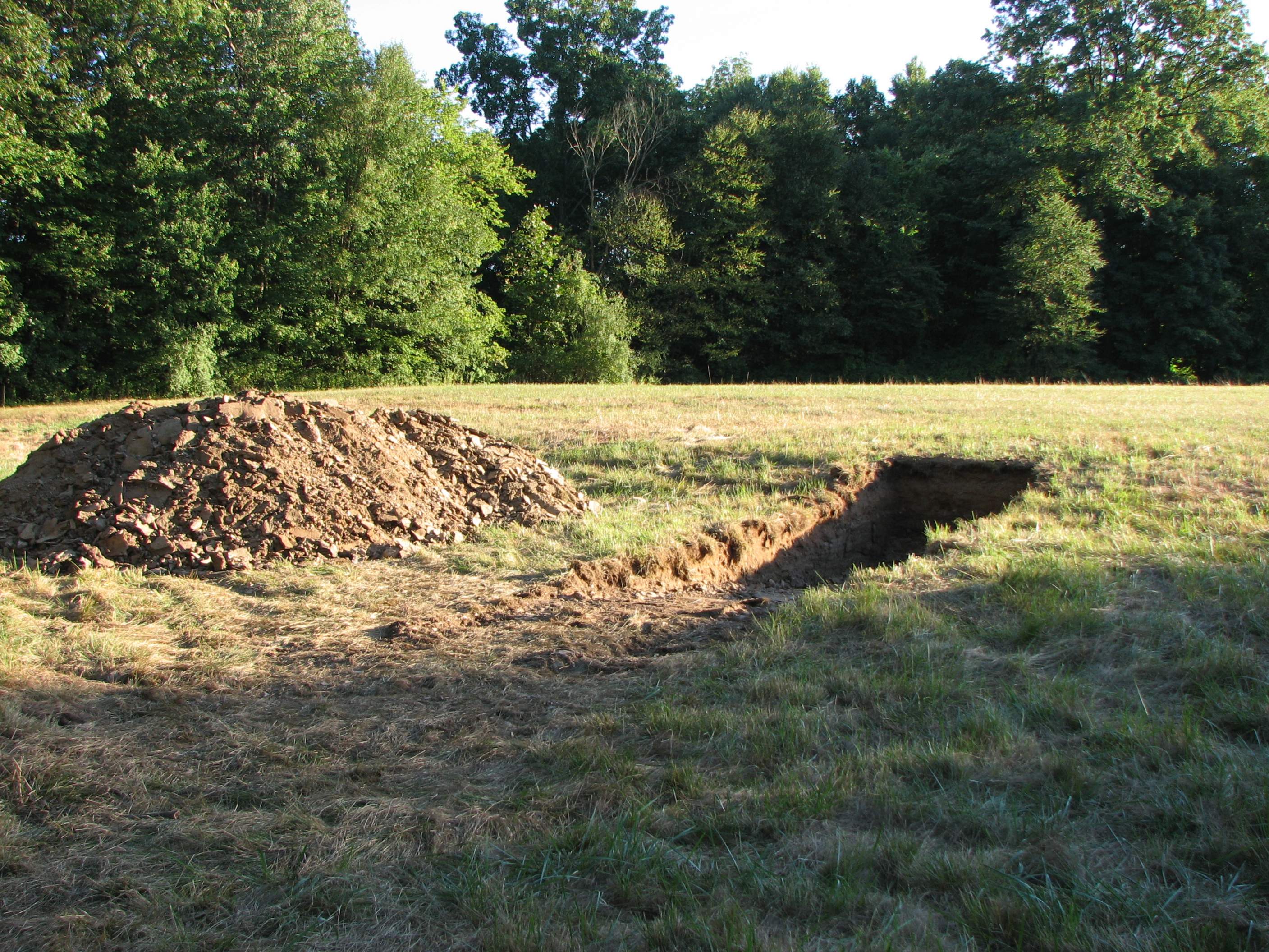

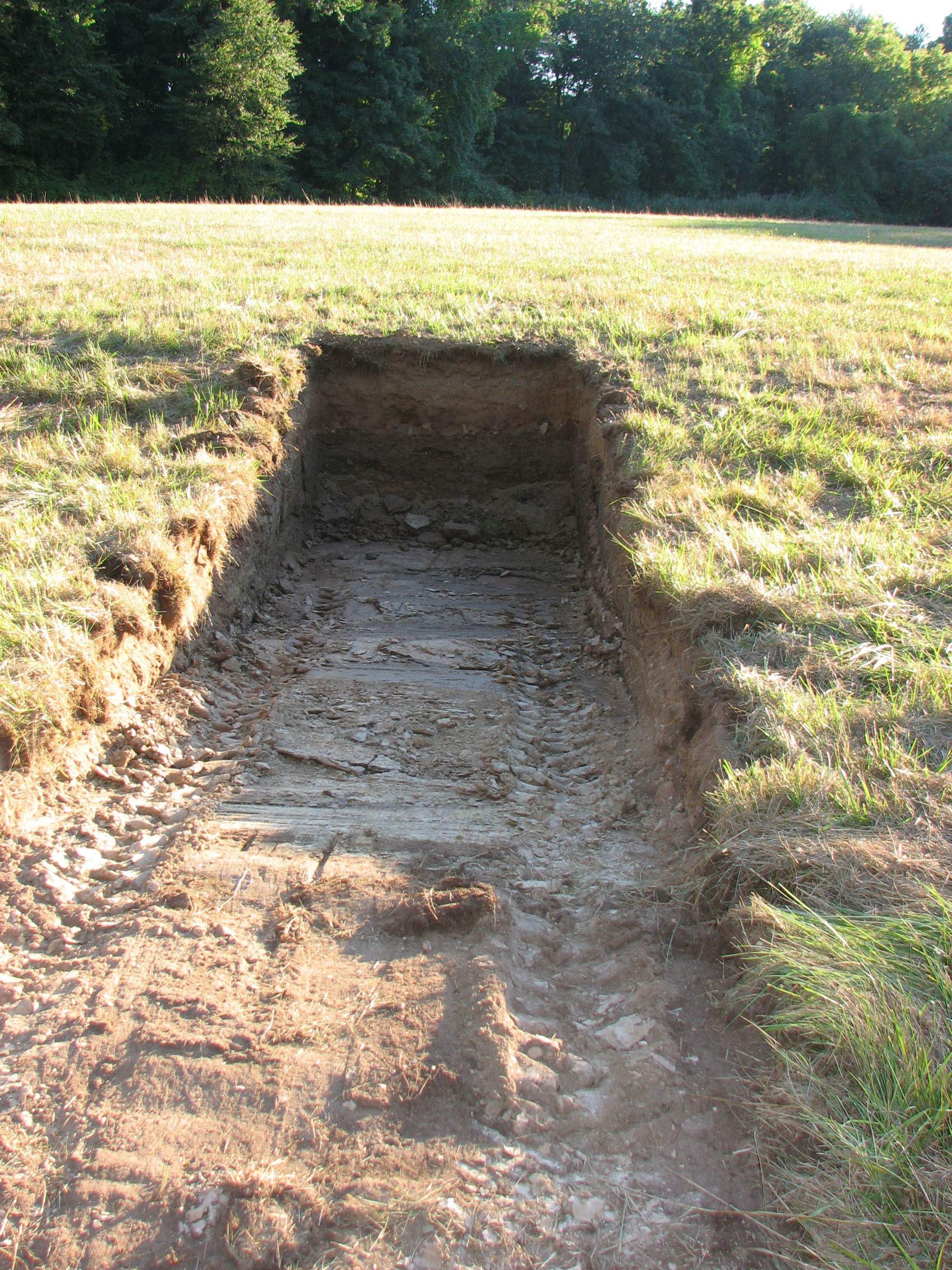

I have had some success digging with mine, even without the toothbar. With just the loader on the L3240 I'm weighing in at about 5000# if I were to add a 1k rear ballast eye and load the tires I'd probably be within spitting range of 7k. Now I need to come clean on what I've been digging - there's no rocks here, just loam on top of solid, damp, consolidated clay. Having the bucket wider than the rear wheels helps.
Well I guess those pictures proves the point that the L3240 can dig with a 72" bucket, It has the weight, what a beast!:thumbsup::thumbsup::thumbsup:

My L3830 is 72" wide...outside tire to outside tire. I have a 72" bucket. When clearing and pushing, it is good to clear the way for the width of the tractor. That way, you aren't driving over the debris your bucket missed since it was not wide enough. Also, when back dragging and smoothing out a surface, your tire tracks are covered.
Looking at Baby Grand's pic, you would have a harder time, and more time spent getting in that hole with a narrower bucket than the tractor's width since you would have to work on either edge to get on down in there..
