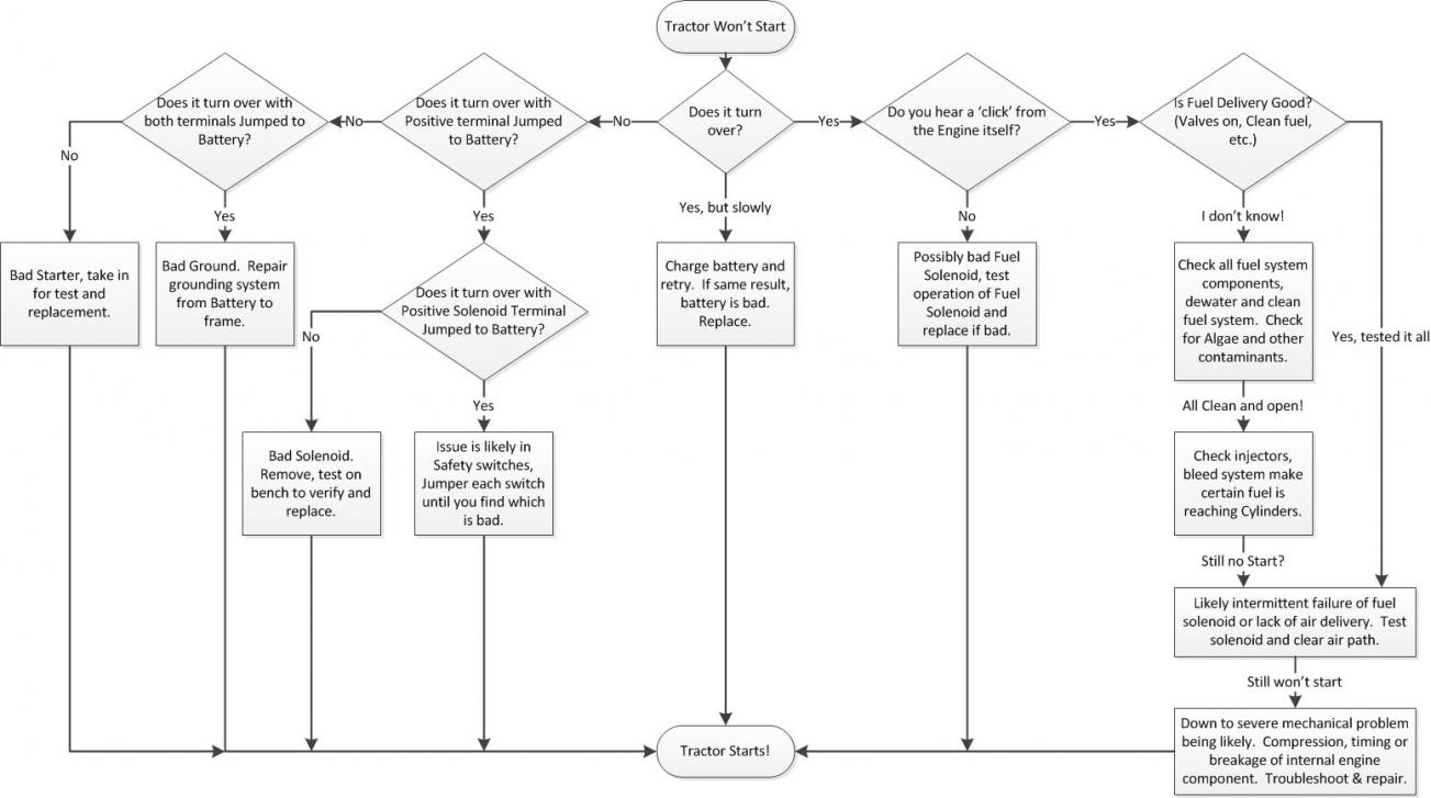

I am not convinced it was the seat switch. I unplugged it and tested it for continuity and it passed. I also got the weird situation where the engine stopped while not in motion when I got up out of the seat and the no start situation persisted. It only went away after driving around for 15 minutes and now everything is fine. Who knows? Thanks for your help! Found the attached no start troubleshooting chart Rob

With the ignition/safety switch by-pass test you did, I do not believe you currently have a starter problem. It seems like you said it engaged readily and strong. Starter sounds like it is fine. Yes you had a no start condition in this test, but that is to be expected with the key off.
If memory serves correctly, prior to this test, you had a no crank issue (starter did not engage no turning of starter or of engine). This condition-no crank-is a failure of sufficient voltage through the ignition/safety switch system to engage the starter. This is usually with this system a non reaction—starter behaves as if key was never turned. No voltage going to solenoid.
The classic symptom of low voltage is a dragging starter or click depending on how low the voltage is.
If this returns an you can not find the issue, purchase a remote starter switch, this will more safely do the screwdriver part. You can be in the seat and make the jump using this switch. This is not intended to be a permanent fix, but does allow 1 person to do this safely.

I think you are correct that there is no issue with the starter. I actually made my own remote
starter with s couple of alligator clips and an old spst push button switch. In addition I found out that
the tractor will stop when you are not moving and get out of the seat when you are in neutral, which
explains what happened to me
Also found this on a similar thread on Orange tractor. Some very useful info on L series not starting
<<First is the hourmeter showing any codes (P0606, etc)? If so, call the dealer. There isn't much you can do to them beyond basic stuff...everything else, requires kubota software and hardware.
No codes? Ok do this......
with the key OFF, hold down both of the buttons on the left side of the dash, both at the same time...for a few seconds. Then turn the key on. Look at your hourmeter it should say "A". Let off of those two buttons now. Now, push and hold the RIGHT button, and you'll hear a beep and the hourmeter lcd should show something like 1:(with a number following 1:). Pay no attention to that, when you see 1: let off the right button and don't touch it no more. At this point you can AUDIBLY test every single safety switch's operation. They are all on-off switches. HST pedal switch. Move the pedal forward from neutral and you should hear a beep. Let it return to neutral and once it hits neutral you will hear a beep again. Repeat for reverse, then let it return to neutral, should beep. That lets you know the hst neutral switch is working properly. NO beep? Switch wire is off or switch is bad (two likeliest issues). Repeat for pto switch. engine off for all of the tests. Turn the pto "on" you outta hear a beep. Turn it off and it outta beep again. NO beeps, your pto switch is not sensing an on or off condition check wiring and check the switch to make sure one of them didn't fall off. Repeat again for hi-low range or forward-reverse shifter. Outta beep when it comes out of neutral. Repeat again for seat switch, outta beep when ou get out of the seat. Only other switch would be for parking brake and it is not on the start circuit. Neither is the seat switch. It should at least crank over regardless of whether you're on the seat or not. Once your done playing with the beeper and you have isolated your issue, turn the key off and fix your issue. When you restart, the hourmeter will return to normal.
