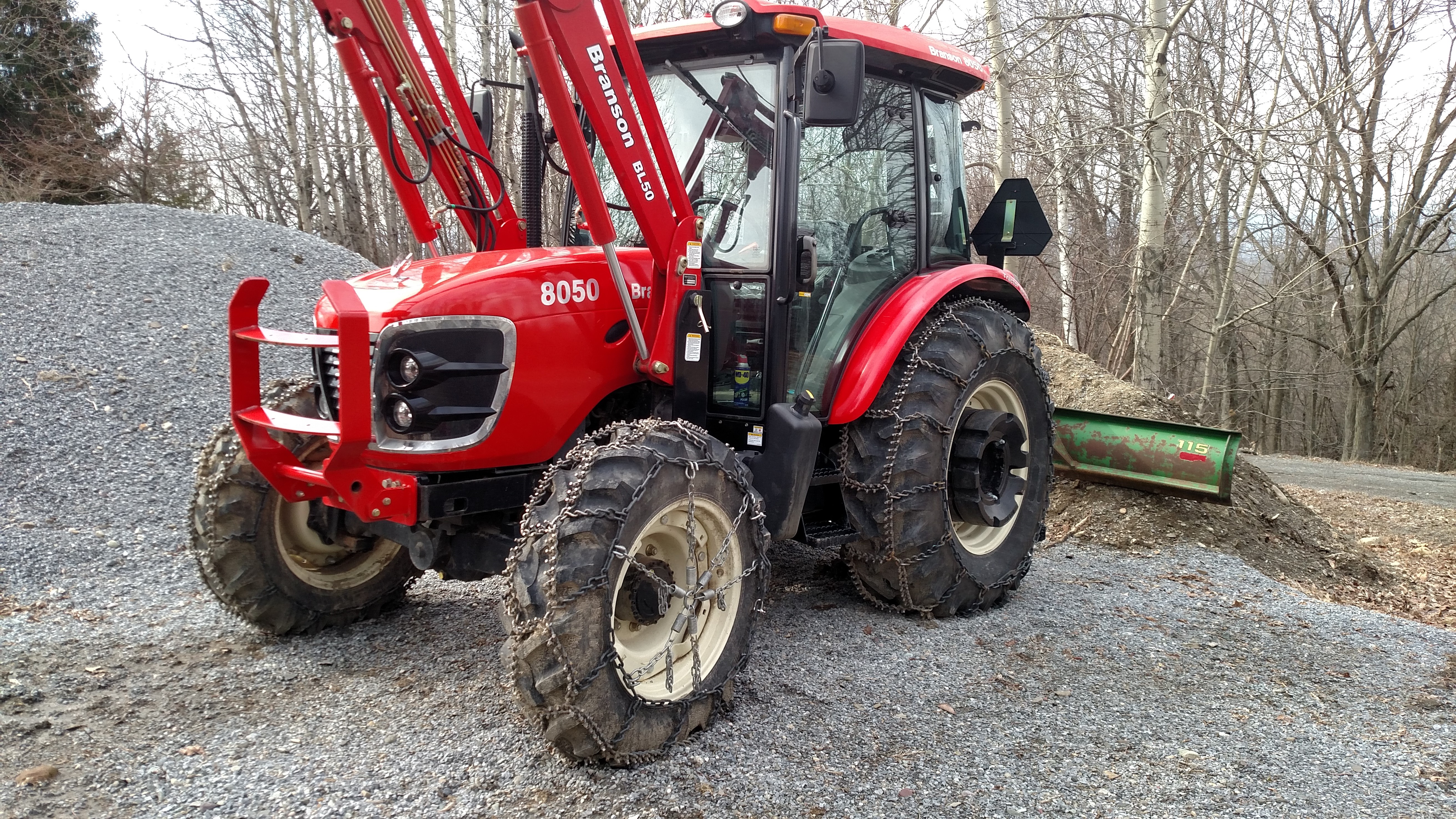

Need suggestions on correct chains. Have r4 tires and cannot get enough traction to plow. Granted 24" of heavy snow is a problem, had a 30 year old tractor before with r1 tires a d never a problem plowing. Pretty disappointed in lack of traction.

I have both front & rear chains for my R4s. I got the rear chains just after getting the tractor over 2 years ago. Finally needed em this year & got motivated to put em on. Only to confirm what I'd figured out by then & as others have posted... They won't fit without spacers. The R4s aren't adjustable & are to close to the fenders.
I picked up a set of 2 link Vbars from tirechains.com for my fronts. Those kick *** & I can finally steers while plowing. They kick enough *** I'm no longer thinking about spacers or trying to get chains on the rear. I'm happy with my width & have no stability issues, so spacers would make it less maneuverable & the only benefit would be chains. Also I have a 61" blower on the 3pt & the R4s have a 60" track...

I like Fallon's idea of V-bar chains on the front. They'll be cheaper than rears and two steering becomes a real problem plowing with a front blade or bucket.
These chains Aquiline Tire Chains work well on my R4 tires with 2" of clearance between the fender and sidewall of the tire but steering is still a problem on a side hill unless I ride a brake which I dislike doing.

I am thinking about chains for the front of my L3200 also. The rear blade can really "rudder" the tractor when moving heavy snow with a slippery base. The tractor doesn't run out of traction so much as it runs out of steering capability. So I think chains on the front would be a great improvement.

Both the front & rear plow would send me sideways with a similar push of snow. The front chains help a lot & I can now steer, but I'll still stall out on traction or go sideways on a big push.
I wanted some more gnarly chains, mesh or an H pattern, but they call my fronts lawnmower tires & only make ladders for them. Others make H pattern ones, but they are $300+ & I only paid $100 for my 2 link Vbars & tensioners I think. After seeing the traction I got I'm happy & wouldn't pay $75 to upgrade mine if I could. Some people wory about drivetrains strain running fronts only on a "front wheel assist" tractor. I think I'll be fine, but figure why push it with to gnarly of chains anyway.
The blower weighs more than the back blade by a fair bit & helps, especially if I pack it with snow (I usually try to to some degree when I start). But I think chains give me a fair bit more traction than an extra 1,000lbs of ballast would.
