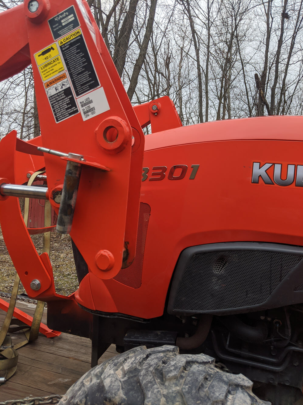

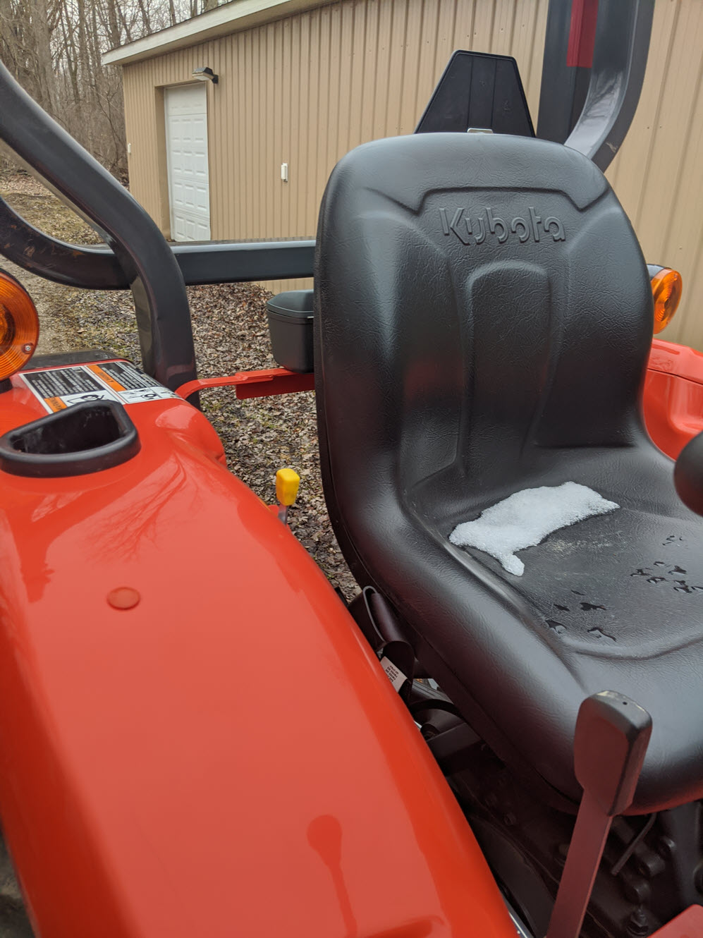

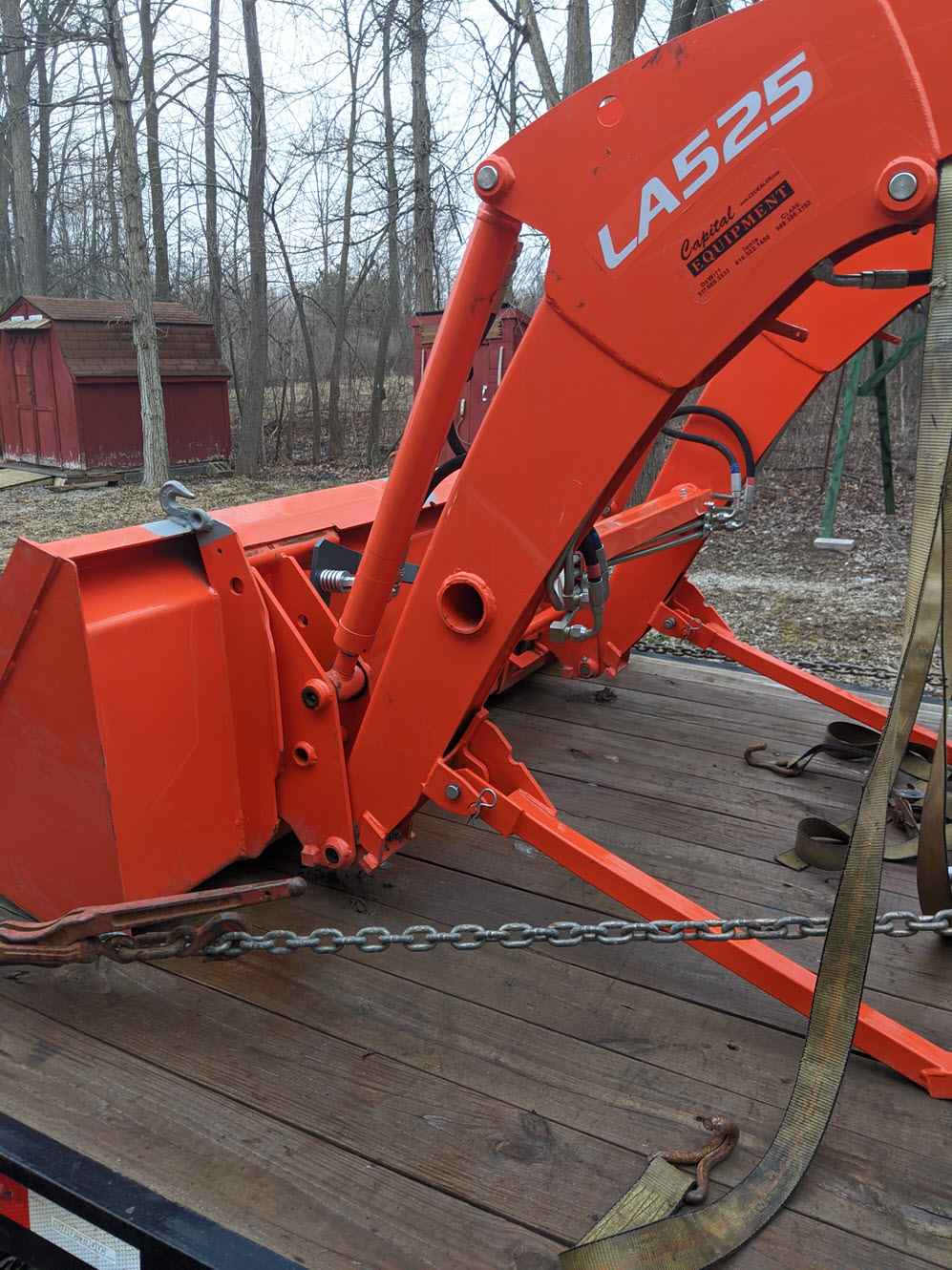

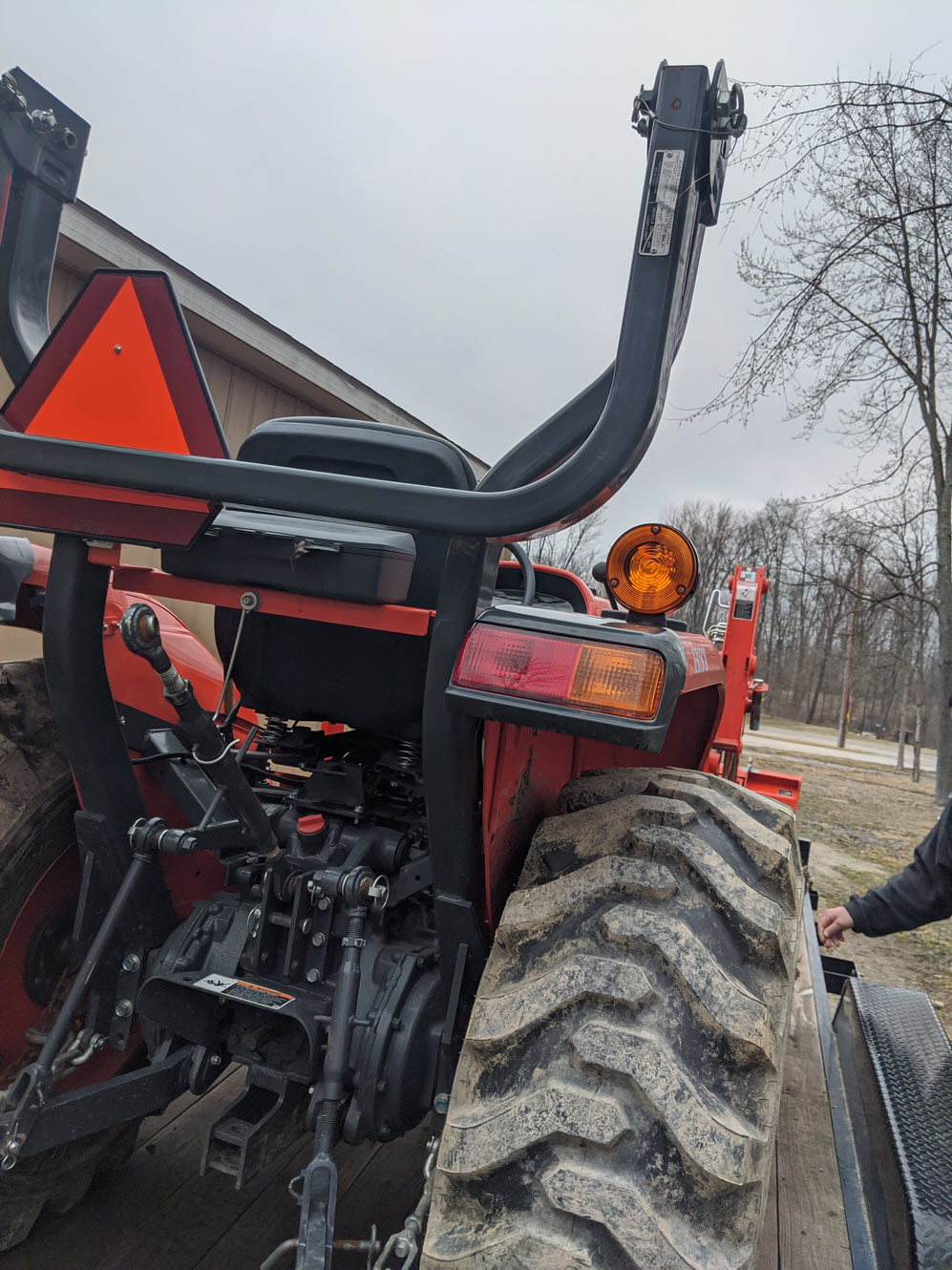

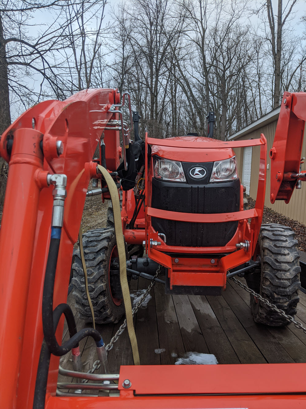

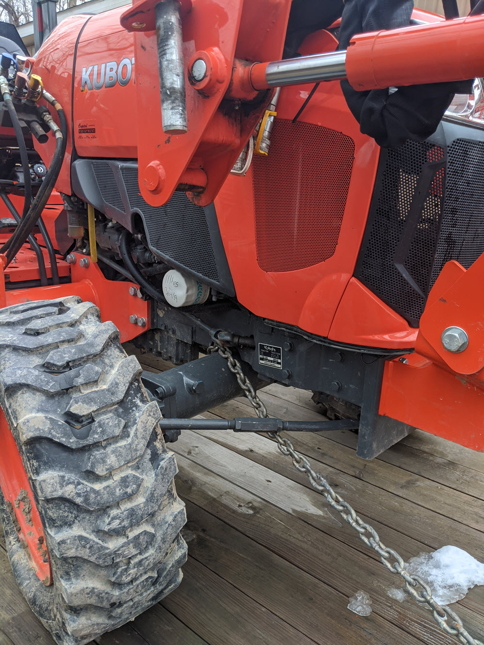

Hiyas,

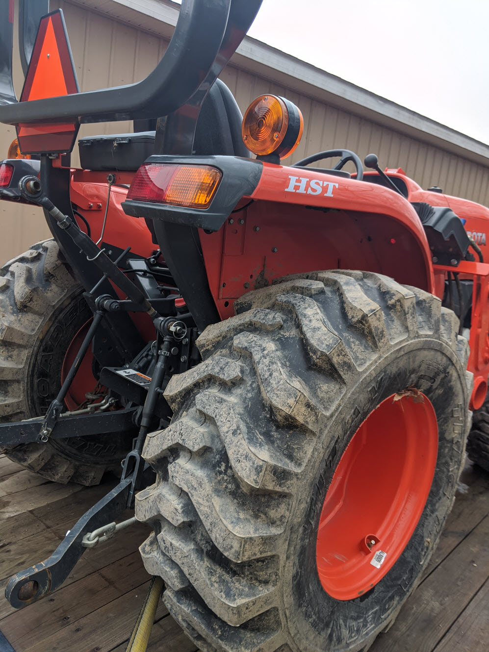

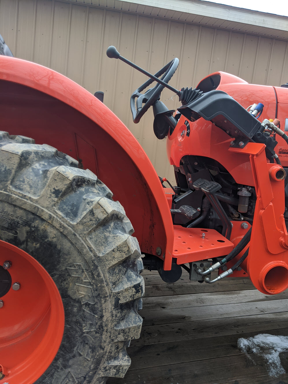

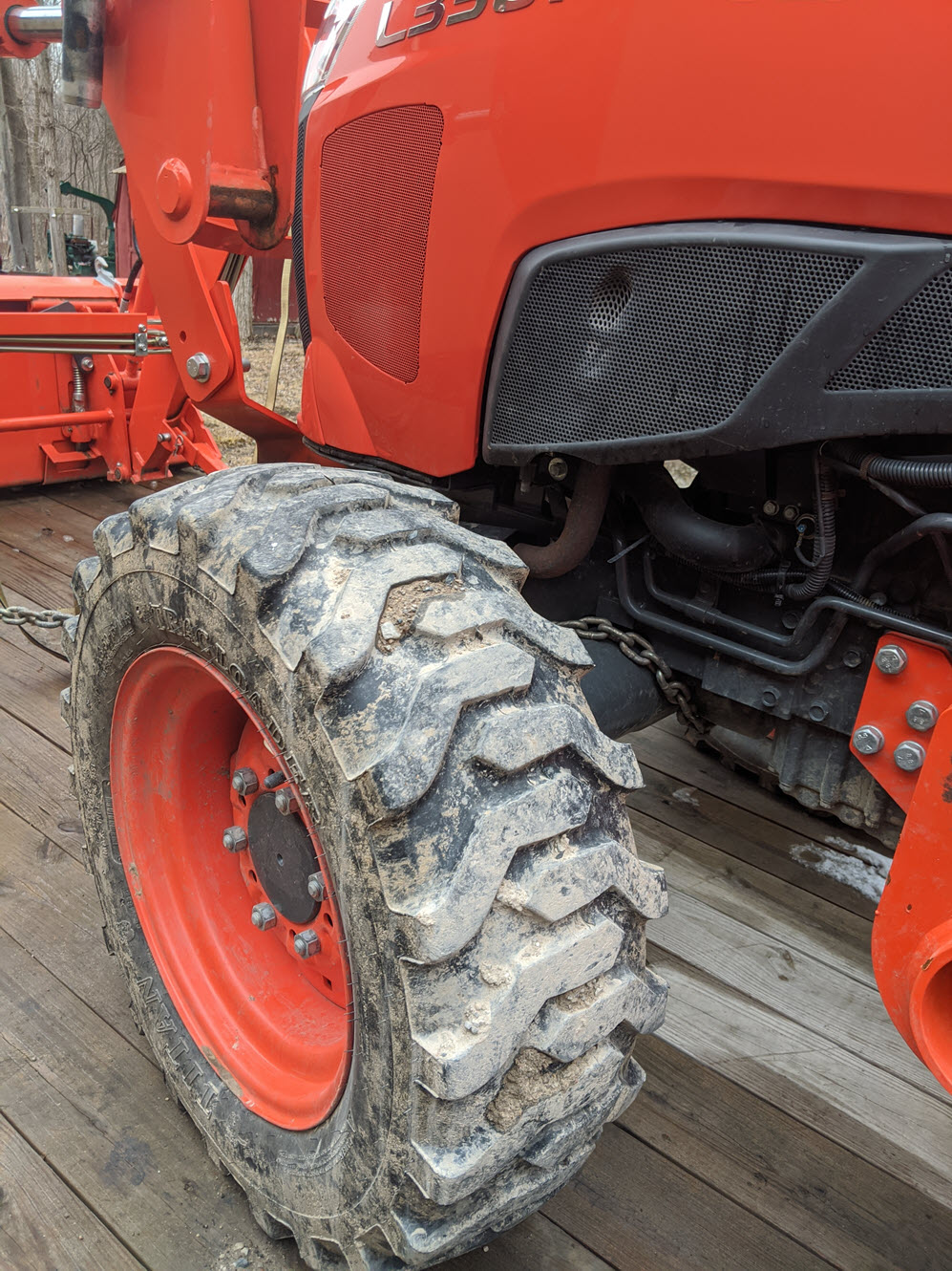

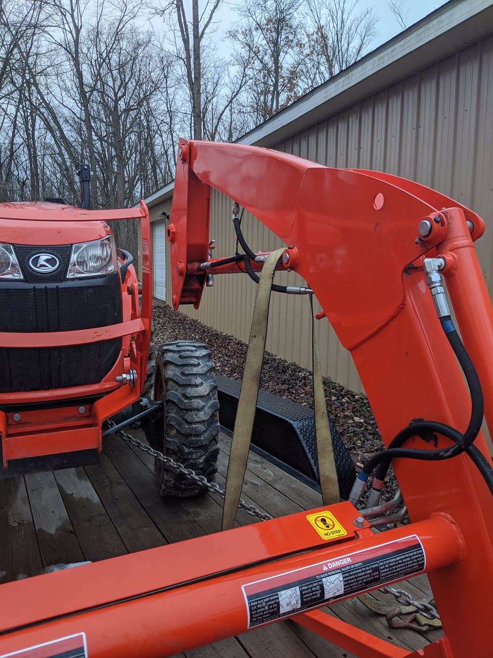

My archery club owns an L3301 (2016 I believe) and a few weeks ago an embankment collapsed under the tractor and it rolled on it's side while running. Repair estimate from the Kubota dealer was nearly as much as buying a new tractor as they indicated it needs a new engine, new steering column, plus labor.
That being the case, we bought a new L3301 on Monday because one of the other local dealers made us an offer we couldn't refuse and frankly, we really like the dealer and the whole experience was great (as a side note)
They also mentioned they might be interested in purchasing the older tractor, and we have a club member, and friend of a club member who is also interested.
Tractor only had 185 hours on, loader is fine, tires.wheels, pretty much everything other than a dent in the left rear fender, the engine and the steering column.
My question is, what is a reasonable price for that as it sits? I did confirm the engine isn't seized.
Jeff
