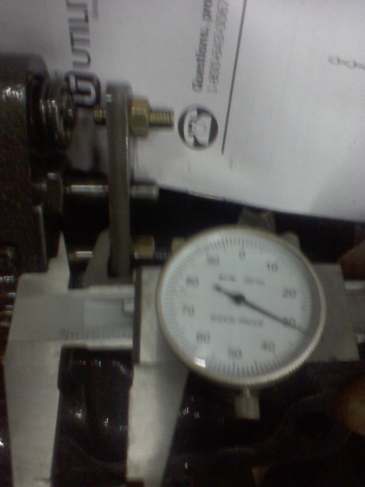

I've been following this thread. Early on you mentioned setting the plate-to-valve distance at 16mm when setting the set screw/poppet valve clearance. Have you continued to use this 16mm setting throughout? I was looking into attempting this on my MX4700 and thought I would start with both measurements in the middle of the ranges given in my WSM (16.15mm and 0.15mm).
It looks like this would have the same effect as decreasing your .006" set screw/poppet clearance as the pictures make it look like that plate is 'fixed' on the spool valve. (increasing the 16mm measurement without changing the set screw increases the set screw/poppet valve clearance measurement.
Is the plate parallel to the front of the valve, i.e. is that 16mm constant across the plate?
My mind twists in knots trying to keep track of everything going on, but I think starting where I was considering starting with the measurements would be in the wrong direction based on your results so far. It appears maybe when your spool valve is in the neutral position the set screw is activating the poppet valve just a bit requiring some pressurized fluid to keep the cylinder extended. My starting measurements would make this even worse, of course assuming everything else was identical.
Are we thinking the same way?

Have you continued to use this 16mm setting throughout? Yes, I haven't varied from 16mm
Is the plate parallel to the front of the valve, i.e. is that 16mm constant across the plate? Yes, the plate remains parallel to the front of the valve body at all times.
It appears maybe when your spool valve is in the neutral position the set screw is activating the poppet valve just a bit requiring some pressurized fluid to keep the cylinder extended. I think this is exactly what's happening. Another clue is that when the RPM is at idle, the load settles very slightly, depending on how heavy it is. When you bring the RPM back up to move, the load rises gently again. I'd probably be ok with that, but the shock when you open and close other valves is unacceptable to me. If the 3 point was the first valve in the system, it wouldn't be an issue. There's really no way to change the plumbing to do that since the valve dumps directly into the sump.
Are we thinking the same way? It's like we're joined at the head..:laughing:
Good luck
It's like thinking you've won the lottery, then noticing the date on the ticket is wrong.. I should have known it was too easy to be fixed like this, otherwise Kubota would have done it already.

I decided to heck with it and tore mine appart just now. If it is supposed to be the specs you listed I am awe-struck....
For starters, that 47.5mm spec you listed on mine came out to 1.970" (50mm)
And then I set the gap to .630 (16mm) and I have a good 1/4" gap where you say should be .004-.008:confused2:
Just wondering if the old valves are the same before I tighten that much and re-assemble:confused: I notice mine appears to have an additional plate where you are measuring your .630". I wonder if mine is supposed to have a different spec as a result???????
pic attached

Well..I didnt feel like waiting, so I set mine and threw it back together.
That plate you see in mine that Seans dont have, I took my .630 measurment BEYOND that and set it to .007"
End result......Same as Seans. Hitch is smooth as butter but the 3PH responds oppositly to the loader controls. And more RPM's make it worse. And this is with a 700lb blade on.
Raise the loader (taking pressure/flow from the "system") and the 3PH drops until the loader valve is released and then the 3PH returns to normal.
Lower the loader (adding pressure/flow back to the "system") and the 3PH raises into the air:confused2:
With the loader raised, and the 700lb blade just barley resting on the ground and 2000RPM, when the loader is lowered....the blade raises about 5":confused2: That is until you stop lower the loader, then the 3PH will settle back down.
