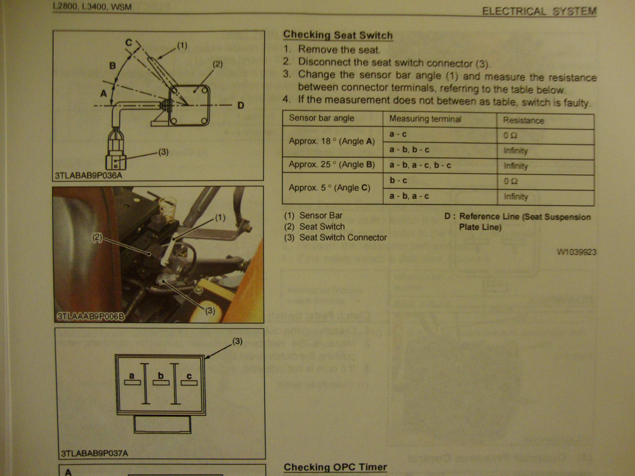

This pic explains the connections for testing the seat switch, your most likely test is the two outside pins. With you sitting in the seat, there should be a continuous circuit between these two pins. When you stand up it should go to an open circuit. As I said, mine tested ok on all the variations, but it's the lowest position of the switch that seems to be the trouble if that's it. I would think if it was the HST pedal switch you'd have trouble starting the tractor and that's not the case. If anything, it's doing what it's supposed to, which is telling the system that "the tractor is about to move, there had better be someone in the seat". It may be slightly out of adjustment if you can inch the tractor ahead without it quitting, but not a lot.

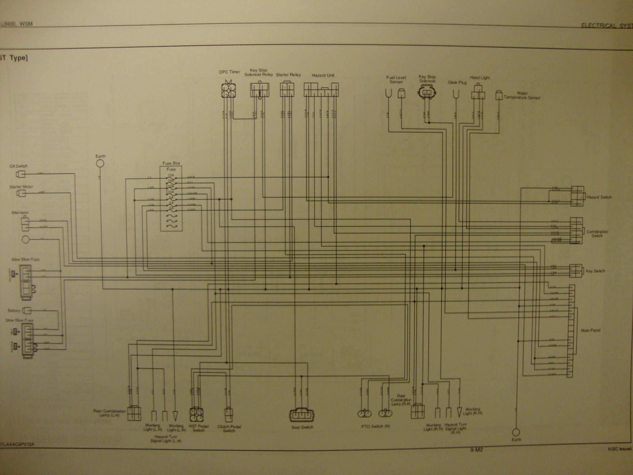

Third pic is an overview of the wiring diagram for the HST model. I'm not great at reading these, but maybe someone else is.

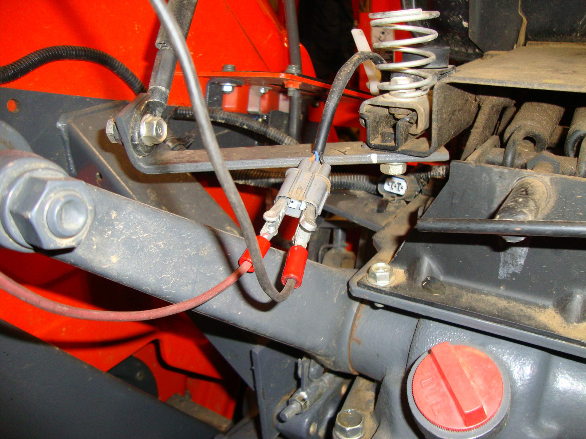

This shows the meter connection to the outer two pins, should be continuity with weight in the seat, open with no one in the seat.

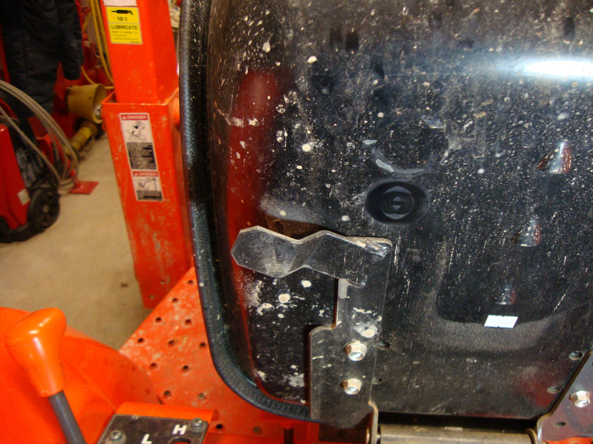

Last pic shows the tab welded to the seat that operates the switch. Mine was slightly bent upwards when I got the tractor, it would cut out (shut off) when I went over a small bump, I had to bend it down a bit, no more than 1/8 of an inch was enough to do the trick. If you suspect this to be a problem, easy way to check is to tape a thin piece of something to the bottom of it and try it, maybe a piece of paint stir stick??
At the end of this, please be sure the switch is working normally, in other words if you're not in the seat and you press the HST pedal, the engine should stop immediately. Same with the PTO being engaged, if your weight is off the seat and the pto is engaged, the engine should stop within 3 seconds unless you flip the seat ahead. I hate troubleshooting this stuff, if it gets fixed "temporarily" and some one gets hurt by it down the road because it was never actually repaired, you always feel a bit of responsibility for what happened. If you feel you're in over your head, a good dealer service dept can probably sort this out pretty quickly.

Today its 31 degrees out. The tractor started but wouldn't move AGAIN. I lifted up the seat and moved the lever on the safety switch. There was some resistance (like maybe some ice to break through) and then it freed up. Got back in the seat and the tractor runs! I know the lever will need to be adjusted (not sure if the nuts loosened or its just moisture freezing), but for now, I can at least plow my driveway and know that I will just need to free up the switch lever if it happens again.
Thanks for all the help, I couldn't have solved the problem without you guys!
   / L3400 HST starts but won't run in cold weather
#47
Thanks for all of your ideas, I could not have figured this out without your help. The problem was the seat safety switch lever. It was stuck and once I freed it up, the tractor ran today. I wish I had a barn to keep the tractor in, but it is outdoors and there has been enough rain, sleet and snow blowing here that gets under the seat. Thanks!

From the looks of the wiring diagram, there's no neutral switch on the HST version of the L3400. Which means you can start it in any range as long as the clutch is depressed. As soon as you depress the HST pedal, it brings the seat switch into the loop, which looks for weight in the seat. Under those conditions, the only position of the seat that won't kill the engine is fully down with an operator in it.
The DT (gear) version of the tractor doesn't have a clutch switch, however the shuttle or range select lever must be in neutral before the starter will engage. In both versions, the PTO must be disengaged to start the engine.
