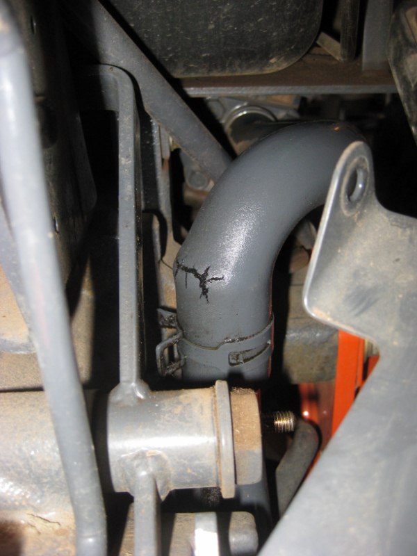

i haven't used my tractor ('05 L3400 - 200hrs) much lately but when i have noticed the loader was jerky and not moving too fast, i figured it needed greasing and it seemed to help a bit but did not fully resolve the problem. today i went to use the tractor and steering is very hard at points and the wheels are jerking a bit on the turn.. hmmm something going on, so what do i do come inside and hop online only to find this thread in less then 2 minutes. go back outside and what do i find?

Thanks for the thread, my L2800 experienced the jerky front end loader while lifting and the hard power steering today, 199 hours.
I looked all over the underside and under the hood. Didn't think to look next to the brake pedal. Sure enough, split on the outside of the bend in the hose.

On my L2800, I had to replace that hydraulic hose twice - at 300 hrs and 700 hrs. The second time I attached the hose to the vertical steel pipe just deep enough to fasten clamp which is 3/4" less than the factory installation. And painted the steel pipe to prevent rusting. This seems to have relieved some tension in the hose that would crack where the steel pipe ends.
The tractor is now just over 1,000 hours and the hose is flexible and shows no sign of cracking. I feel confident that this issue is now resolved, but I will confirm in another 200 hrs.

I posted a thread on 8/19/15, discussing a problem similar to that described by others. I have now inspected my L3400 and found a cracked hydraulic pump intake hose just like many described. The split is about 1" above the connection to the steel supply pipe. I like your suggestion and plan to install a new hose the same way you did. This is a really dumb design on Kubota's part and ignored could result in damage to the hydraulic pump that costs just shy of $1,000. BTW, replacing the pump was my dealer's suggested fix. Obviously, this problem has existed on multiple Kubota models for some time and any dealer should have received a Kubota tech bulletin about this, assuming Kubota recognizes and acknowledges the problem. I would also expect a redesigned part to keep this from happening. FYI this is the soft hose leading from the metal pipe to the hydraulic pump and the part # is TC220-33332.

It is... the new replacement hoses don't crack like the old original hoses. It's just on the older models, L2800 and 3400, as far as I can remember...
