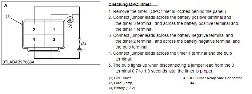

I understand that this is an older thread - but we have a L4310 with a similar problem.
Does an L4310 even have an OPC timer? If so who does it interface with the fuel shot-off solenoid?
How do you test an OPC Timer?
Photos / diagrams appreciated...

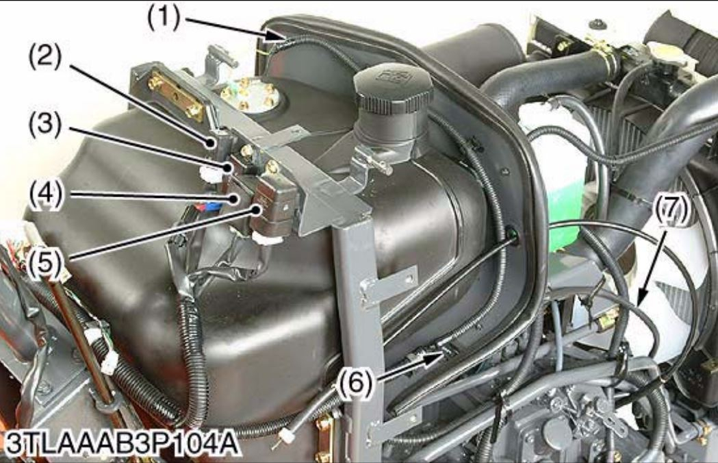

Realize this is an old thread, but just troubleshooted my OPC timer and figured I'd share this.
The OPC is behind the instrument cluster. A 10mm bolt holds it in place. It's #3 in the photo.
Here is the replacement for my L2800:

I know this is an old thread, but, HOW did you bypass the OPC switch? does anyone know how to test the OPC switch? They are $130 now, hate to buy one and have that not be the problem.
I found one thread here with a description of how to test it, but there is either something wrong with the description, OR perhaps I don't understand the explanation.
