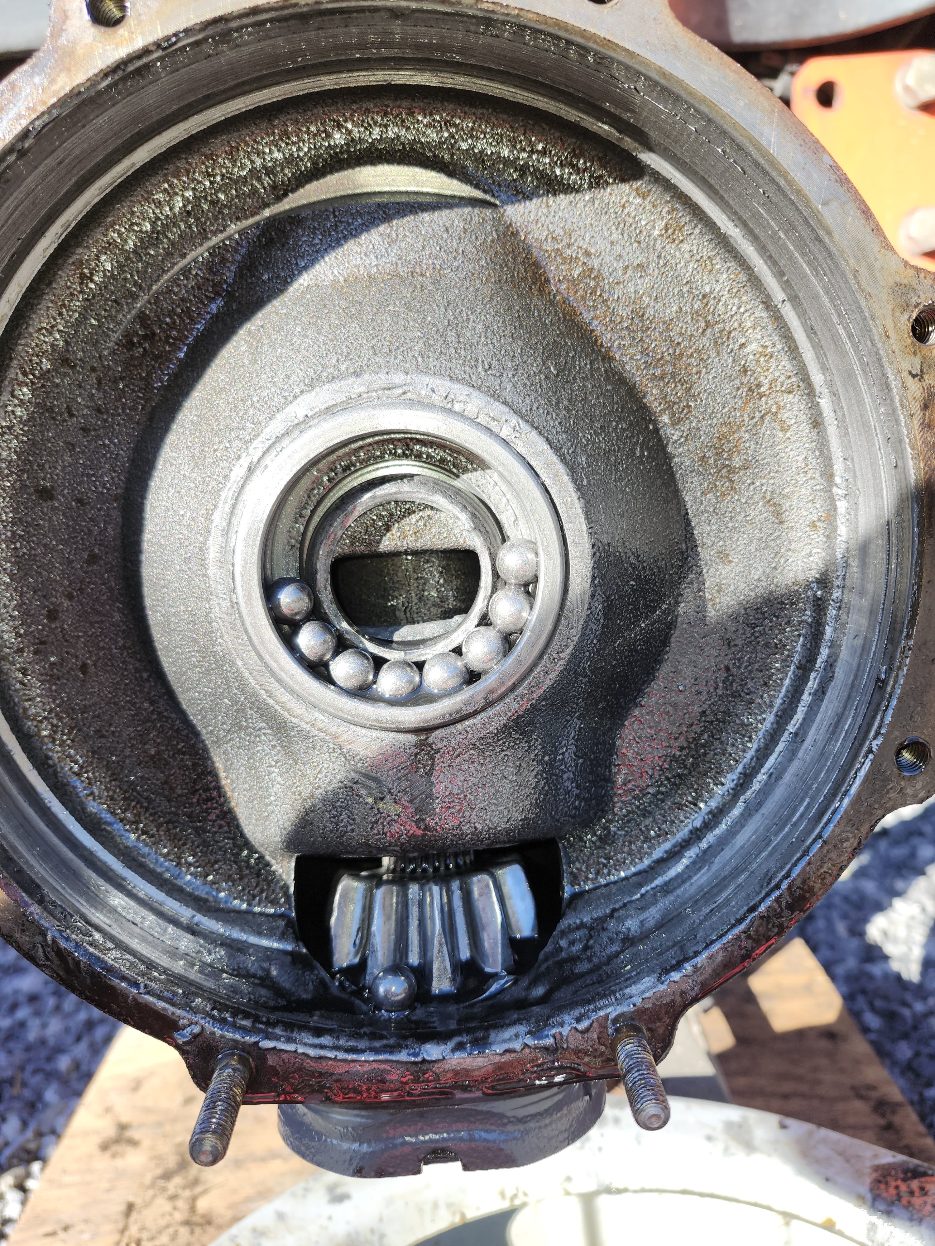

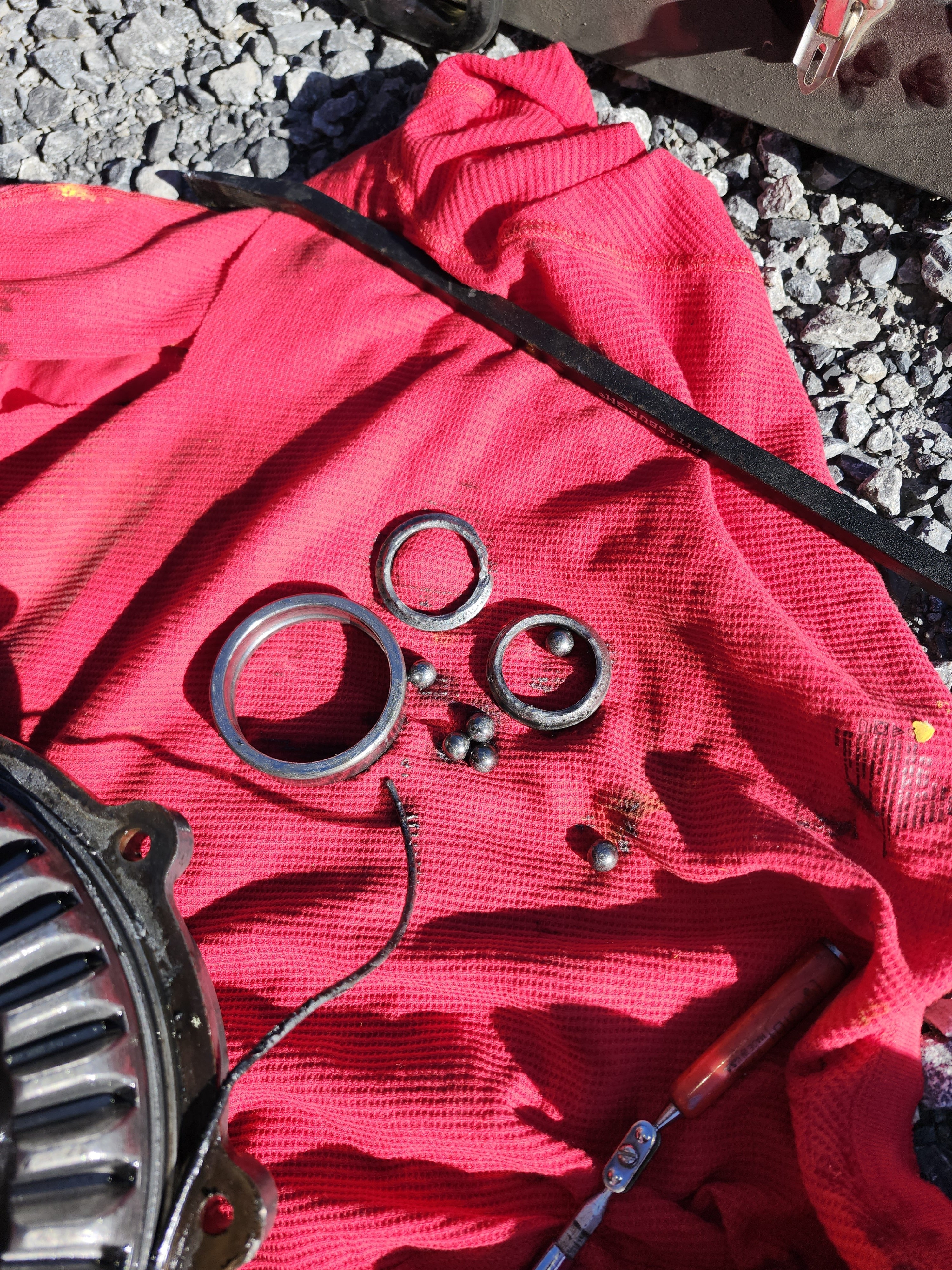

Just writing about a friends experience with his 2009ish L3540. 1900 hours.
It has the LA724 FEL... He has had issues with front axle bearing disintergrating. He is way up on maintenance, he uses all Kubota fluids yet he has had 3 failures with front axle bearings falling apart. Twice, a little fluid leak had us pulling the front axles of only to find balls in the bearing missing and scored up axles. The third time, the tire dropped without any warning. The inner bearing disintergrated causing the axle/hub to crack the housings. Is anyone having this issue? Does anyone drain the Case annually to let fresh fluid drain down from the axle tube? Whenever this happens, its not just Seals and bearings that have to be replaced. Its expensive parts that have been scored up before any signs of bearing failure. Not ho mention the disassembly time to thoroughly clean up the pulverized parts.

Bummer!
Is he operating with heavy loads in that 724 loader?
And perhaps with no or insufficient counter weight on the 3 point hitch to remove weight from the front axle?
The LA724 is the bigger loader for that tractor,and overloading the front axle sounds real possible.

Heavy loads...yes. That would be my guess. He does move stone, dirt and compost around with only weighted tires. So, no counterbalance on rear wheels. But, our thinking is that if Kubota puts that FEL on that tractor....the tractor, as a stand alone, should be able to handle it.
Last Fall we did make a counterbalance. About 600lbs. Hopefully the future will not see more front end issues.
Bearings are cheap (now that we got the generic part numbers) but the ruined casting and axle parts hurt the wallet when you gotta pay Kubota prices. At least, between the two of us, we can do the work ourselves.

Keep seeing this on multiple brands, It is usually the same failure mode, and most times it seems to be from the ball bearing cages failing from the load on each ball bearing, once the cage fractures and the balls can migrate around the race it gets ugly quick.
They either need to upsize the bearing which will give more surface area for the larger ball bearings and also a larger stronger cage. Maybe if the ball bearing manufacturers offered a super cage design/ material some of this could be avoided. Or switch like some on this site have suggested a needle roller bearing design instead.
Ball bearings once set loose eat ring and pinions for lunch. This should not be as common as it is because many do keep a good sized load on the 3 point to lower the front axle loading and keep good clean oil in their front axles.

Counterbalance is king. I built a 1000# one for mine. The first wrecked housing made me a believer
Ahhhhh, ive been asking this question since we did the first one on his tractor. Finally someone that had it happen and verifies that counter weight is the way to go. Thanks. What model tractor?
His 600lb-ish one, he says, is borderline for snow plowing. Makes the front, almost too light for turning. Ill convince him to use it in the warm weather when lifting heavy stuff.
