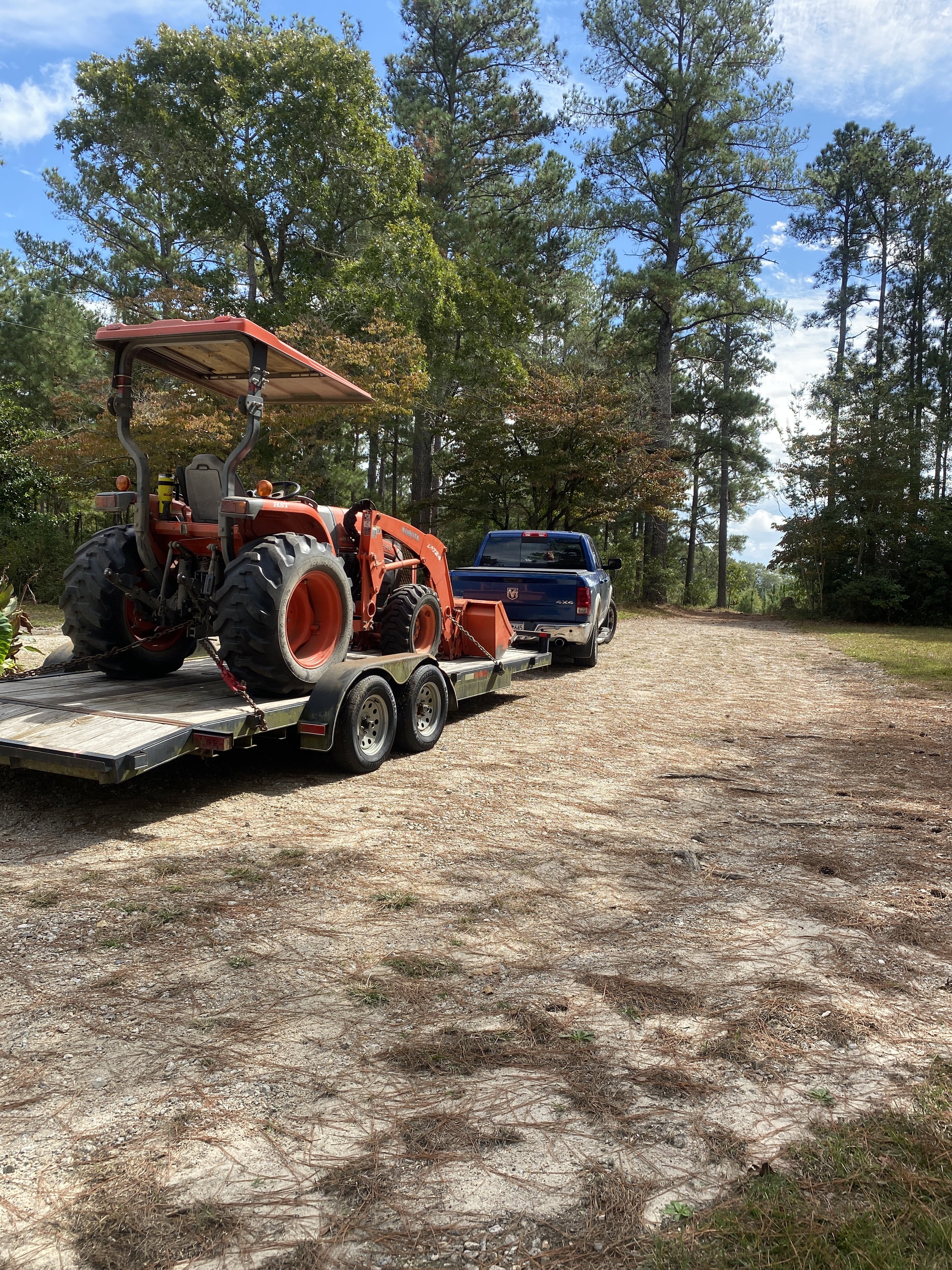

So I finally decided to take it to the dealer, with a bad seal and the loss of power I figured I’d just let them play with it. IMG_5422.jpeg
