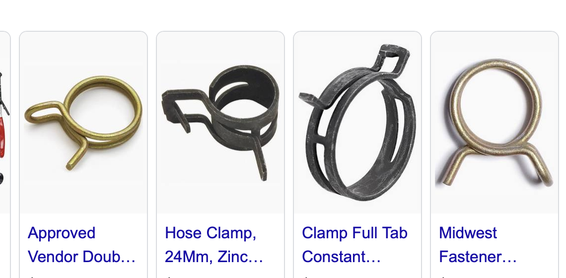

BTW, most rubberish fuel lines have an ID compatible with soft copper tubing ...if you ever need to splice rubber fuel lines together. I keep a few feet of soft copper tubing just for that purpose along with the right size & type of hose clamps.
It is best to use a hose clamp that will continue to put compression on the hose as the rubber compresses. Worm gear type hose clamps don't do that.
I admit to being an oddball mechanic - always been more interested in why something went wrong than in what it takes to fix it.
