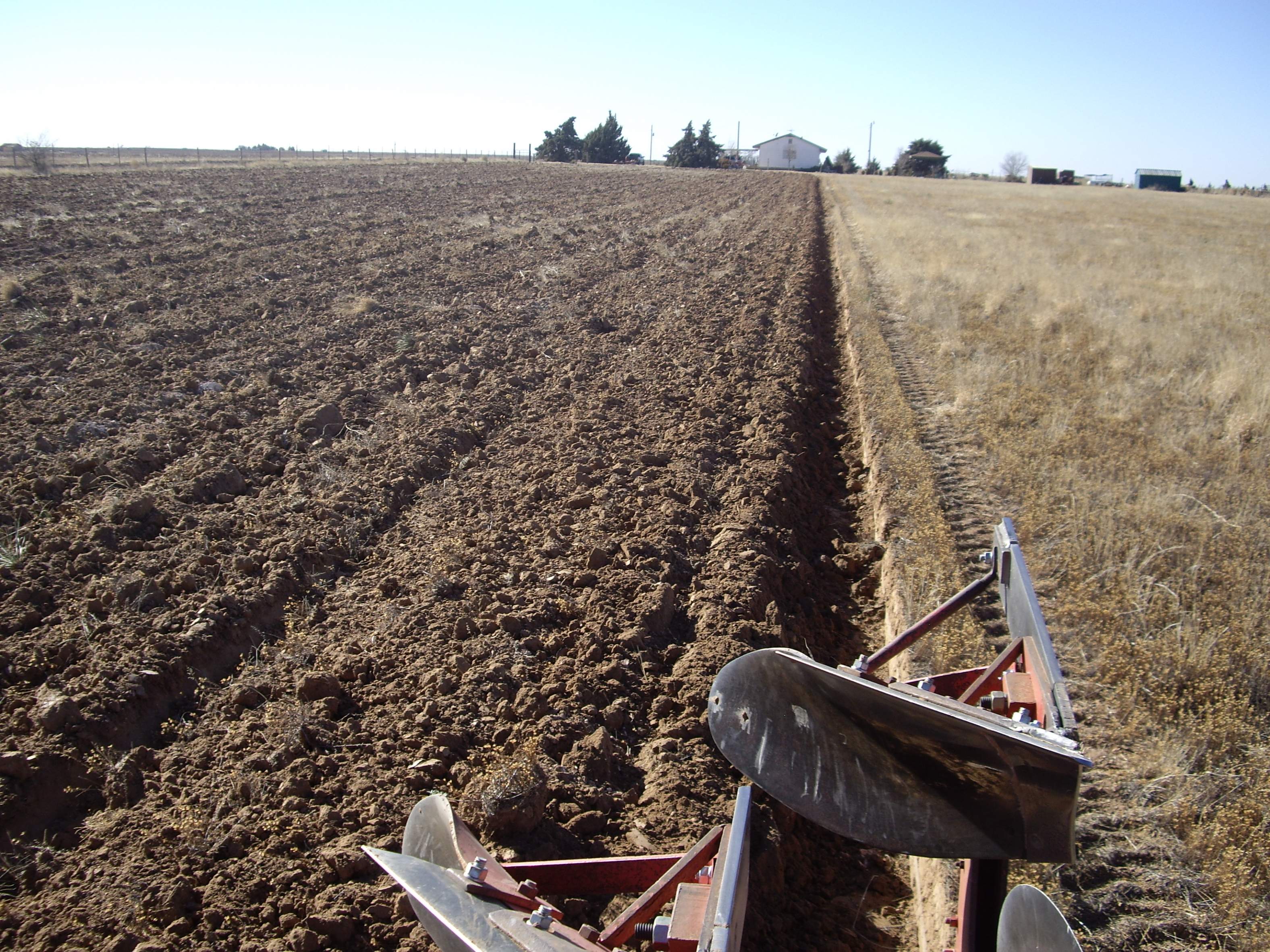

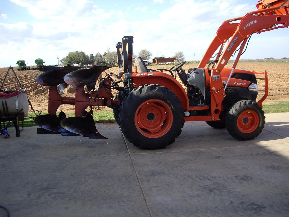

Something like this should do the job. Ken Sweet

LD1, if you think I could get away with only discing the clay ground I'd certainly like to not have to purchase a plow. What should I be looking for in a disc to obtain that a L3700 could pull. Mind you I know nothing about them, but am trying to learn. These acres will be bush-hogged and cleared of any small trees before discing. They've gone back to nature these past ten years. Lots of weeds and bramblebushes. Thanks for any advice. Thanks Ken for the pics.

You won't be happy disking as the trees, brambles, etc. will come back up. If you want to get rid of them, you need to plow and turn the roots up. Your tractor can easily handle a two bottom plow with 14" moldboards.

What he said. The plow manufacturer doesn't matter. Any 2 bottom plow will work, even one of the old pull type that you would hook to the drawbar. A 3-point plow will let you make shorter turns, which is important on only 4 acres.
After you plow, you will need to disc and harrow to make a seed bed. The plow leaves a very rough surface. It only turns the dirt over, it doesn't break up the clods. You will get the best results with moderate moisture in the soil, just enough to moisten the clods without making the ground muddy.
